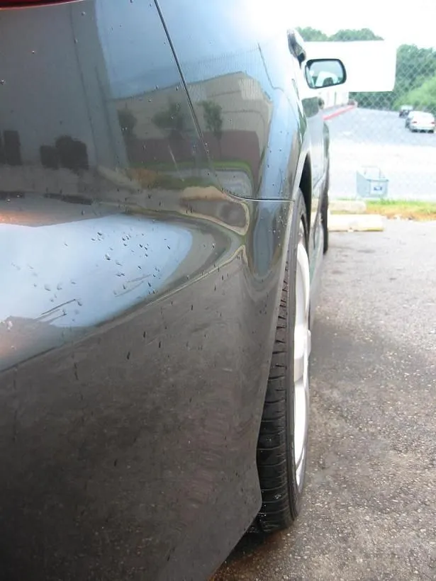

here you go crossbow what do you think??
i got the fenders rolled ~ even with full tank of gas
i dont rub anymore (driving very carefully avoiding ANY holes or bumps)
im pretty sure itll rub once i lower it...
it looks pretty flush in persons eye but digital doesnt lieee..
rear wheels looks like they got some negative camber..
