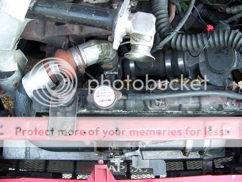

MBC, 10 psi, no spike at all.
massive FBE intercooler, custom welded and fitted.
Turbo XS bypass
Trust intercooler tubing, also custom fab.
2.5" mandrel bent exhaust w/ magnflow muffler.

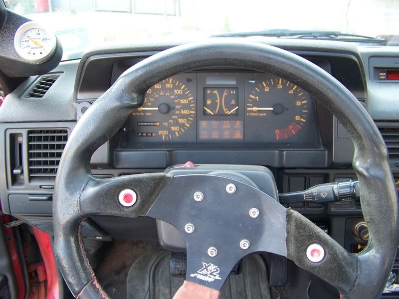

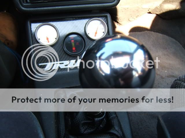

custom carbon fiber gauge cluster, housing a/f, oil temp and water temp
a-pillar boost gauge
x2 racing steering wheel
analog metric gauge cluster, very rare.
gaywad shift knob

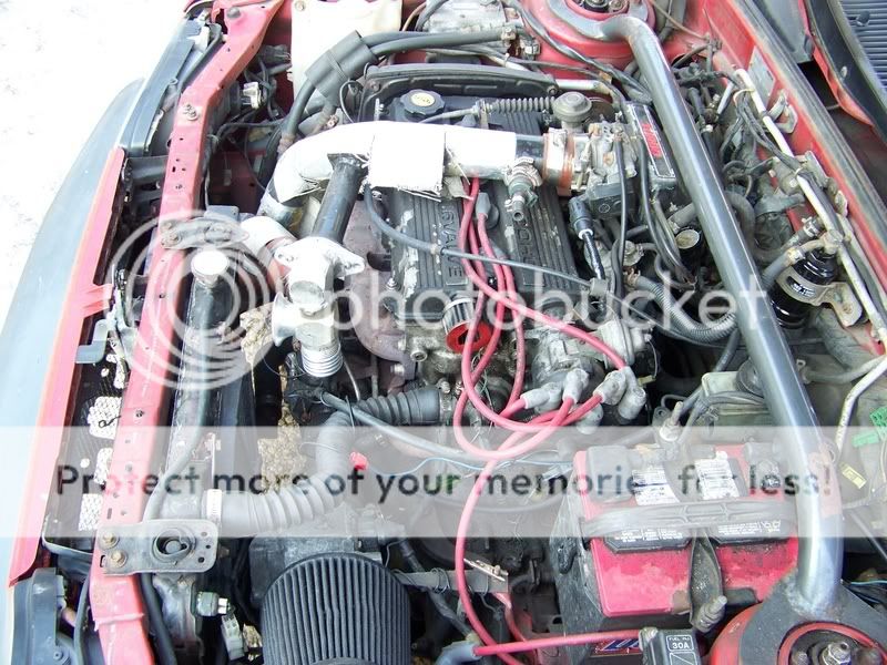

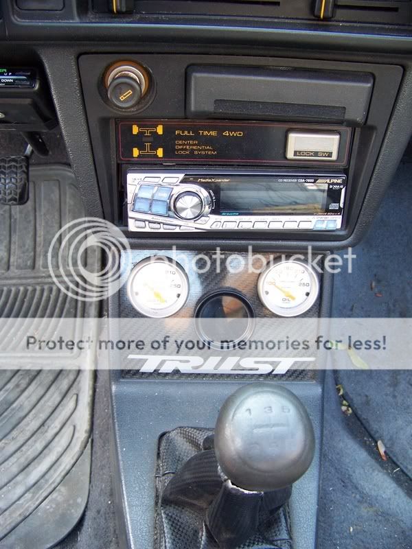

engine:
Turbo XS bypass
i have a mazdaspeed 2.5" mandrel bent, its not as responsive with it, though. the cool factor is through the roof, however.
Accel coil and wires for the mcdonalds approach.
Ngk v-power plugs, gapped to manufacturer's group-a spec.
Walbro 255lph Fuel pump, stock tank transfer pump.
