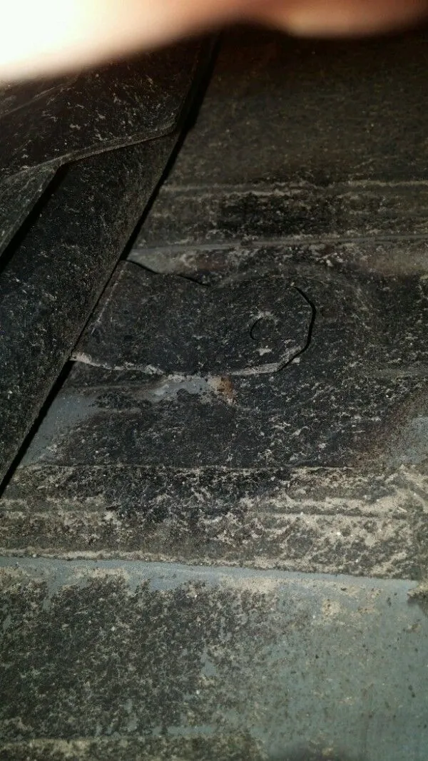

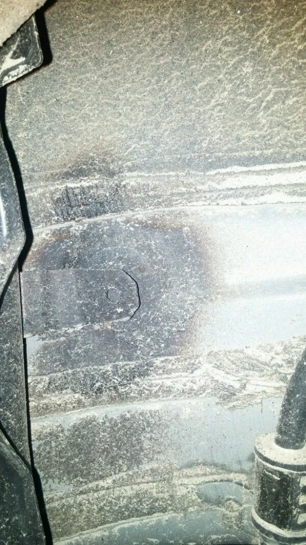

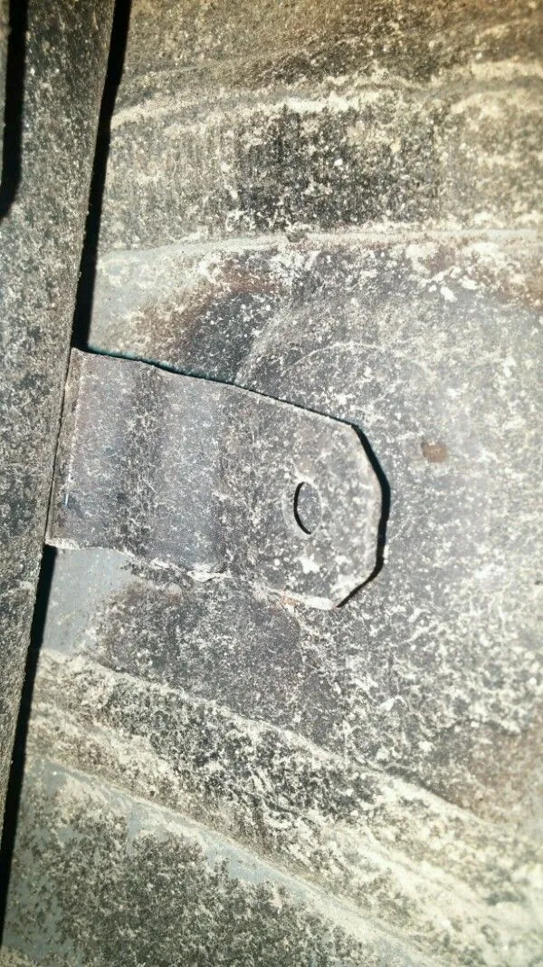

Today I changed out my winter tires/wheels which allowed me a good look directly at the area. I'm not really sure how this bolt could cause the problem. The bolt is about 2" behind the filler pipe and bolted to the body of the car. Unless the bolt is attached to a part of the body that is supposed to crumple forward in a rear crash. There is another bolt about 2" in front of the pipe that looks like it could be a problem in a rear crash if the pipe is shoved forward into it. In fact that front and rear bolt seem to be attached to the same "strap" around the filler pipe.
As to the fix, it appears that they removed the rear bolt, covered the hole with a round sticker and then sprayed the area with undercoating. There is now a gap behind the strap because the bolt pulled it into the frame. It's not floppy loose but I can see it vibrating during normal use. Ideally the wheel should be removed so the spray can get all around but I don't think rust will be an issue as it appears the sticker covers the area where the strap touched the frame and spray covers the sticker if they do correctly.
Pictures attached.

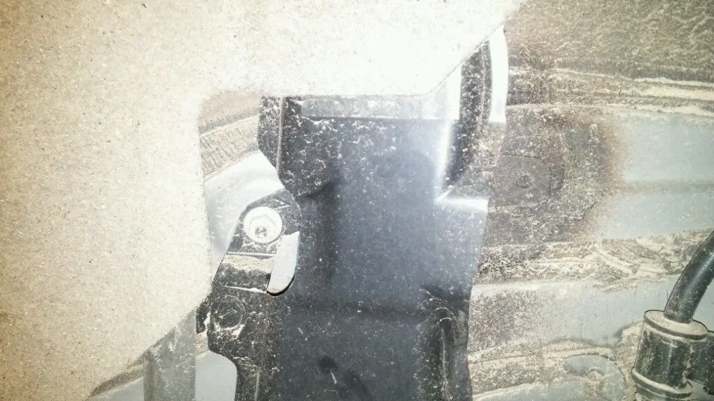

I fixed orientation of the picture I took. Left rear shock is on left.
Appears to be above #11 in schematic which seems to be the same among all model years I have seen.
How did you get this shot without removing anything, at least the whole plastic wheel well liner? The filler pipe seems to hide behind the liner. Did I look at the wrong place although I used the left-rear shock absorber as the reference point? Of course the bolt in question could never be found during my failed attempt.
You need to come around more from the back left of vehicle looking under the bumper near ground level. The filler pipe is in front of the plastic wheel liner. I'll try to get a better shot later today. It is around the back side of the shock.
That lit up piece on the right is the spring.
