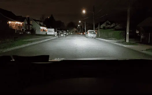

My first CX-5 was a 2013 and I've changed the OEM low beams light bulbs. I've had these GTR Lighting H11 and these Morimoto H11. These options may seem to be expensive but they are far better than the cheaper options you may find on amazon. On the TRS website it says they are fog lights but I can tell you I've used them for low beams and they worked perfect because the low beam light is a projector type. Brighter than the OEM halogen bulbs. I never went back for halogen once I had these installed.
For DRL I do not recommend led bulbs because the DRL/High beam is a reflector type and you will end up blinding everybody with your led DRLs. I've tried led on the DRL/High beam light and I did not like it. At night everything was super bright right in front but no depth. I realised I could see further with the halogen bulbs for high beam light.

You should be careful when choosing LED headlight bulbs. There are a lot of poor-quality LED bulbs on the market now, their beam patterns are so bad that they keep flashing the oncoming vehicles. Go with some trusty brand bulbs is important. For me I installed these AUXITO H11 led bulbs on my headlights right now, the lights are brighter, whiter and have the correct beam pattern. For other parts, I recommend not doing too many changes for a new car.
