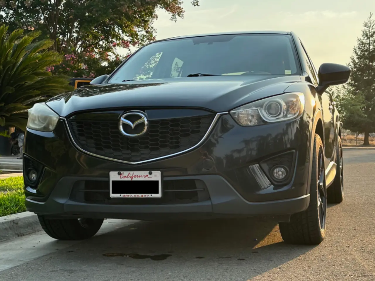

Greetings M247 members. Joined the forum about a year ago after purchasing the aforementioned 2013 CX-5 Grand Touring AWD (Black Mica), and have been basically lurking/researching since. Have been tremendously pleased with this vehicle, in spite of a couple of necessary repairs over the past year. No plans for any serious modification, but there are a few upgrades I have made, and some others I have planned or am considering for some future point.
Upgrades & Additions To Date

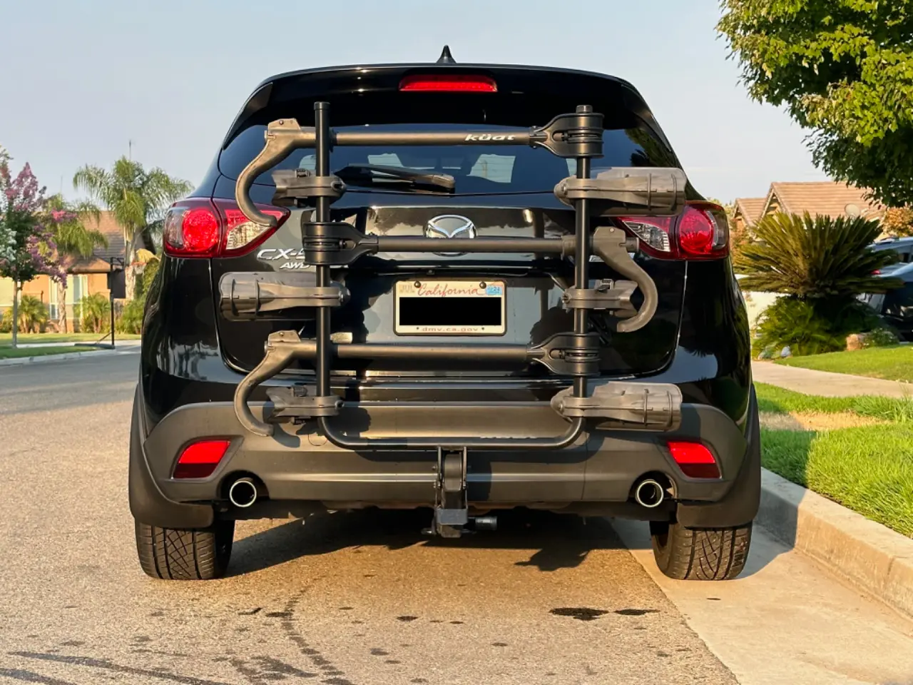

  • CURT 13315 2" Class 3 Receiver Hitch (for Küat Transfer v.2 3-Bike Rack)
  • Mazda OEM Splash Guards (to protect bikes)

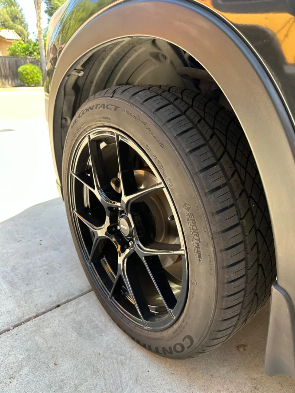

  • Konig Diverge Wheels - 20 x 8.5, 32mm offset (Black)
  • Continental Extreme Contact DWS06 Plus - 245/45 ZR 20
Planned or Considering for Future
  • H & R 28875-1 Sport Springs - -1.25" F / -1.75" R (On-hand but uninstalled as of 8/7/2024)
  • Mazda OEM Roof Rails / Crossbars
  • Blackout Emblems
  • Repaint or Vinyl Wrap (Clearcoat failing on horizontal surfaces)
  • Intake?
  • Exhaust?

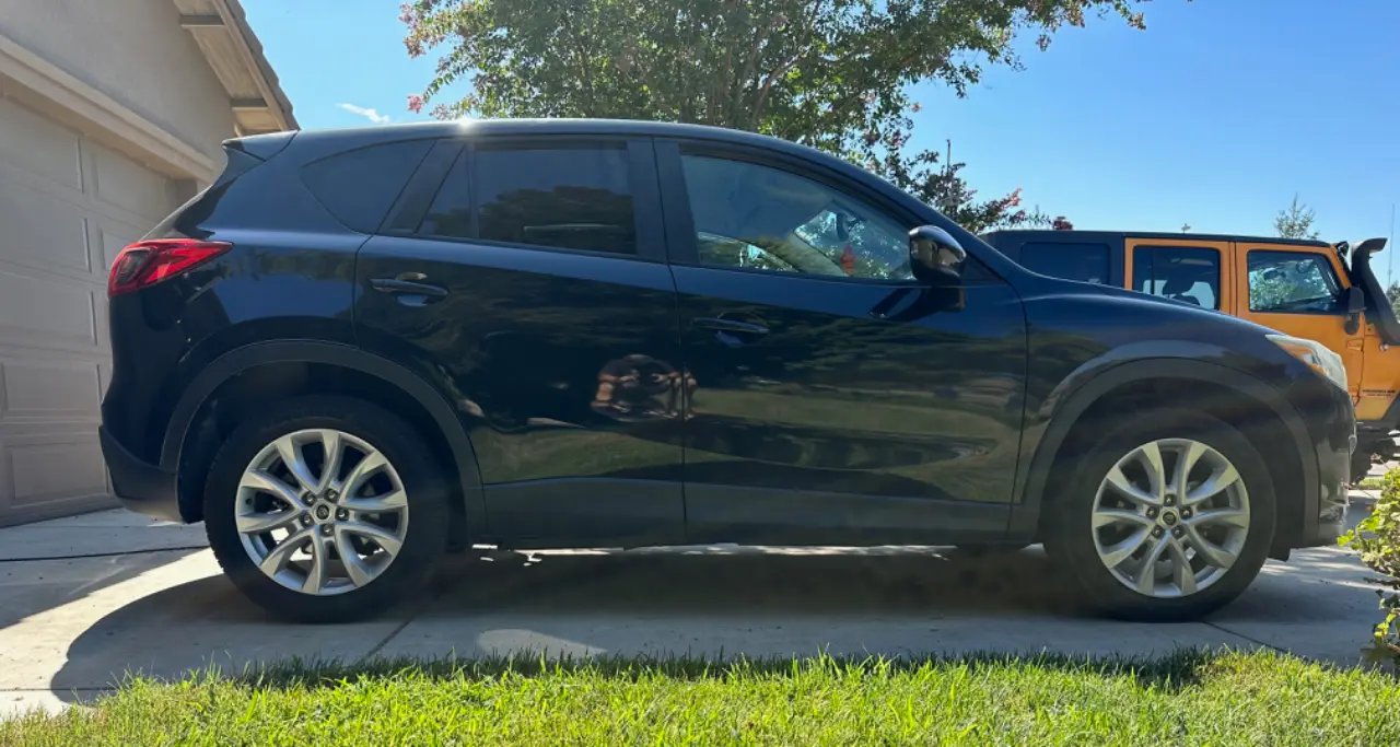

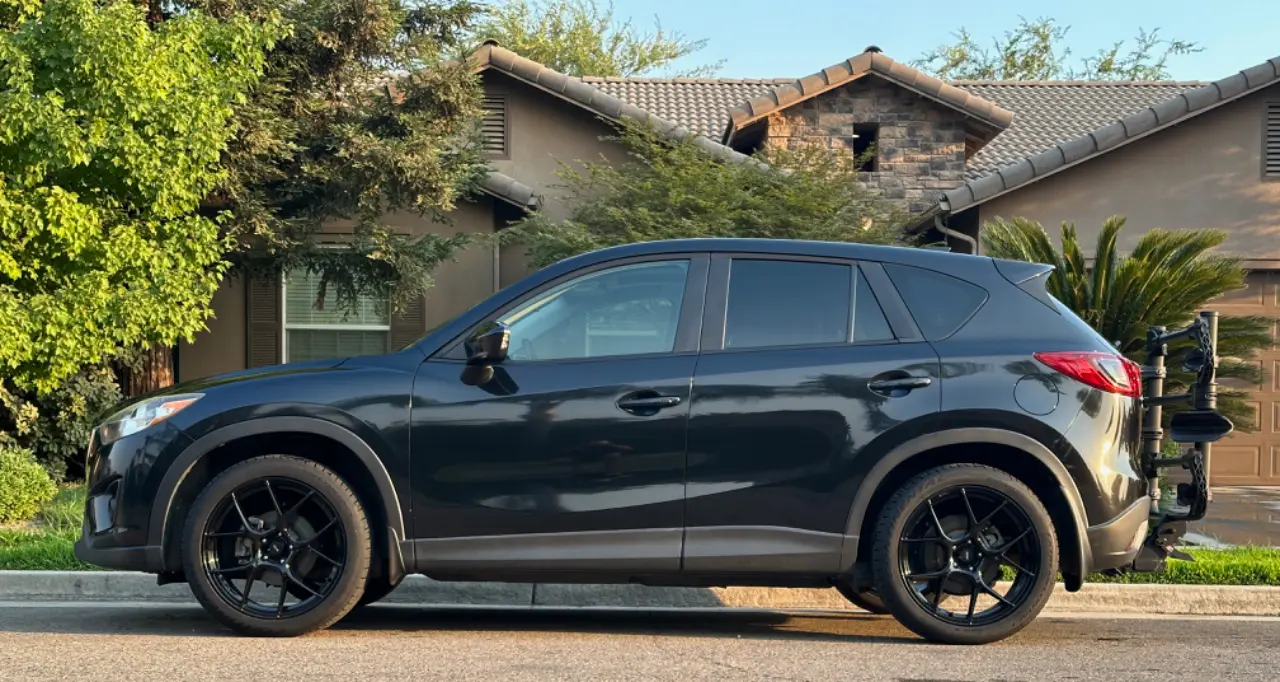

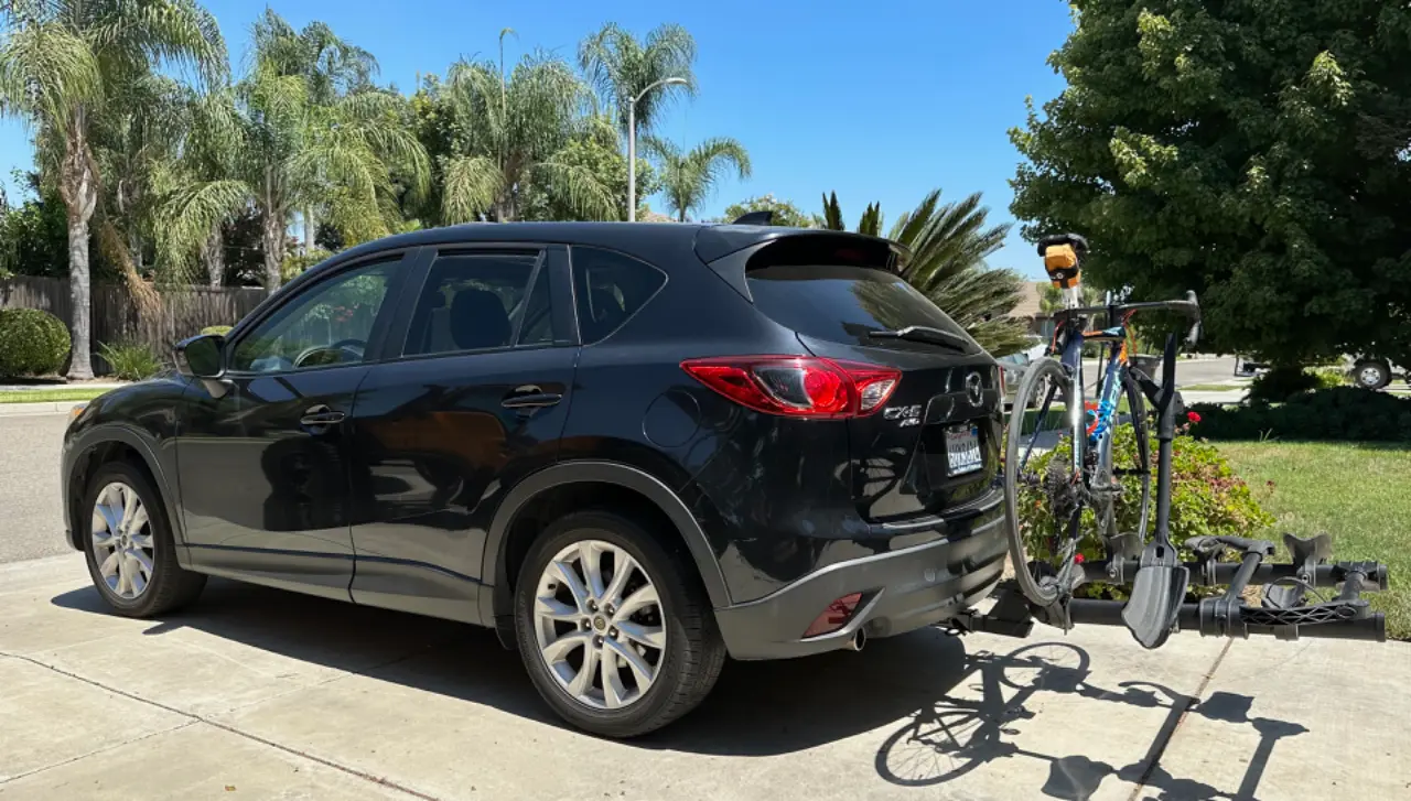

Before
After
Thanks for reading, and for all the valuable information gathered from this forum!

looks great! those wheels really change the whole look of the car.
Thanks cornerking! I agree about the transformation. I felt it turned out even better than I had hoped! Now to get the emblems blacked out ... :)
