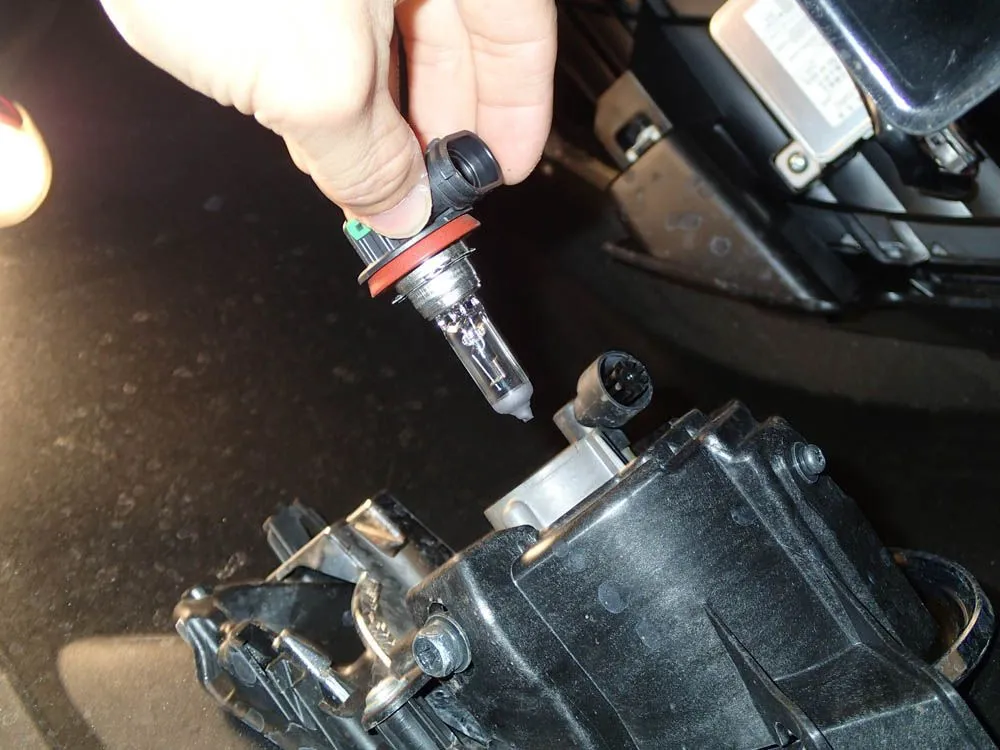

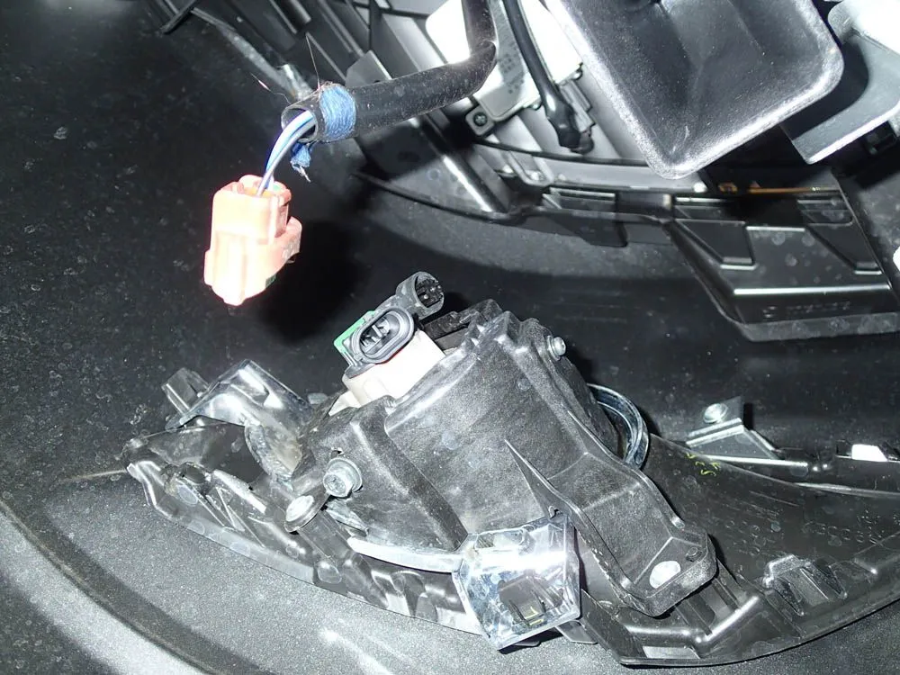

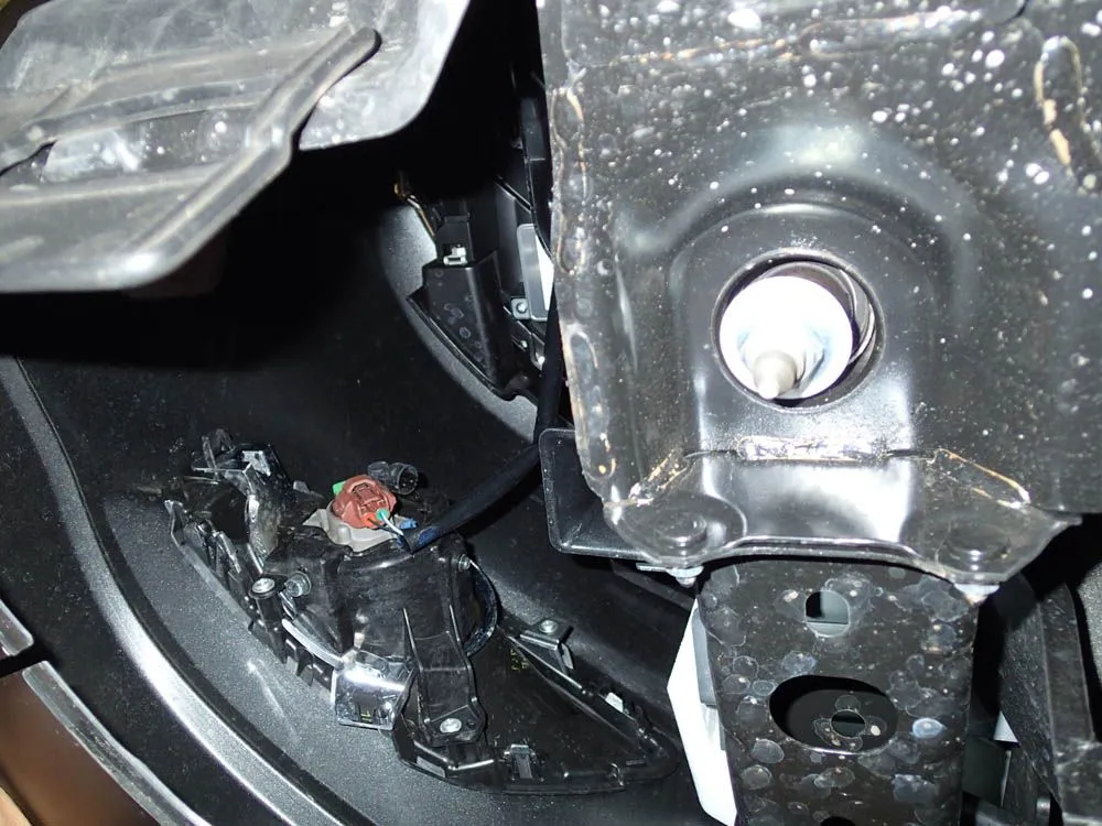

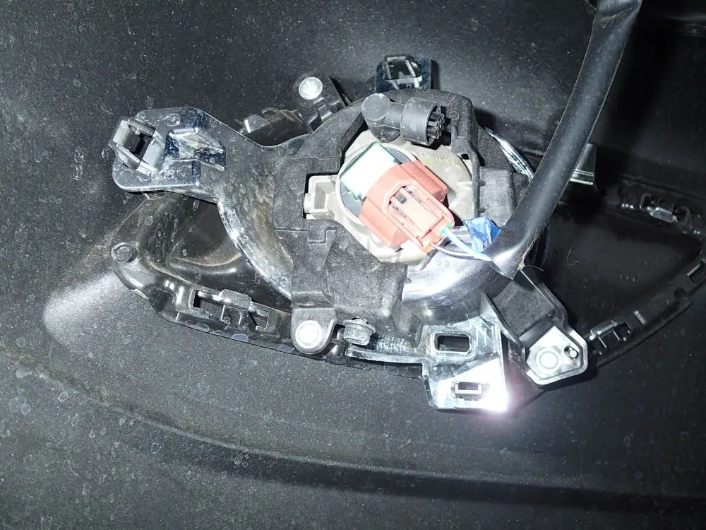

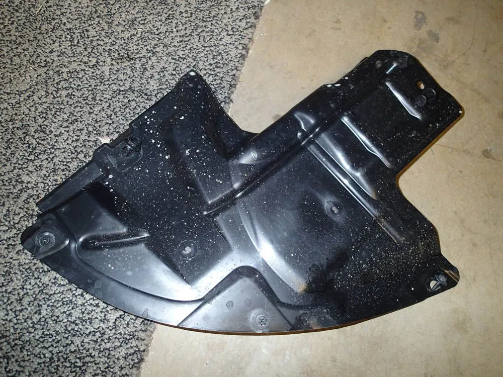

I'll be ordering the kit soon. I did remove the mudguard right under the fog light just to check it out, and it was pretty easy. There sure is a lot of room in that space.
Not sure where would be the best place to stick the ballast though. I did see what looked like water spots on the inside walls coming down just under the headlights. Should I just stick it right under the fog light bulb housing?
I took pics just for reference if anyone wanted to see what it looked like in there.

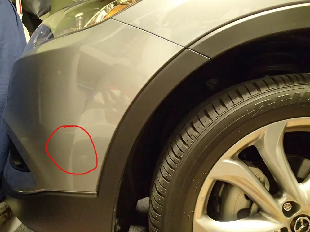

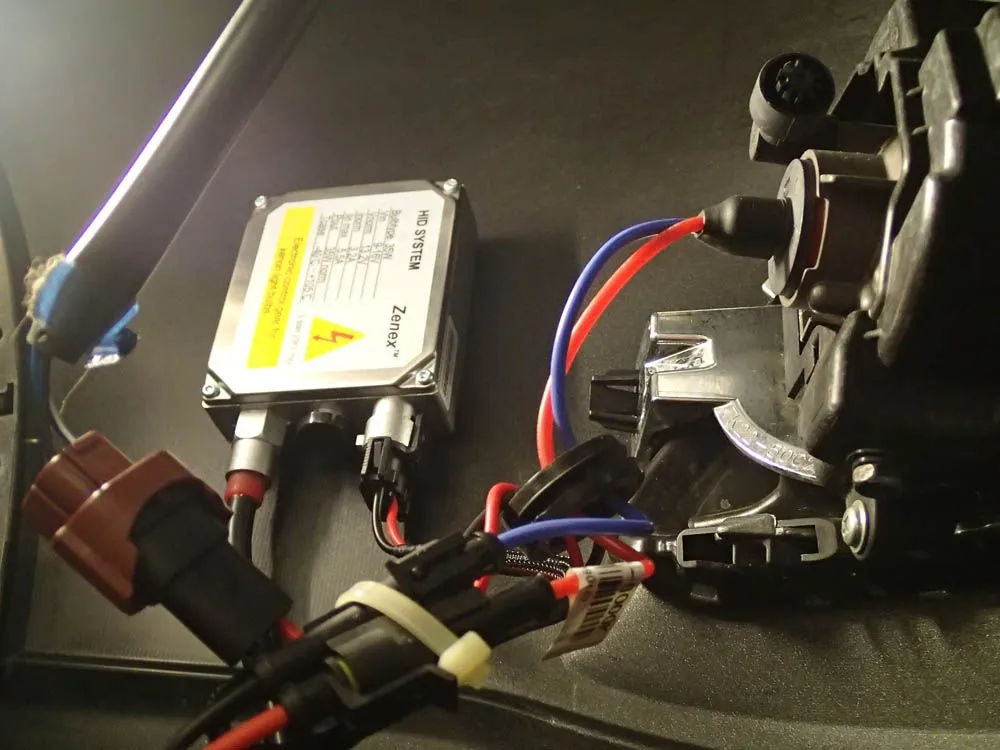

I mounted the ballast to the side area beside the front assembly, the inside area of the side moulding. The double sticky tape worked just fine. Just make sure the surface is clean.
Its a really easy install proccess - should only take 15 minutes, and the reults are great!

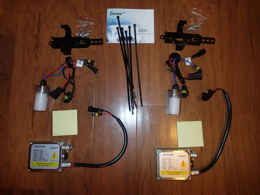

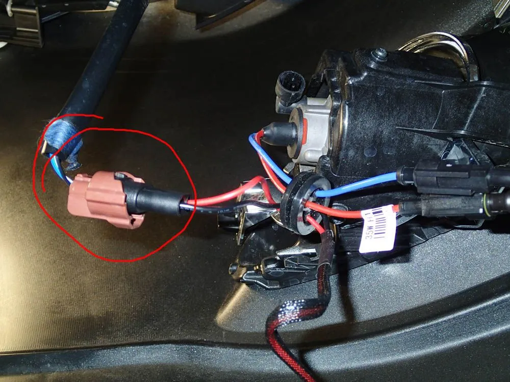

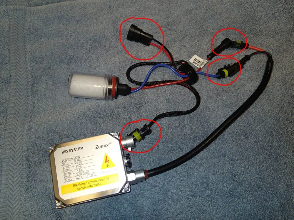

Early Christmas for me. The kit came in today. Much earlier than expected. It really does take about 15 or 20 minutes to install. But it took me about 2 hours since I like to work slow and get everything right the first time. The instruction manual leaves a lot to be desired. Luckily it really is all plug and play.

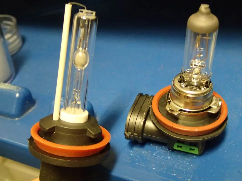

It was a challenge getting the new bulb secured into the socket since I didn't want to scratch or break the bulb getting it in. Turns out I was being way to gentle and needed to push it harder into the socket so I could turn it in the socket to lock it in. The plastic tabs on the new bulb make it a little harder to get into the socket compared to the metal tabs on the old bulb.
The other issue was that both lights didn't work the first time I got it all installed and plugged in. Took me about 20 minutes to figure out that I had the power harness plugged in the wrong way. I thought it fit in only one way. Turns out it fits in both ways, so I just had to flip the harness.
I didn't attach the HID Kit Computer Warning Canceller & Anti Flicker since it's being shipped separately and I didn't get it yet. But I suppose I won't need it since the lights seem to work fine.

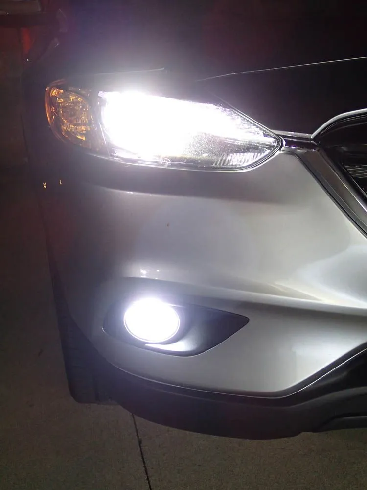

The location that I stuck the ballast on was just behind the front fender. The 6000K is a little bluer than I expected, but I still like it.

I got 6000's and it was a pretty close match to factory HIDs.

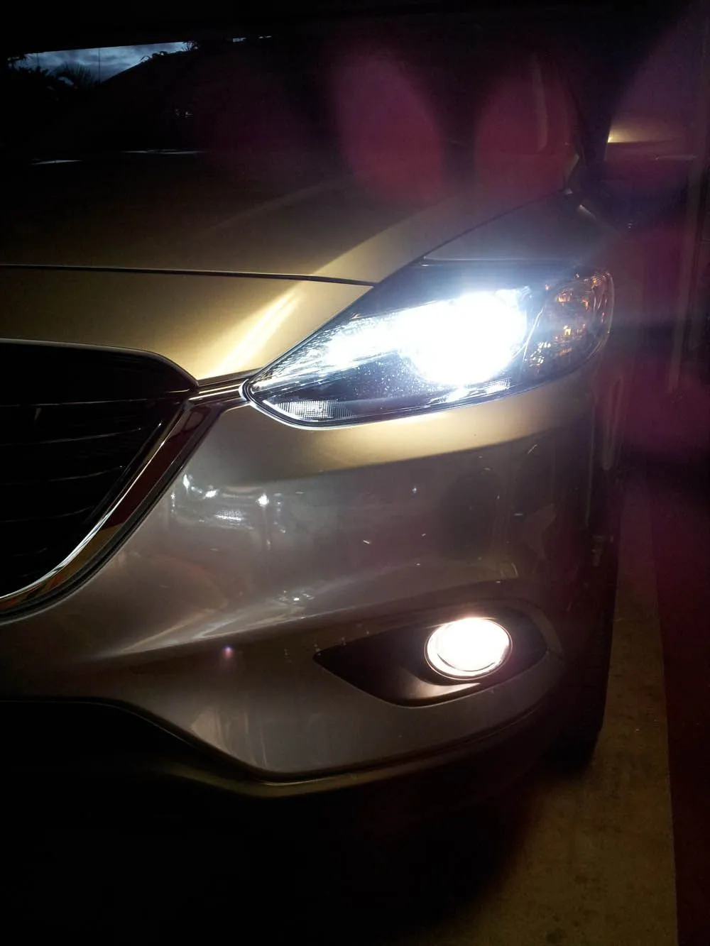

Mine is a 2013 model too, but for me, I wonder if the 4500 or 5000 might match my headlights a bit more closely. If you take a look at my pics above, the 6000 fogs are a tinge bluer than my stock HID headlights.
