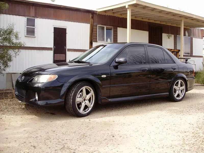

Hi gang!
I have had over 40 Miatas and had sworn off FWD or black cars, and look at what I ended up with!? Friend of mine had it, and thought there was a major problem, so picked it up fairly cheap. Found #3 plug wire was not on. That took care of the noisy misfire, and now having a blast with this little rocket! Just put on new tires (Hankooks) and got rid of the rock hard junk that was on it. Transformed!
When getting the tires mounted today, I noticed one of the center caps was gone. Must have fallen off, so anyone got one, with the 2 set screws? They are the OEM Racing Hart 17s with the raised Mazda logo. I'd gladly reimburse for time and trouble...

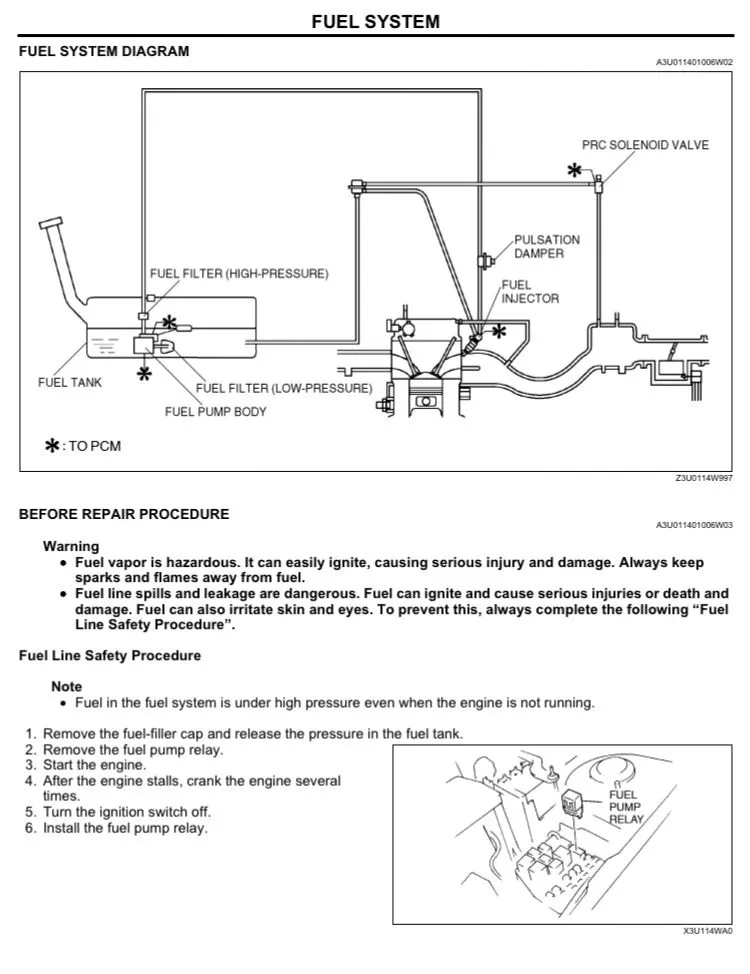

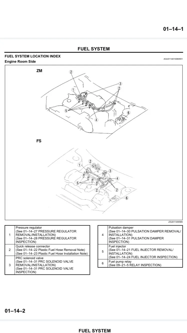

Also had a CEL for fuel pressure regulator, but put some Techron in it and it seems to be clearing up a bit. Since I am new to these cars, is the pressure regulator special to this model? Is it in the tank/pump assembly (like the Miata), or on the fuel rail? Hopefully it will clear up as the miles go on, but just in case...
Anywho, REALLY enjoying the car and glad to join the group. Thanks in advance for any help. (usa)
Pic attached...

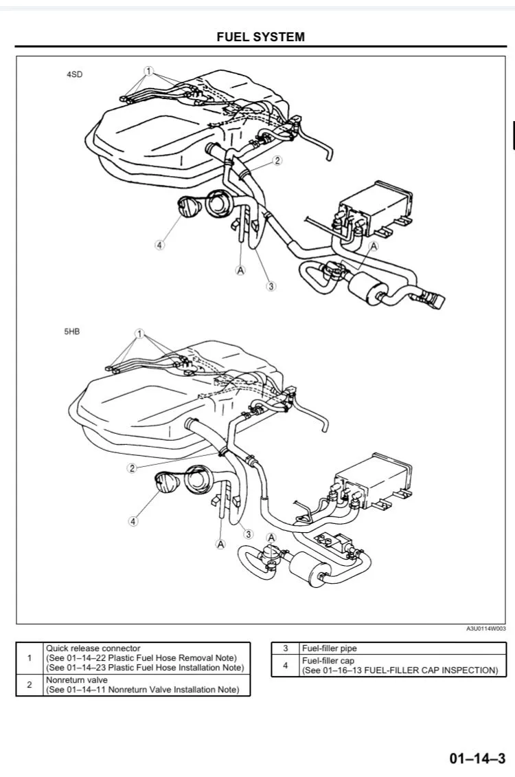

You’re never going to want to get rid of this car. I have the ‘03 P5 and will drive it forever. The car does have a rather unique fuel handling system in my limited experience - different from earlier Protgs at least. For example: it doesn’t have a separate fuel filter but one that is integrated into the pump near the tank and not a maintenance item. But the fuel pressure regulator is at the engine. See attached from the manualIMG_6997.webpIMG_6998.webpIMG_6999.webp
