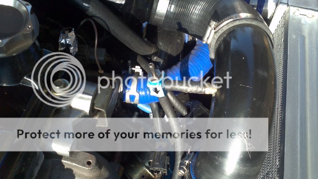

we dont have the same turbo but I thought I had good torque with my setup. Since this post started and another for overboosting I thought I would Double check things and experiment. I had a cheapo ebay mbc which did not work for nothing but they send you a restricted T. Which i used by itself.
My torque improved quite a bit.
Why it works- while there is a side open to the open air, it is restricted and does not leak that much for it to actually effect anything but the waste gate opening. It delays how fast the wastegate opens and keeps wategate creep down. im still running 9psi not over boosting and vac is at -21/-22 hg.
