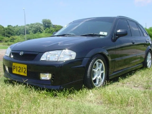

1.5 cold air
there are holes in my bumper when the car came from japan.
