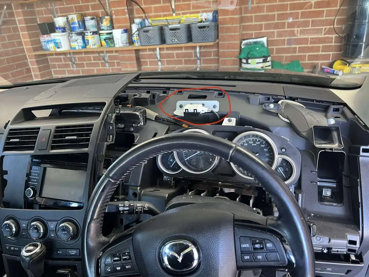

Fixed my buzzing noise. Metal mounted above speedo. Screws were just a bit loose and the metal plate was buzzing when driving or thumping the dash. See photo. Had to remove dash to get at it. I hope this helps someone. Have not seen this solution posted anywhere.
