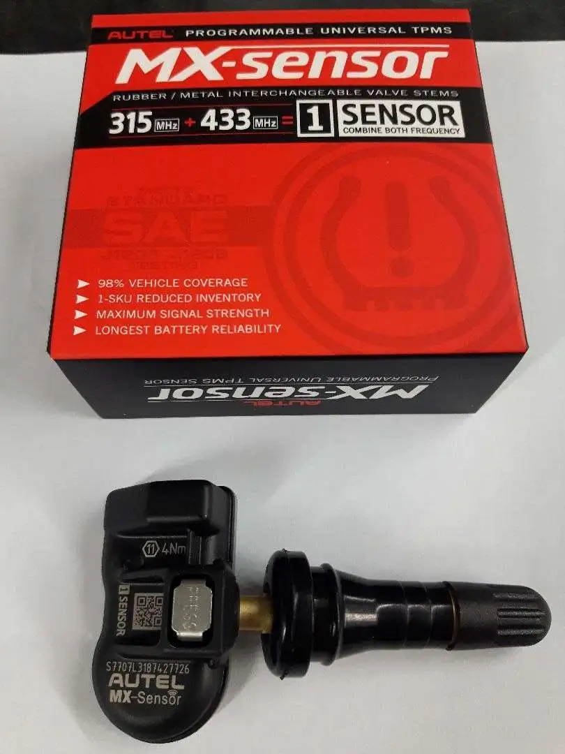

The only difference is your 2015 used the ABS system for TPMS and the 2023 should have transmitters in the wheels. So you'd have to buy some pressure transmitters and have them installed in the winter wheel setup (or have error messages when those are on).
Not a huge expense, probably $200ish to get it done maybe (I'm just guessing)

I upgraded my Gen 1 17" winter rims with the following AUTEL MX-sensor's when I got my new 2018 Gen 2 CX5. They are readily available on Amazon and eBay. My Mazada dealer also sold them, but at a slightly higher price.
