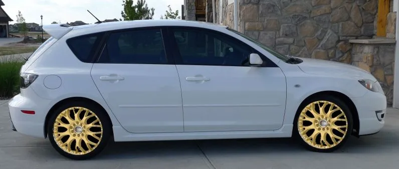

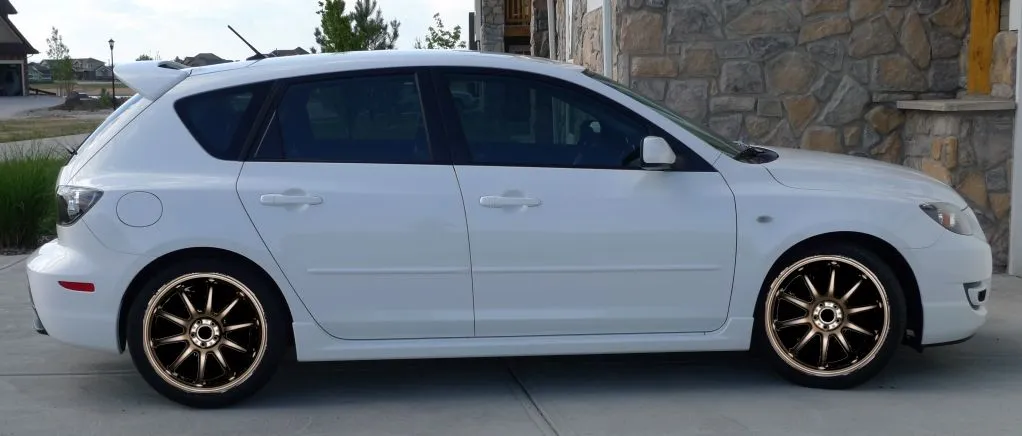

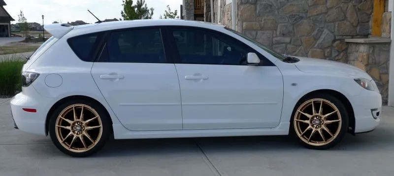

I photochopped (actually Paint.Net'ed) a set of the FLC-01's onto my CWP MS3, what do you all think? I also hacked on some MB Speeds, Drag DR-19's and a really bad image hack job of some Rota Tarmac 3's. I'm not the best at image editing but hopefully you get a good idea of the look. Any/all opinions welcome(thumb)!

Thanks a bunch for all the responses, keep 'em coming and if you have a second lemme know which wheel from my pics you think I should go with. I definitely a novice when it comes to suspension, especially wheel/tire fitment so I really appreciate the help!
