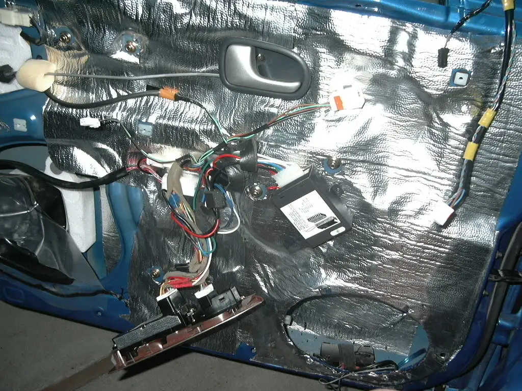

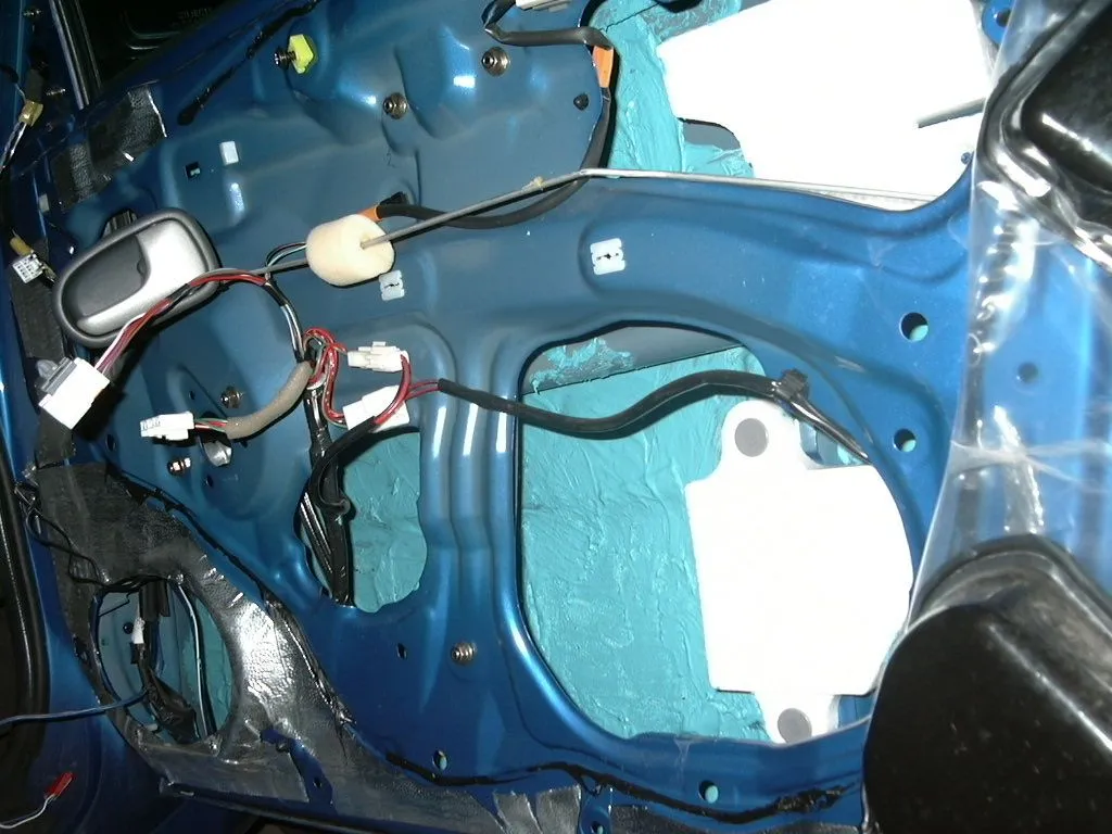

as for the doors i seriously would suggest 2-3 laers. dont nessicarily have to do 3 layers on the door completley but basically the area behind the door on the outter door skin should have a couple of layers. i used a 6.5 with only 50 watts and 1 layer of dynamate on the exterior skin and i still had to adjust the volume down on them because the outer door skin rattled so much and that rattle will kill your midbass big time sound damping sheets are worth their money. and rammatt and a few other places out there have stuff for way less then dynamat. i used partsexpress.com and for around 300$ i got 300+ sq. ft. of sound damping, enough to cover my car with 2-3 layers. bit overkill for most people but its nice to get out of the car, shut the door and not be able to tell the system is even on.

So when you take the door apart there are 2 main metal sections i take it. So you placed a few layers on the outer layer, but the middle layer back on the door and then coated that with mat also? Just want to make sure cause this will be the biggest stereo i've done in a car so far. Want to make sure I do it right.
The outer skin is the backside fo the metal that you see when you look at the side of your car. The inner part is kinda a skeleton framework thing where your windowmotors and such are mounted. THing is there's alot of open gaps and such there to begin with, and it's covered with crinkly plastic. If you pullout the plastic, and cover the whole thing so that it's just a solid wall, it kind of seals everything off, and essentially turns your door into a "box" a large one for your midbass speakers. I posted osme pics back on page3 of this thread, but let's see...
http://www.msprotege.com/vbb225/showthread.php?t=67844&highlight=doors+edead In hindsight, the paint-on really didn't add much convenience, cost more money, and really just made things kinda messy. with a little bit of patiece, and careful trimming and folding/peeling, etc it's entirelypossible to get good coverage backthere with standard style deadening

So the "box" is the area inbetween the back wall and the inner support? So you basically try to cap off the area where the windshield + motors are? What about sealing the sides of the door?
correct. However seeing as it' such a large space, pressure changes aren't all that significant, so it's not absolutely vital that every little nook and cranny gets capped off. Infact you'll need to leave a hole of some sort for your doorlatch pushrod. I'm Actually currently attempting to figure out what to do to keep my Windowseals from flapping, it's kind of annoying.
