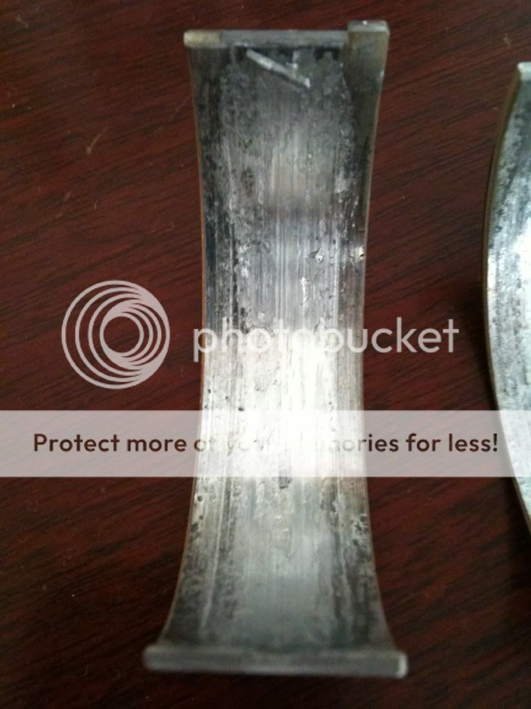

Here are two pics of the bearings.... we couldnt' believe the engine wasn't making more noise than it was.
All 4 bearings look similar to this.
Wow, that's quite the gouge in that first picture. Is there any material actually stuck on / melted to the journal?
My mechanic said that the journals didn't look nearly as bad as the bearings... the one with the gouge was definitely the worst.
