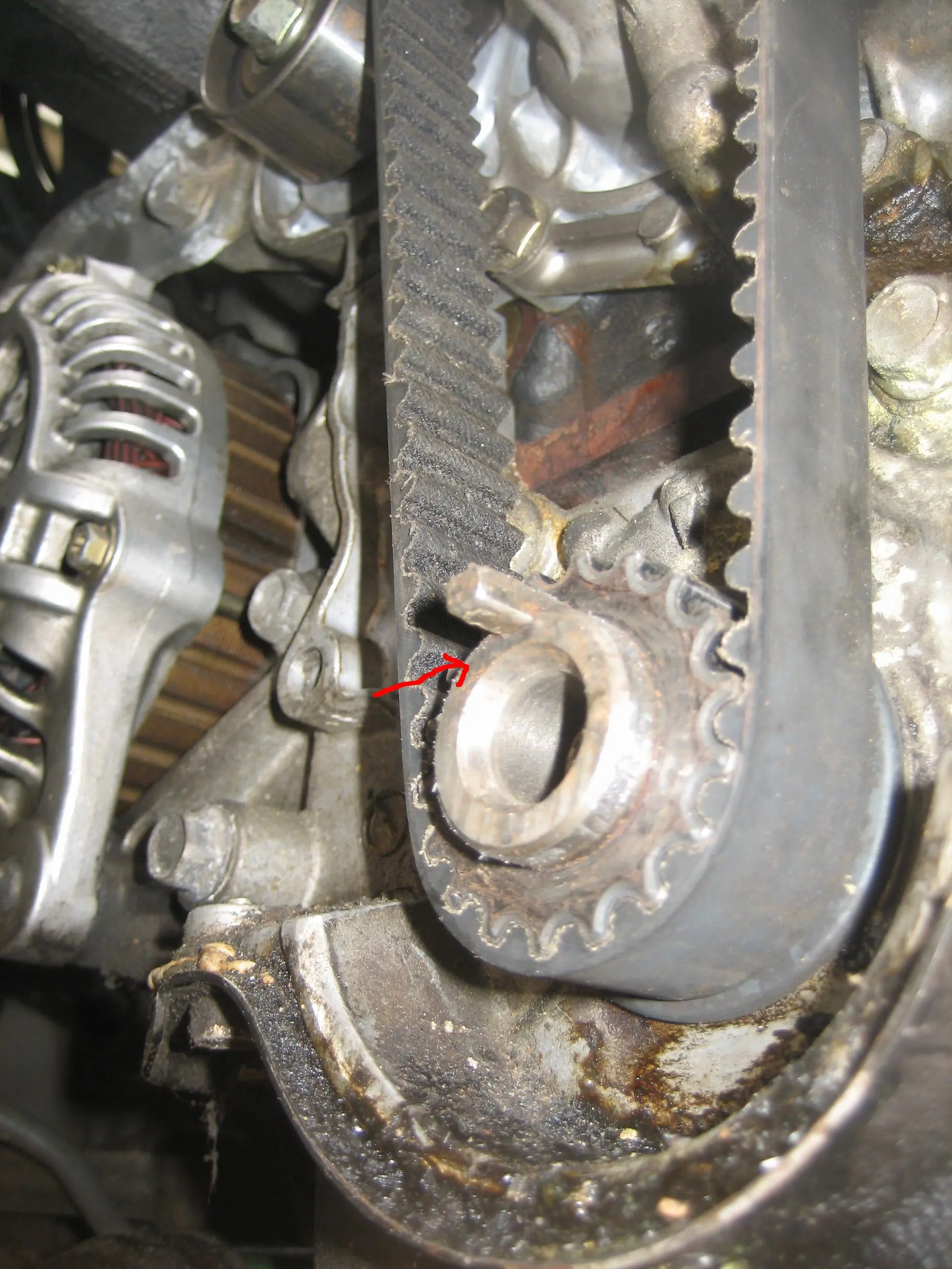

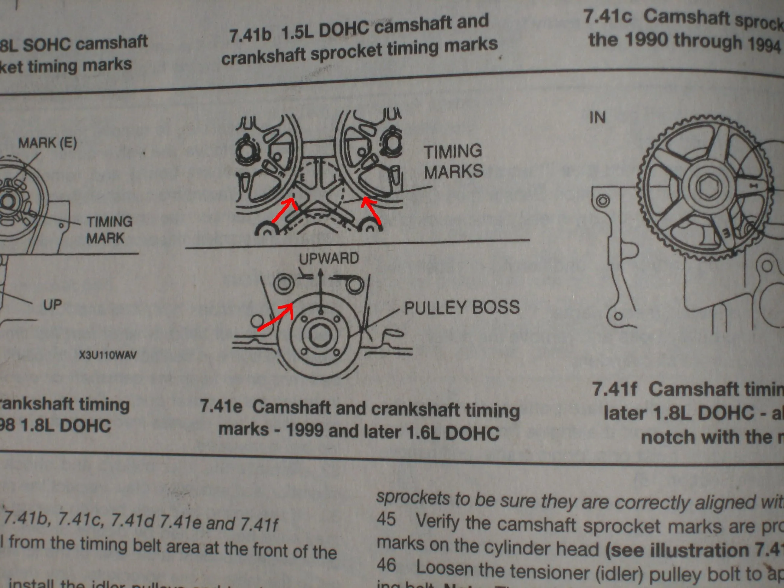

Thanks again for everybody's help I still cannot get the car to start. I have added some photos of the Haynes Manual and my car photos.
I have been able to find TDC, however the directions call for the Crankshaft sproket mark to face upwards. If this is the case then the car would not be at perfect TDC according to the guide.

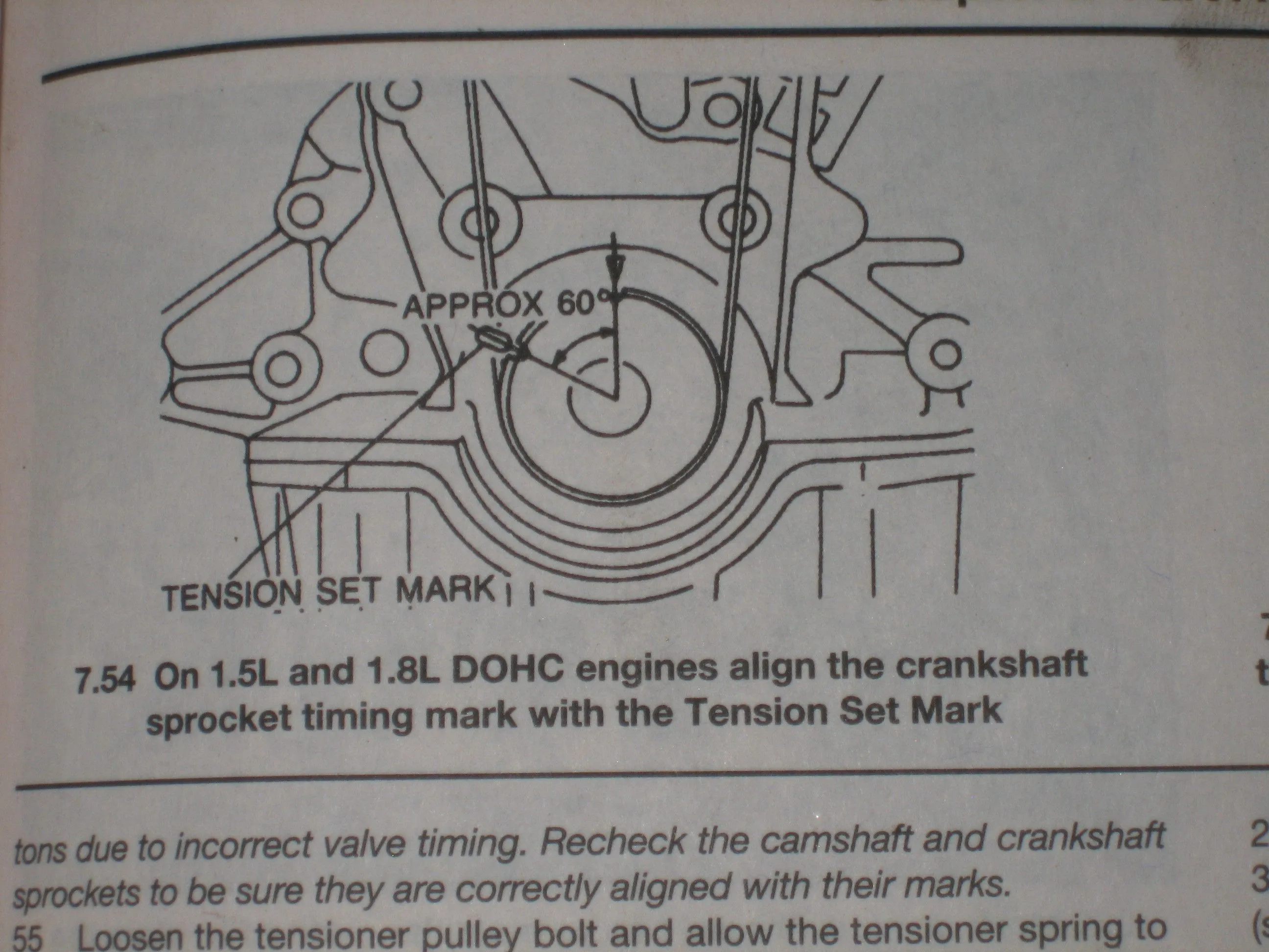

now with the belt on there I turned the crankshaft like the haynes manual tells me to do, 1 and 5/6 turns clockwise until the crankshaft sproket mark is facing the tension set mark on the engine block.
I then tightened the belt down to the approximate torque specifications.
I then turned the crankshaft 2 and 1/6 turns so that the crankshaft sprocket mark was facing the top again.

Make sure you put pulley on crank to line up TDC on mark on pulley not key way (little metal piece stuck on crank shaft) THEY ARE NOT IN THE SAME POSITION!!!
yeah sorry about the instructions picture, the picture is 1.5 , but i meant to post a 1.6 picture which shows the same setup that my photos show. I wish there was a way to reset everything, it seems like my problem could be a camshaft sesor malfunction or possibly a crankshaft sensor malfunction.
packerfan in regards to the tdc you say that the metal clip is not the same, but the dowel on the crankshaft pulley sits in the same direction as well. although there are little numbers and or letter on it, which I am not sure what they mean.
The haynes manual show's that you are supposed to align tdc by matching up the painted tooth, on the harmonic balancer. which sits at about 4 oclock on the harmonic blancer when the dowel on the crankshaft pulley is facing up. i may have to take a picture of this as well.
oh and looking at the picture again it actually says 1.6 but you have to zoom in on it, looks like 1.5 from a distance.

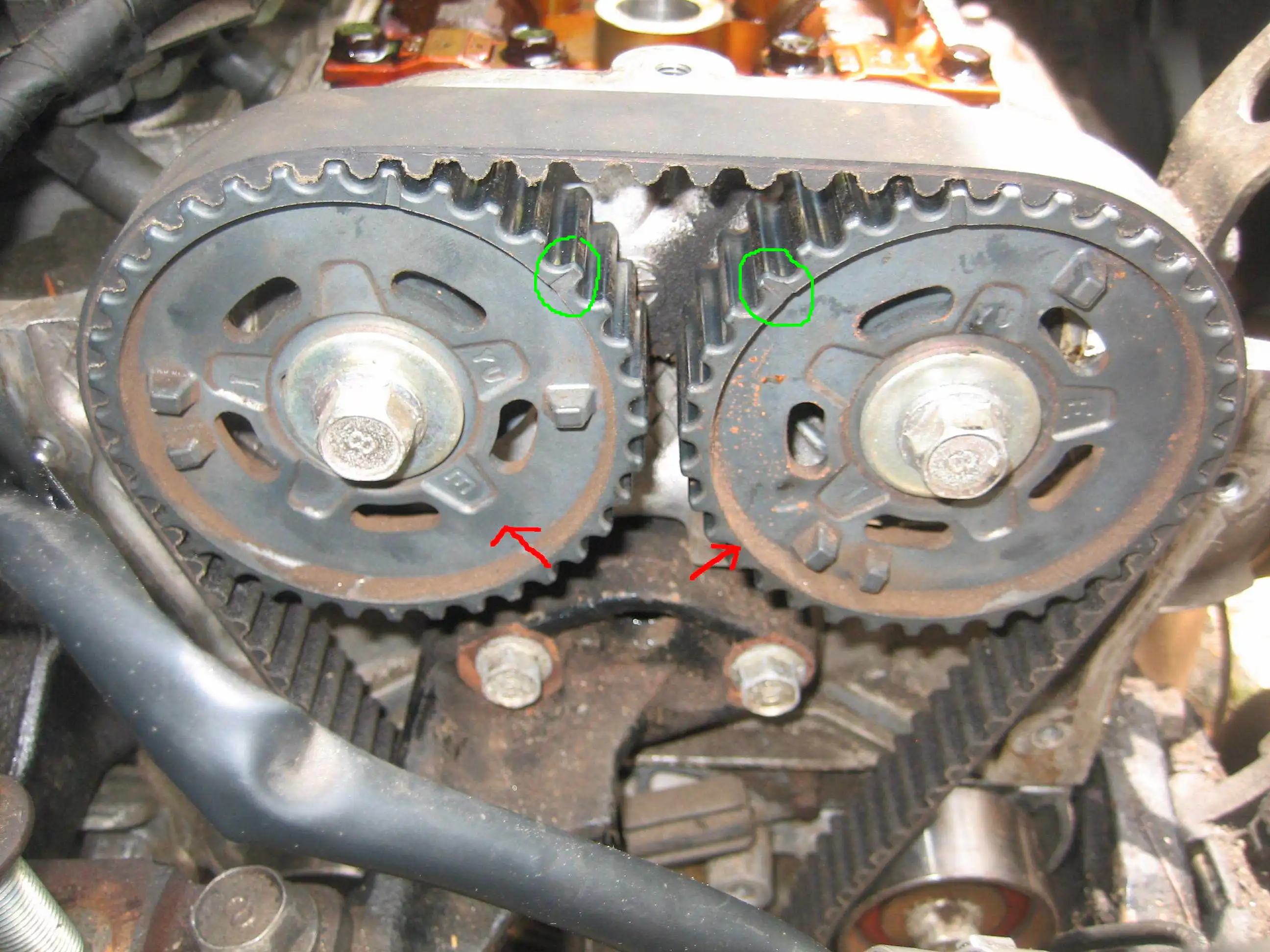

When I replaced my timing belt I used different markings on the cam pulleys. Compared to the way I set mine up you're completely off. Look at the encircled markings in the picture below.

So where exactly are those marks supposed to be placed? would you say that those marks should sit on the top, or in the directions of the E and the I ? Thank you for your help, I am totally stumped on this, but hopefully my trial and error's will be a good reference for people in the future. The haynes manual makes no sense at all.
Sorry about that, i edited the picture. The marks were lined up horizontally in the middle. But when i looked closely i noticed 2 notches on each cam gear, so i'll check mine out and take some pictures as a reference.

Ok i managed to remove my valve cover and take a picture of my set up. I circled the markings in your picture that need to line up, double check them though. Good luck

thank you very much, i cannot tell you how appreciative i am for this. I realized tonight that the haynes manual is completely wrong when it comes to our engines, If I line my marks up like you have them, is it still possible to be 180 degrees off?
I went ahead and lined them up like you have them, and for some reason i think that I am 180 degrees off. the car is showing signs of life now for the first time since i started this fiasco. It is trying to start now that my cams are lined up properly, but it wont start. I know i am getting close, when cranking on the car it will crank..crank...crank..crank..start...studder...stop (( then the cycle will start over again.
