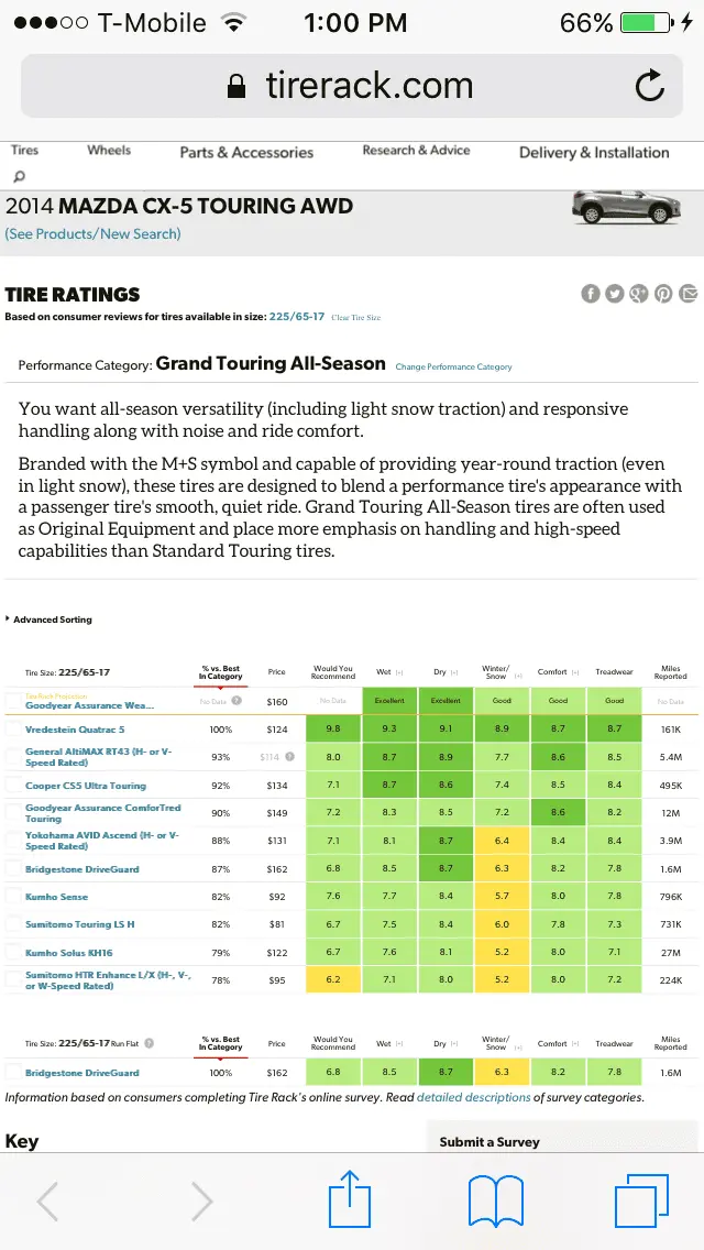

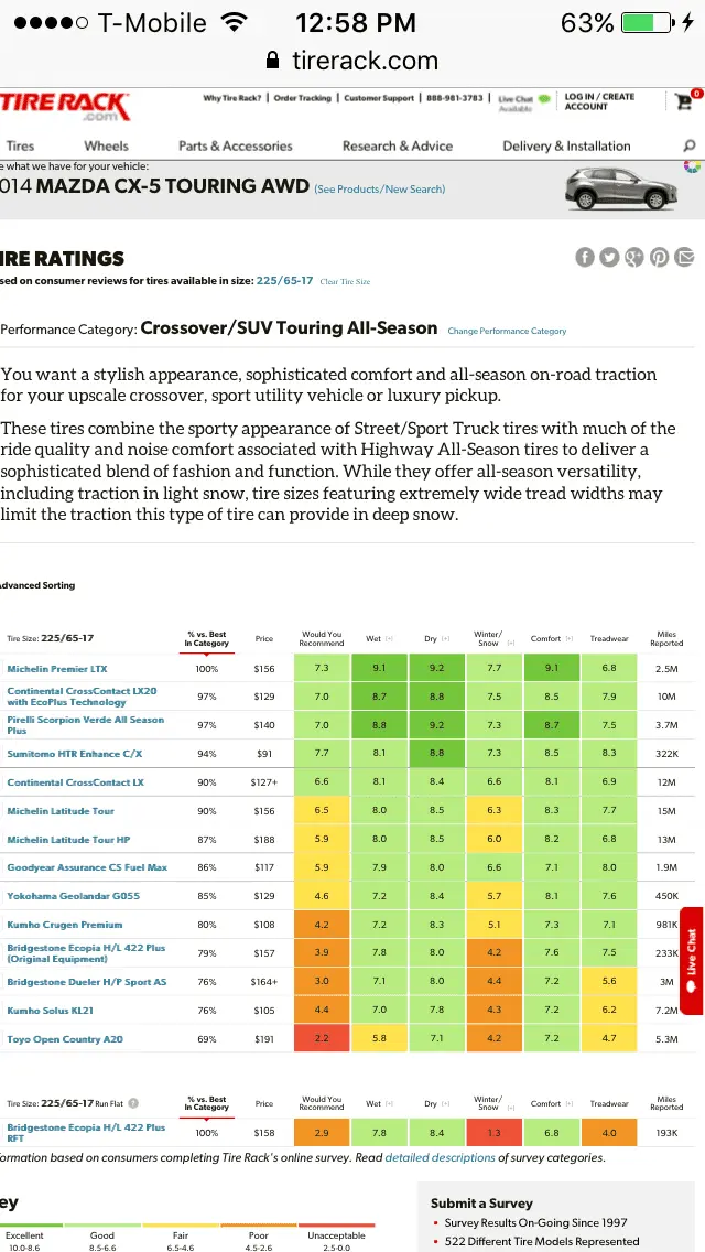

Since one person's opinion on tire performance can be totally different from the other on the same tire, I'd suggest you compare tires from you own experience. We all know OE Yokohama Geolandar G91A is crap and performance ranking in Tire Rack proves just that, at #34 out of 41 highway all-season tires. The second set you have, Michelin Latitude Tour is ranked #10 out of 27 crossover/SUV touring all-season tires which is much worse than Michelin Premier LTX. But if you notice, based on Tire Rack tire ratings, while Premier LTX has better performance on dry、wet、winter/snow conditions (9.1、9.2、7.7) than Latitude Tour (8.0、8.5、6.3), but treadwear is worse (6.8 vs. 7.7). Now we compare General AltiMAX RT43 which is ranked #4 out of 47 grand touring all-season tires, it has better performance on dry、wet、winter/snow (8.0、8.7、8.9) and longer treadwear (8.5) than your Michelin Latitude Tour. Based on Tire Tack survey, General AltiMAX RT43 should perform better than your current Michelin Latitude Tour, especially in winter/snow condition, but it also lasts longer on mileage.
attachment.php
attachment.php
Here are partial list of many 225/65R17 tires with specs. I still feel General AltiMAX™ RT43 is the best buy with excellent reviews. And Continental is a major tire company based in Germany.

I was assuming he doesn’t care about winter since he has Blizzaks.
I definitely think the Altimax are a good choice as well. And very budget friendly.
Yes, correct, do have the Blizzaks now, so winter is less a concern at the moment.
Well I may just decide to grab the Altimax then as they are definitely budget friendly.
As long as the feel and responsiveness is on par or better than my current Latitude Tour tires, I will be happy. If they are worse though, then no, but having a hard time figuring out how to compare that aspect of them lol.
Edit: And yrwei, I do appreciate the charts, but I can say that I take the review ones with a bit of a grain of salt. When I bought my Latitude Tours (Sep 2014), on tirerack they had much better numbers than what you are showing now in that post. That could be from a variety of factors, but the numbers aren't static, and I am sure may change for some of these tires that are newer as time goes on.
Still, overall helpful though, so I do appreciate it.
Probably the Continental TrueContact. The Pirelli are weak in the wet. And you get used to the steering feel and then its normal.
You have to be careful on 225/65R17 TrueContact! It's a totally different and inferior tire from other TrueContact's such as 225/55R19 99H and usually very similar General AltiMAX RT43 in H-rated 225/65R17, as it's T-rated (instead of H-rated)、heavier (28 instead of <25 lbs.)、lower maximum inflation pressure (44 instead of 51 psi)!
If you start reading into the reviews you will find some interesting stuff and cases where people are obviously rating the wrong tire or have unrealistic expectations. So you definitely should take it with a grain of salt.
I put more weight to the Tire Rack instrumented and professional tests. The Altimax get rated well from Tire Rack as well. And Tire Rack even praises them for steering response. Seems like the main complaint is as tread noise.
I don’t think you’re going to beat them for the price.
