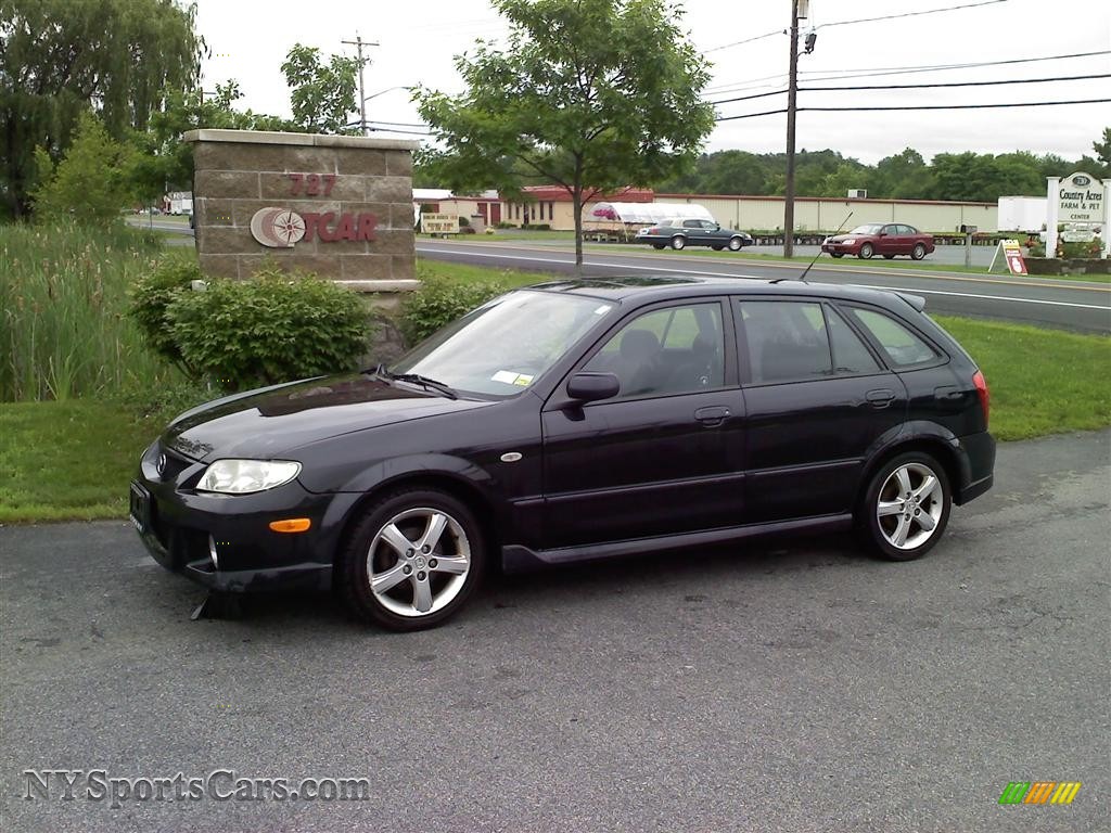

Looking at the pics I have these thoughts:
  1. Appearst to be an 02 and not an 03. The 02.5, 03 and 03.5 had turn signals in the front fenders. Also the wheels in the CL ad appear to be the 02 twist wheels.
  2. Have the mirrors and rear spoiler been painted / plasti-dipped? The mirrors are black and the spoiler appears to have peeling paint. Both are notorious for having the clear crack...I too have a classic red, so I have first hand experience.
  3. Back to the wheels. In the pics he sent, there are aftermarket wheels. Is this a winter tire package that comes with the car? If so, what shape are the tires in? And what shape are the OEM wheels and all-season / summer tires?
  4. There is an aftermarket exhaust. What brand (just curious)? Any other engine mods? No pics of the engine bay, so a CAI / SRI or maybe even a header?
  5. Aftermarket h/u. Looks clean on the outside but poke around and see if you can find out about the install? Most people do it right but others like to hack the stock wiring harness.
  6. Should you get more pics or go see it in person, check for rust in the trouble spots! These are the hood (front lip); PS strut tower (in the engine bay); A-pillars and roofline near the windshield; inside of doors (along the bottom edges); rear of rockers (check out the side skirts, are they nice and tight to the body or do they have some play; rear qtr panels (is the bumper sagging?); rear hatch around the emblems.
Given the list of maint. items done the price is pretty good with the mileage as long as there is no rust.

This is great stuff. Thank you guys.CTt3P5, I'll ask about the sideveiws and the rear spoiler, my guess is the paint was/is pealing off. As for the fenders, that is weird. I would assume the bodies are the same, so you can take a no side marker fender and bolt it up to an 03 body? And, the wheels... I don't get it. They look the same to me in both pictures. I don't know if they're stock or not, i can see that they do have the Mazda center caps. Idunno.
Yes bodies are same and parts interchangeable. So if it is an 03 then I suspect an accident and 02 fenders were used as replacements. Just noticed it has the non flip cupholders too which were introduced on 02.5 refresh. They are easily swapped though. Cant tell but are their tweeters mounted in the sail panels of the front door? Another 02.5 standard feature but also something that can be swapped easily. Those arent P5 stock wheels. Either aftermarket with OEM center cap used or OEM Mazda from another model. Most Mazda 5 lugs fit the P5. I replaced my stock wheels with Tribute wheels and replaced those with 16" Miata wheels. For winter duty I have 14" 1993 Mitsubishi Eclpipse steelies.

@CTt3P5 - the rims look like the stock 02 rims to me. Don't know what you're seeing that's making you think differently? Other things I'm seeing that makes it an 02 are the shift knob and the gauge cluster (white vs silver-ish white for the 03). The flip cupholder was probably swapped out with the open design. And as mentioned already, there aren't the side fender blinkers. Here are pics of the 02 vs 03 rim design:
02
03
Hey Hank...just took another look and I guess those could be 02 wheels in the pic he posted. Its the angle of the pic throwing me off. Hard for me to see the swirl but then again my eyes are older. lol
