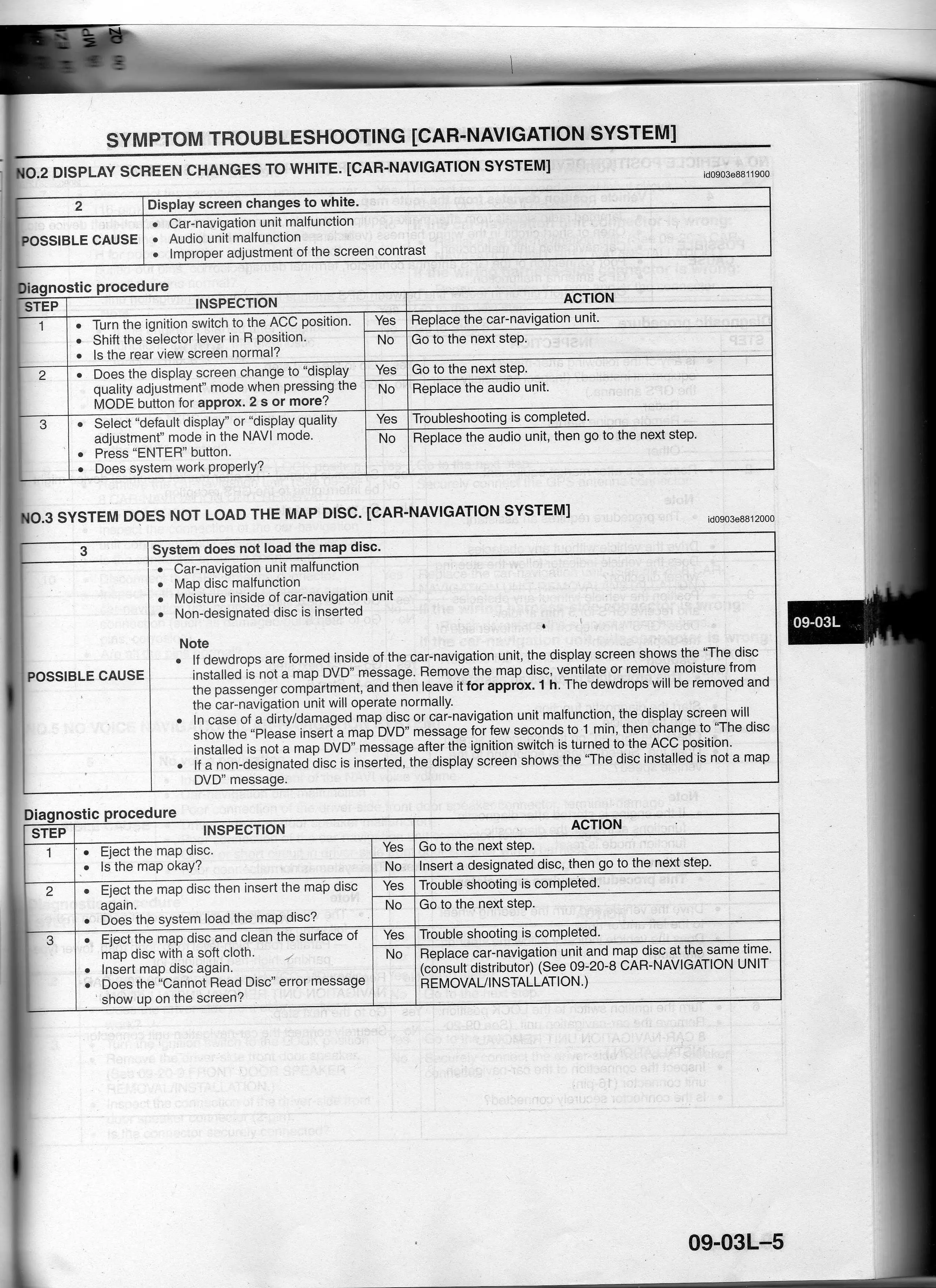

WorkShop manual page for it
See the attached page.
This is what the mechanic would do.
Better fix it before OE warranty expires. It is expensive to replace the head unit if that is where the problem is.

Thanks ceric for the service attachment. I think I am going to run to the stealership this week sometime and get it taken care of.
