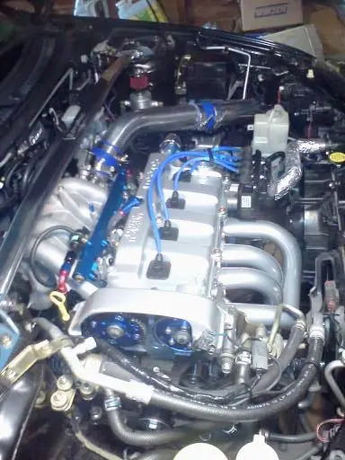

Alright, since you asked here's whats done;
Microtech LT10s.
10.4:1 FSZE pistons, head milled .050 which equates to around 11.4:1 comp ratio
P&P head,3 angle valve job,Supertech springs/titanium retainers
Integral stg 2.5 cams/adjustable camgears
Portmatched 626 intake/custom 90 degree 3" into 2.75" CAI which runs down into fenderwell,sealed with a custom air scoop.
440cc injectors.
Unorthodox underdrive crank pulley.
Fidanza 7lb flywheel
Mazdaspeed LSD/Spec stg 2 clutch
AWR header,SLS midpipe,Magnaflow catback. No Cats.
Catchcan for PCV,No EGR/mass airflow
AWR oil pan,AWR mounts.

Any pics od the engine bay? stock rods and stock redline?
Stock JDM pistons and rods. I do have an oversize set of 11.1:1 WISECOS with K-1 long rods that need to be inserted which with the milling would be around 12:1 total. Rev limit set at 7000 with those cams and the headwork it will keep breathing even higher.
