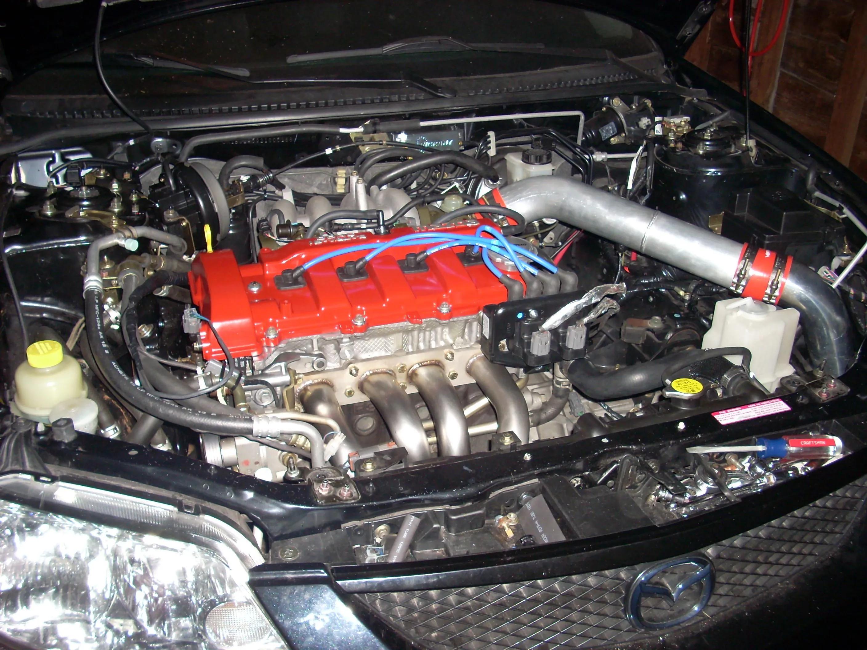

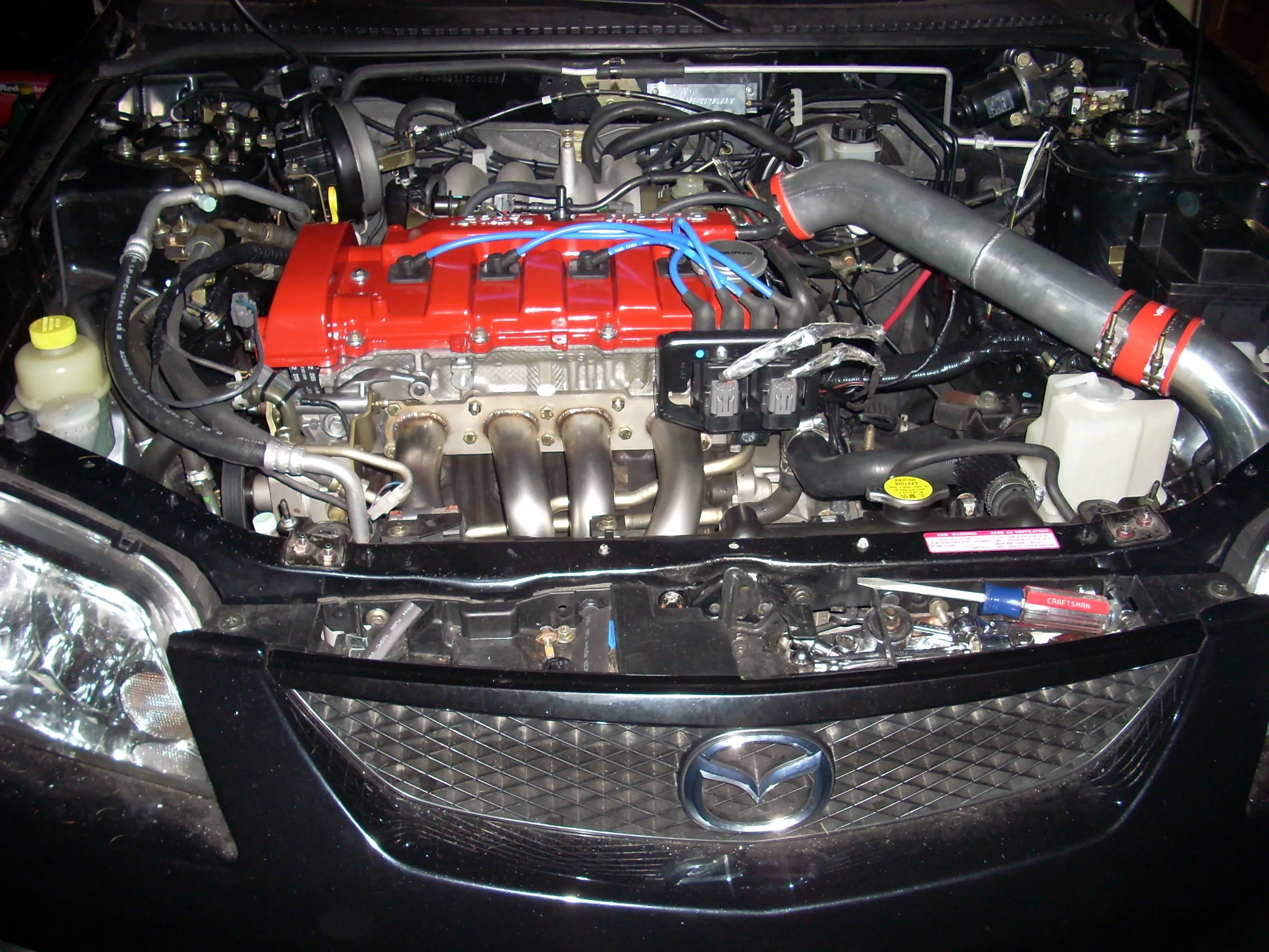

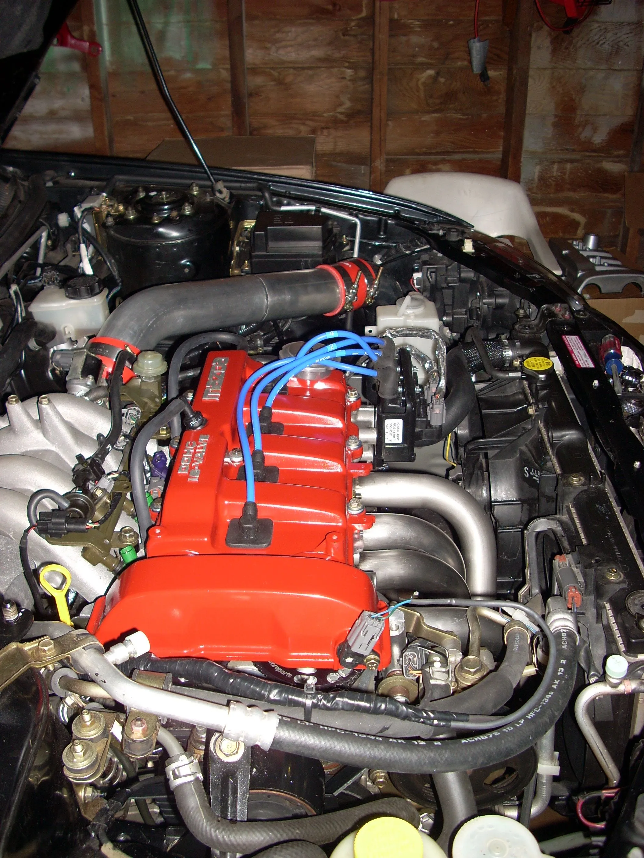

JDM 10.4 pistons,Integral stage 2 intake/stage 1 exhaust,supertech springs/titanium retainers, 3 angle valve job,mild p&p,milled .050",626 intake port matched, polished throttle plate, AWR 4-2-1 header, catless midpipe,Magnaflow exhaust,custom CAI intake. Unorthodox crank pulley,SR camgears, ,1.8 coils,NGK wires, Microtech LT10s, No EGR or MAF,battery moved to the rear,plenty of non engine perf.mods also. Figure if a JDM FSZE will do 170 at the crank i estimate 200 with a good tune at the crank, so about 160 to the wheels. Have 11.1 Wisecos and 5.4" longrods .5 over will install eventually with an LSD Spec clutch lightweight flywheel.
I am curious as to what all went in to your build..? And what kind of power you think it will make?

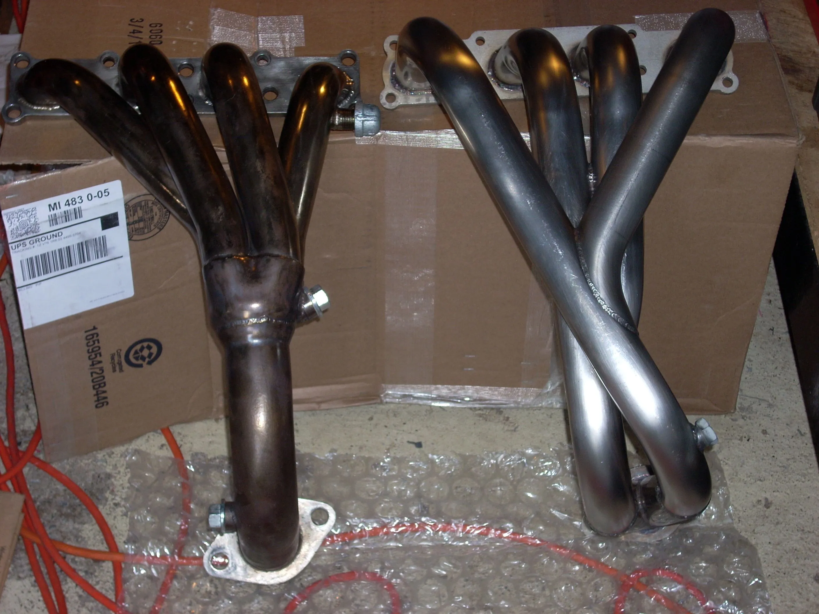

got a full shot of that header? The header on AWR's website looks different to the AWR header i've seen in person...wondering if the design has changed?
Did he break the rods at 7400? Yes the #1&4tubes are on the outside unlike the pic on the site. Tony told me why but I can't remember.OBX and AWR picture;
