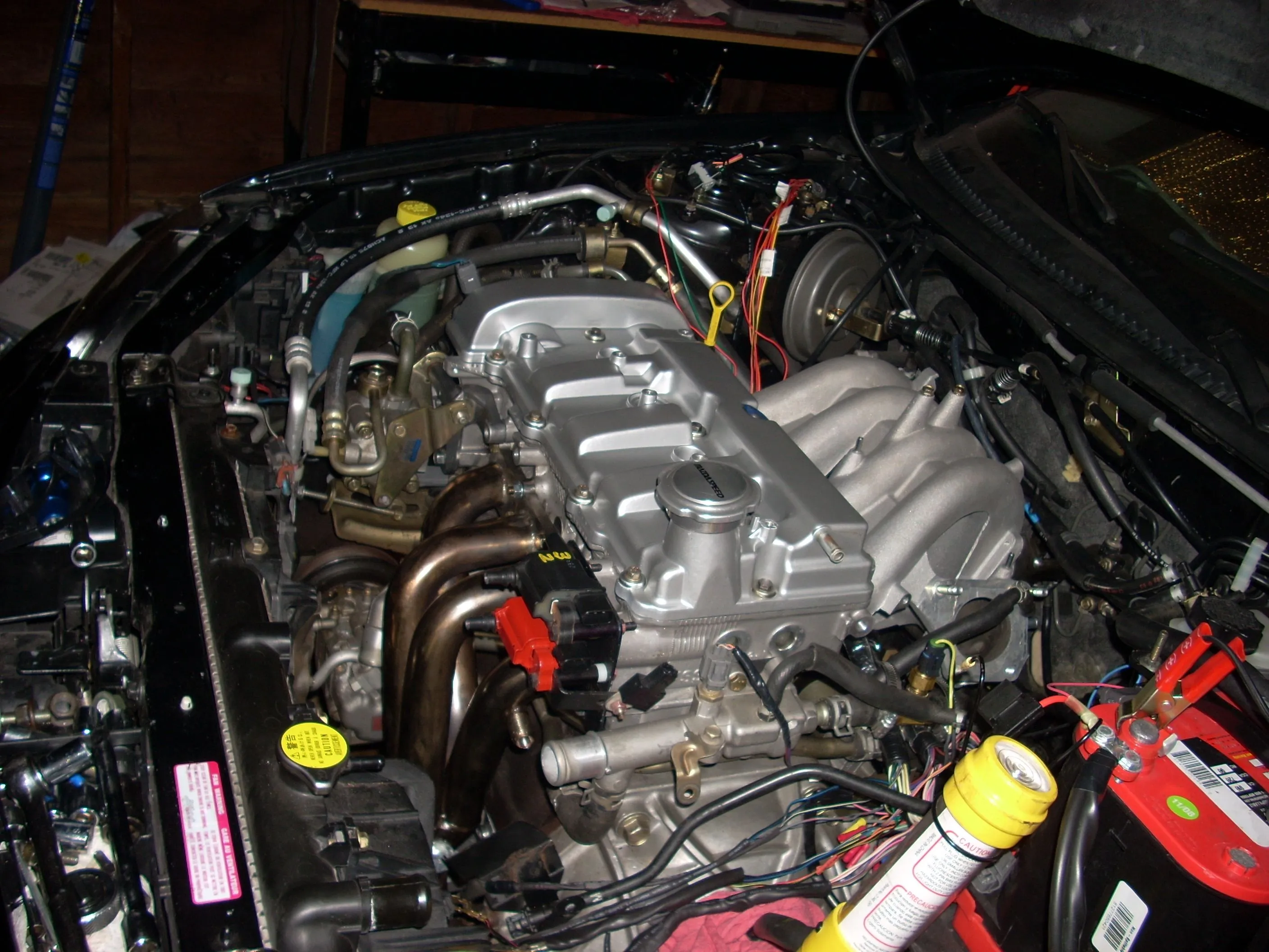

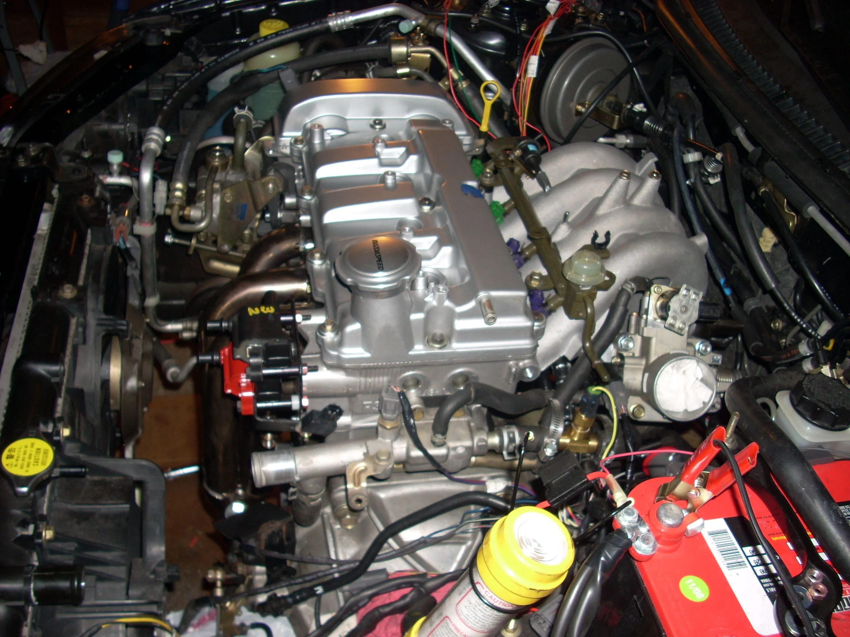

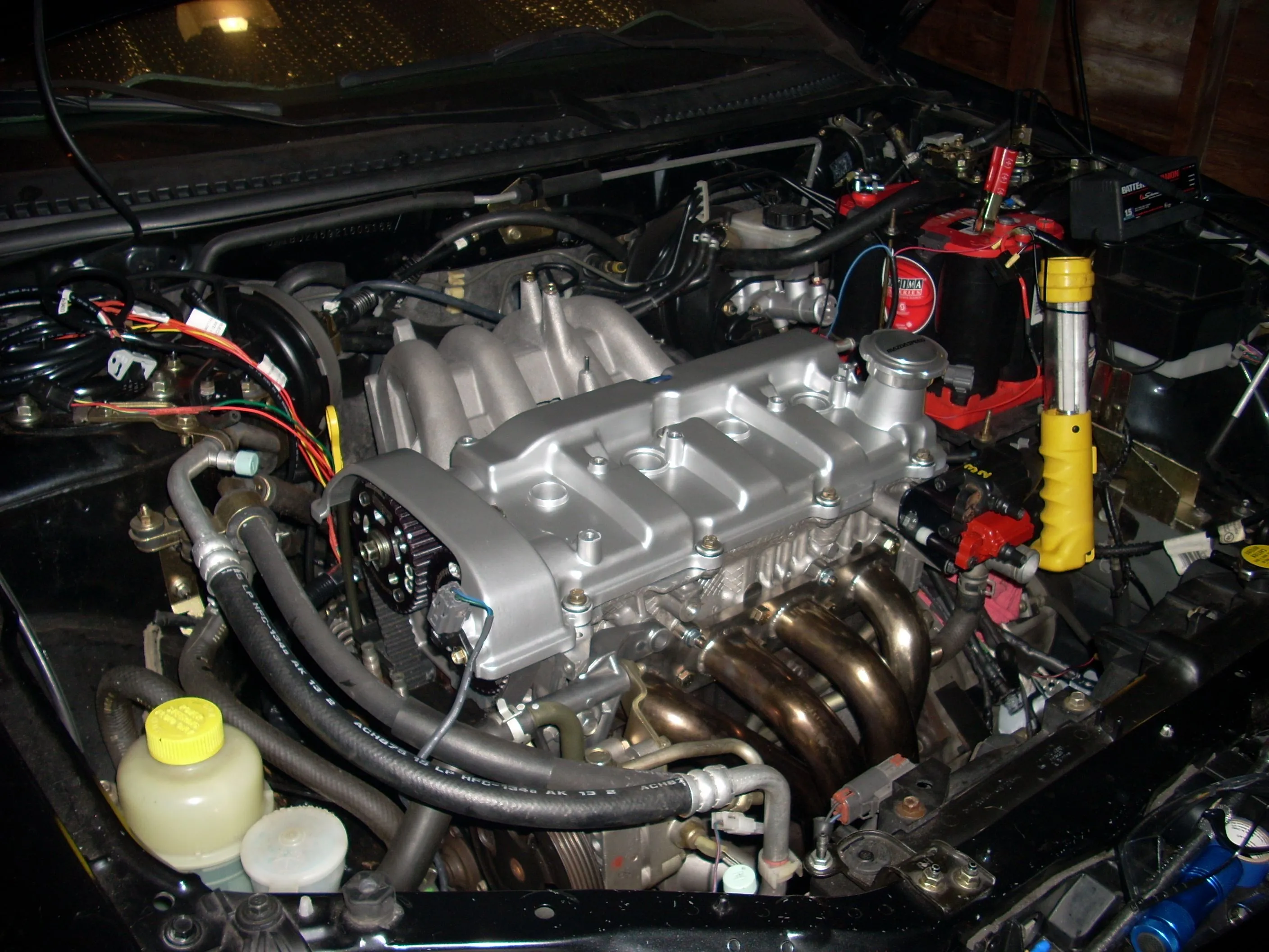

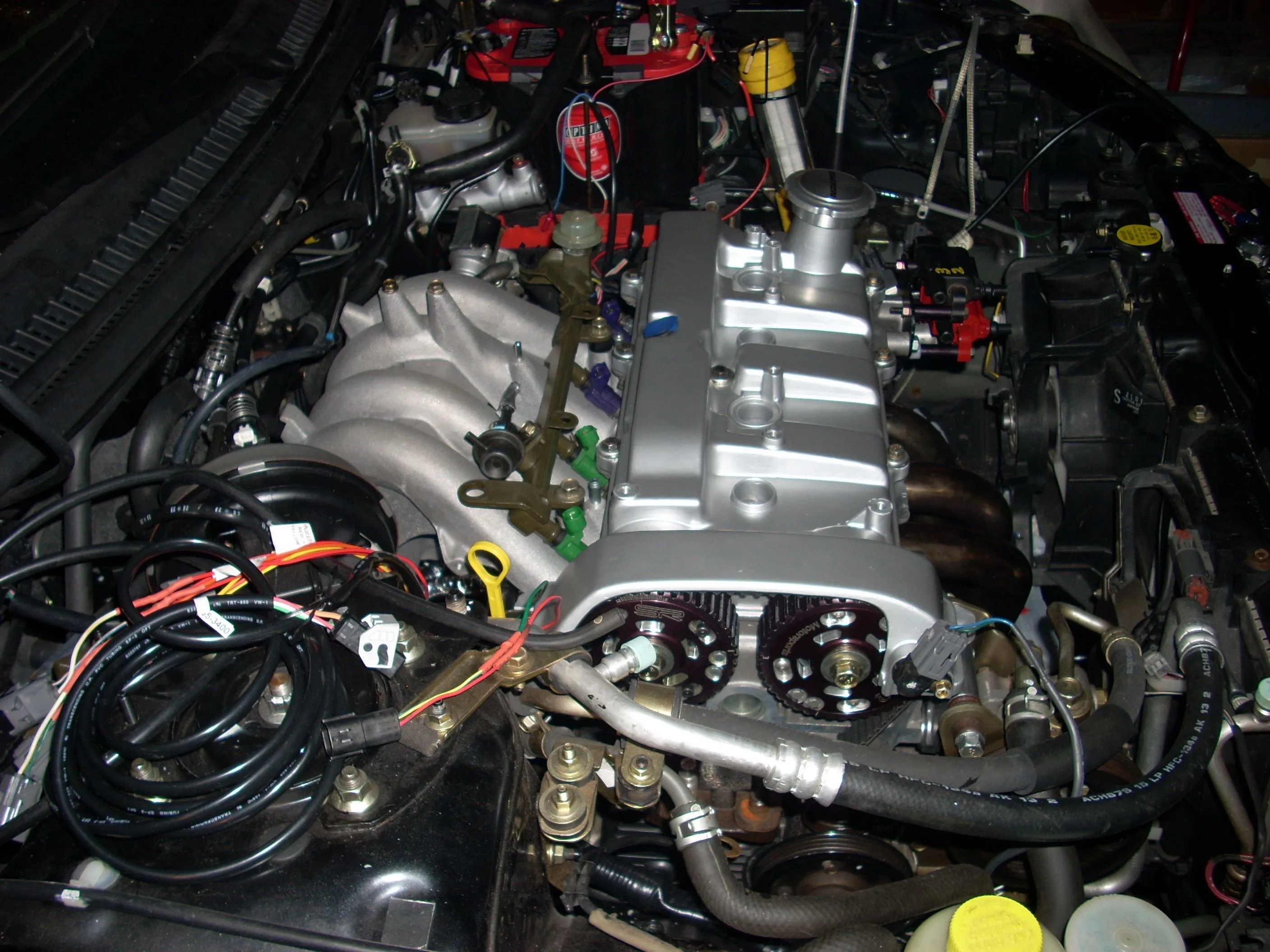

I took some pics last night after mounting external parts.Almost done.
What header is that? looks like a shorty ... chances of that making the kinda power you would need to put a suitable entry into this race are slim to none...
How much power you chasing down? ... either way engine bay looks nice and clean :)
Microtech LT10s,Integral cams stage 2 in,stage1 ex, p&p milled head,10.4:1 pistons(11:1 wiseco's with 5.4"rods waiting to go in with Fidanza flywheel and LSD,)supertech springs,titanium retainers, OBX 4-1 header, SR camgears,Unorthodox crank pulley,SLS catless midpipe,Magnaflow catback,gasket matched 626 intake,K&N CAI,AWR pan,front rear motormounts,AEM UEGO,I think that's it. Probably fire it up next week.Did it all myself except the headwork and some Microtech advice from Lord Worm,Sam at Crossover and Ken PG.
