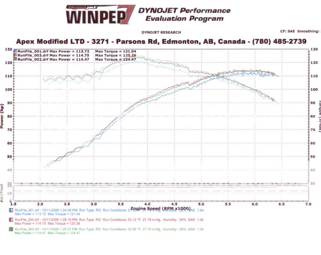

Ford Lynx RS 2.0. Asian/Australian spec 2.0 OBD-I FSDE (supposedly 142hp)
Dyno'd at Autoplus, Metro Manila, Philippines, on a Dynojet. Hell if I know what ambient temperature was, but it was hot, to say the least.
K&N Filter head, custom steel intake piping (stock MAF housing, though), custom heat shield box with cold air inlet.
Thunder Headers
No cat. Still passes local emissions, but I'd probably be crucified in California
2.5" midpipe, terribly ratty 2.5" resonator (that's since given up the ghost)
3" muffler
117.71 whp (three passes... best was 117.9, worst about 117.2, I think...)
115.23 ft.lbs.
Dyno'd previously on a Dynapack, but since nobody uses Dynapack, I just sucked it up and tried it on a Dynojet. Kinda pathetic... :lol:
Re-dynoing tomorrow. Getting a different muffler and resonator and trying a stepped diameter exhaust set-up (2" to 2 1/4 to 2 3/8 to 2 1/2). I love cheap Filipino labor. :)
This was the last time the car was dynoed N/A.

this is when i dynoed last fall on a dynojet
performance mods:
header
intake
catless exhaust
udp
i have since added a l/w flywheel and microtech. i finally broke down and bought some overpriced sr camgears so i should have my twiggy cams installed soon(i hope). hoping to have it dyno tuned within a month so i can show off some better #'s

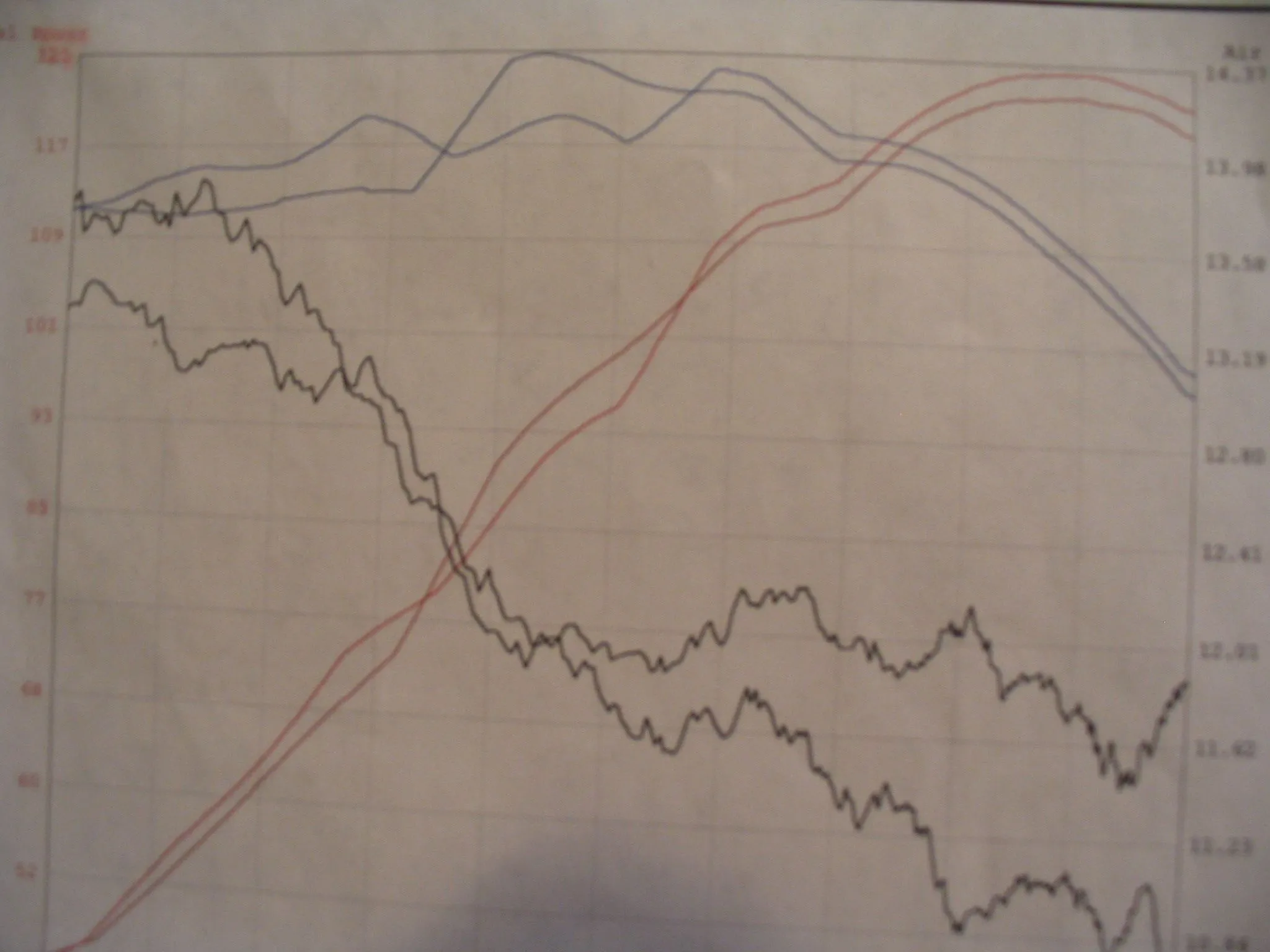

Here's mine...
Mods:
AWR Header
Magna Flo cat-back
Ingen CAI
JDM Sport 20 flywheel
Since then I have installed an MP3 ecu, MAM midpipe, and UR underdrive pulley.
IMG.jpg9
Still have cats? Great numbers for that.
