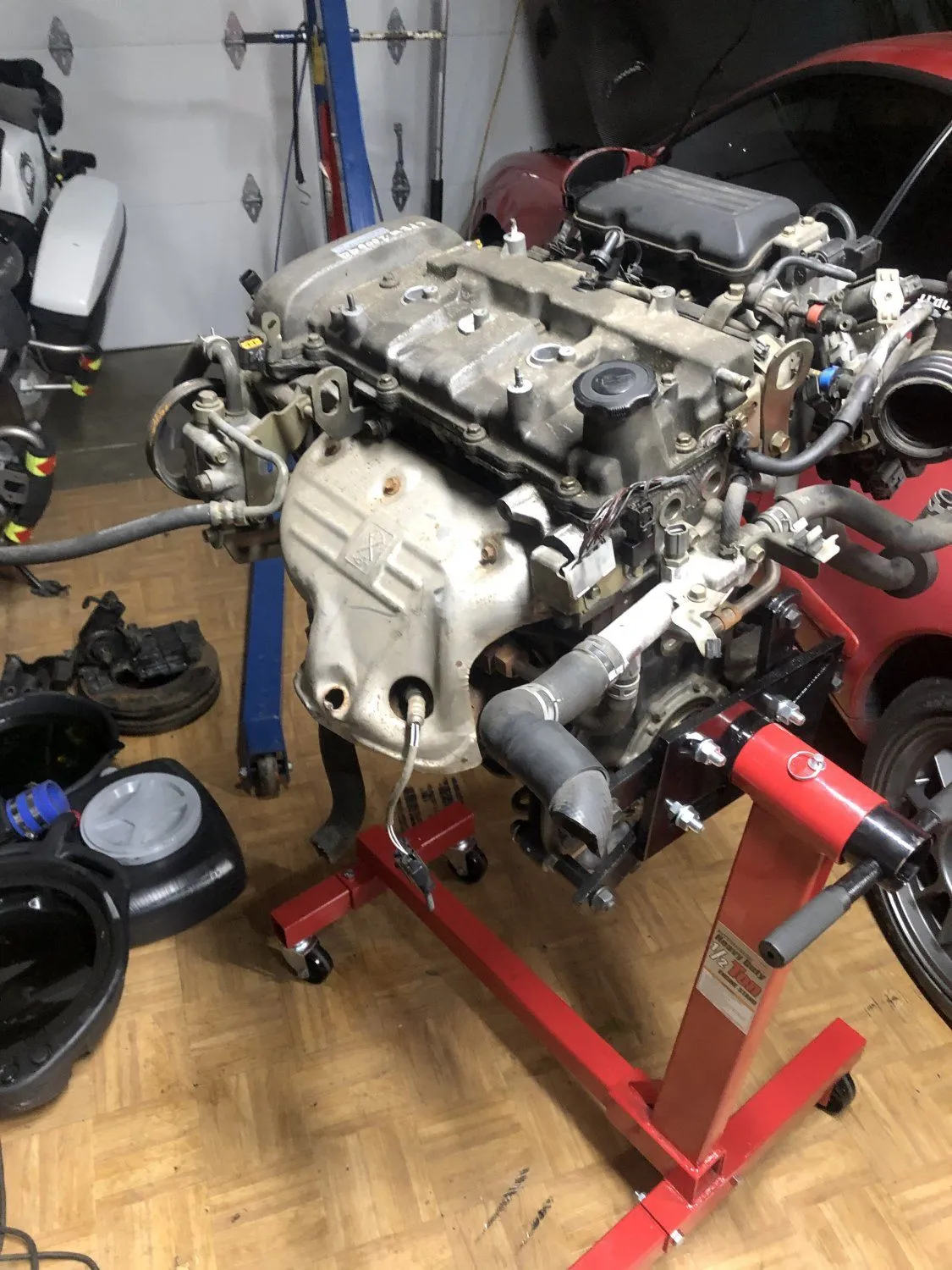

FINALLY some news! Got the engine out, and already have a clue as to how badly things broke.
EXg2mVCUwAAoE3b
When I unbolted the transmission, oil began to spill out from the seam between it and the engine. Haven't taken it off completely yet, but I'm suspecting my rear main seal failed along with other things. Will post more pics and updates as they happen.

Haven’t ripped apart the dead engine yet to investigate, will probably do that after the new one is in the car. $500 got me a 2003 FS-ZE with 65k miles on it, and it appears to be internally pretty clean. Gonna spend time replacing every seal and belt, and also making this thing look new.
