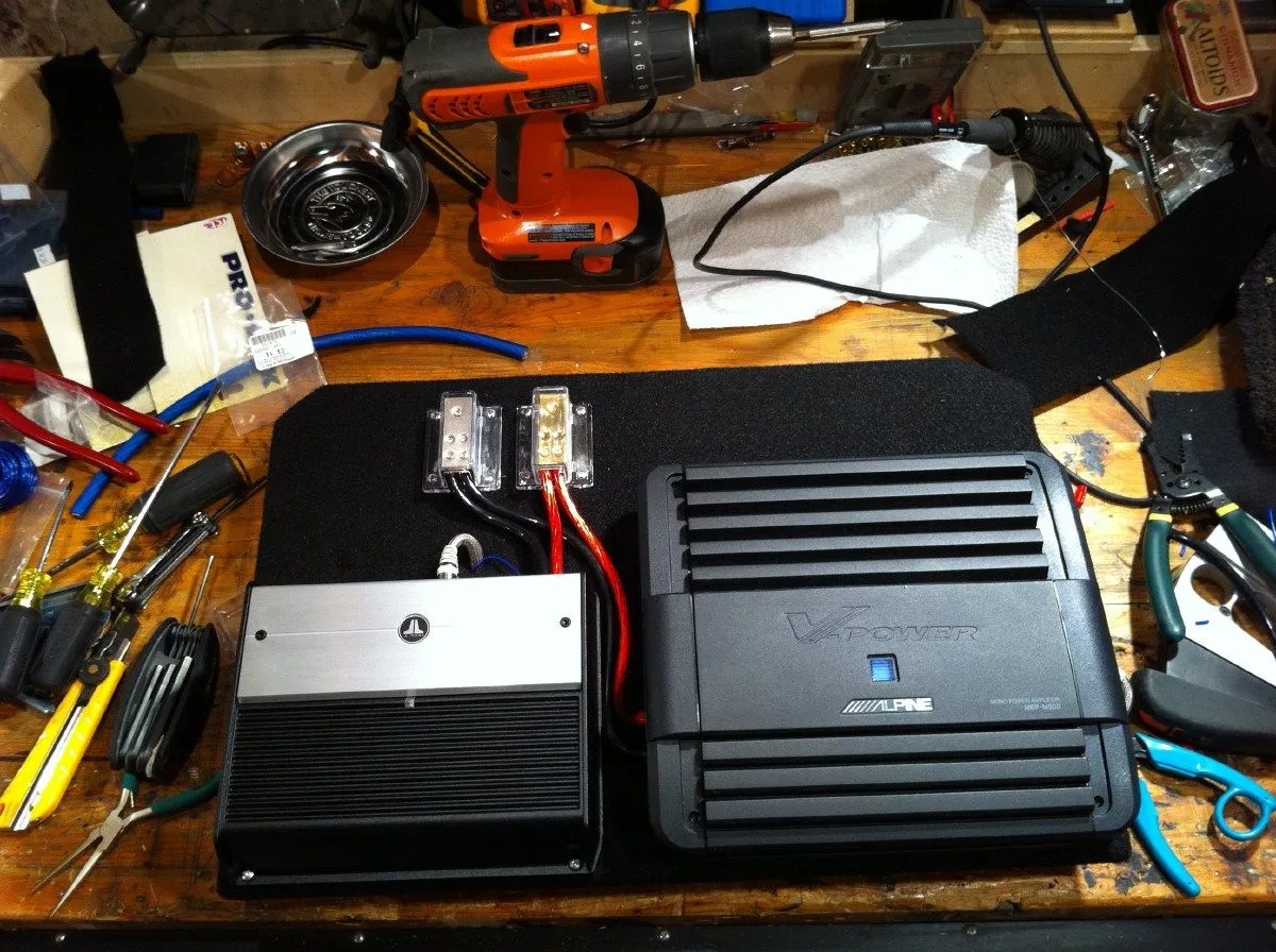

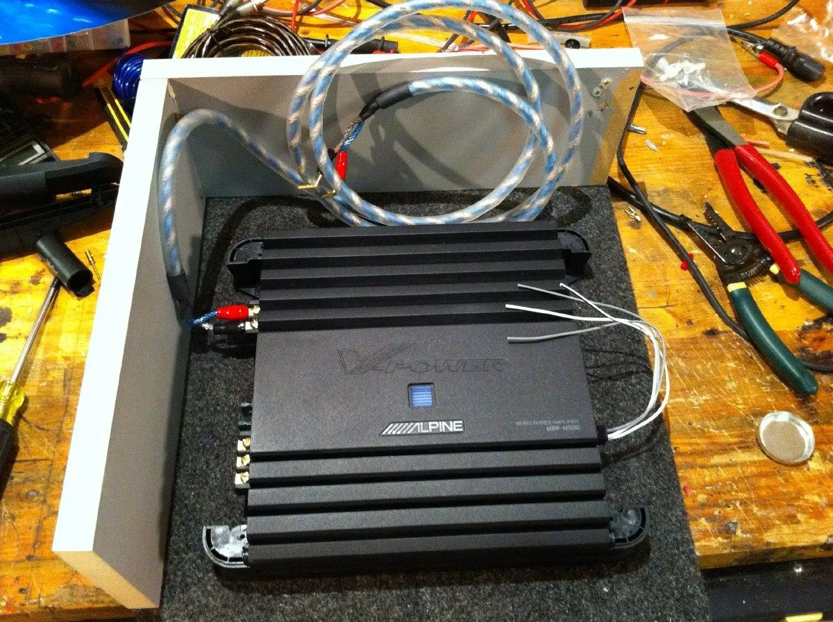

I'll get some more pics tomorrow, but here are some initial ones. The Alpine M500 is great, but WAY overpowering now for the mid-highs being driven by the factory deck, so I've just picked up a JL XD400/4 to drive the mains. So today I started by building the board to mount the amps and distribution blocks. Eventually the plan is to run a JL CleanSweep in front of it all.
The Alpine in its original mount:

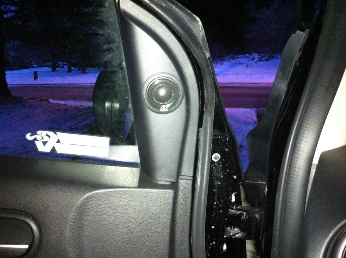

The JL tweeter

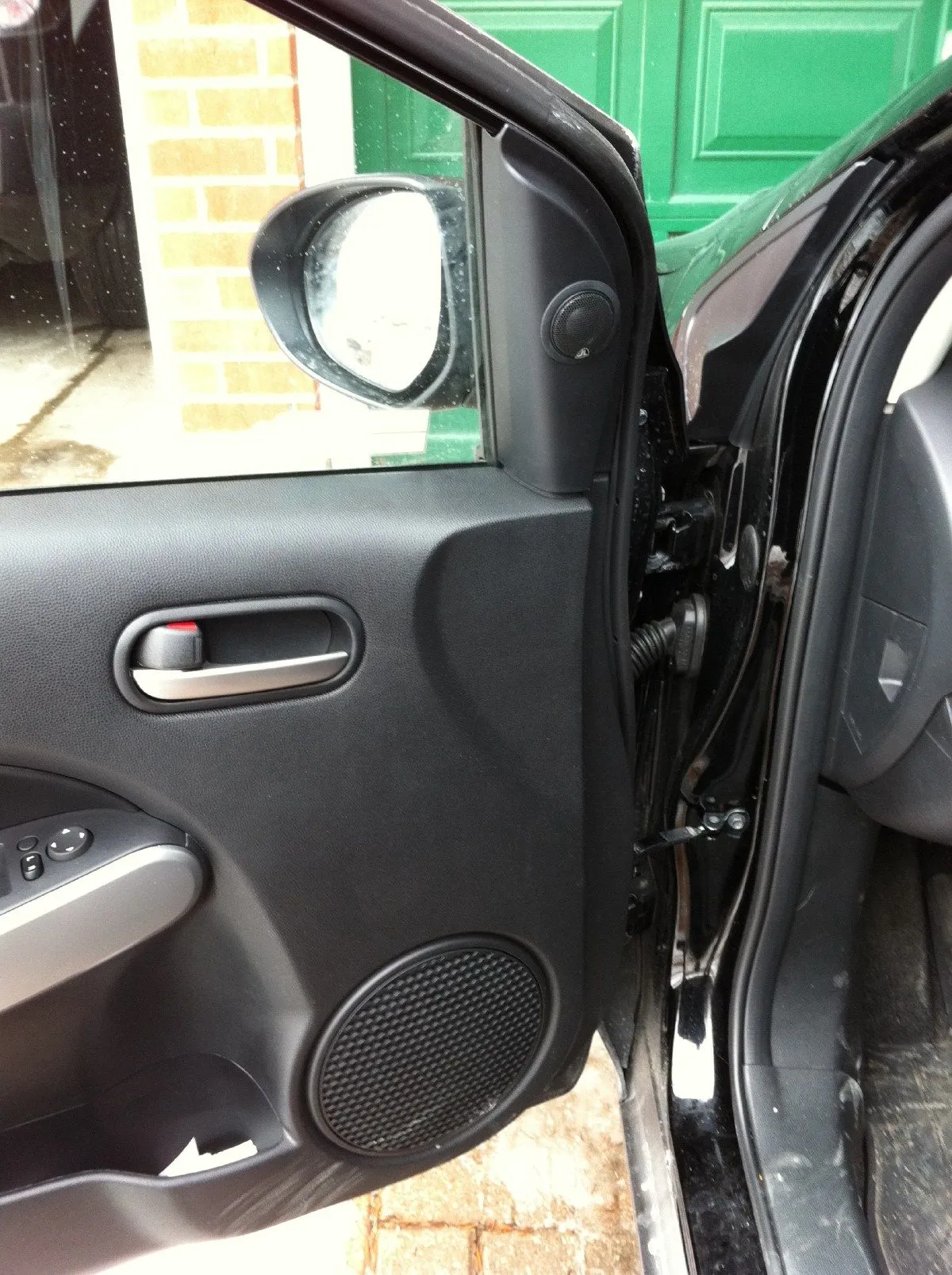

Door panels... Rocking it stealth style...

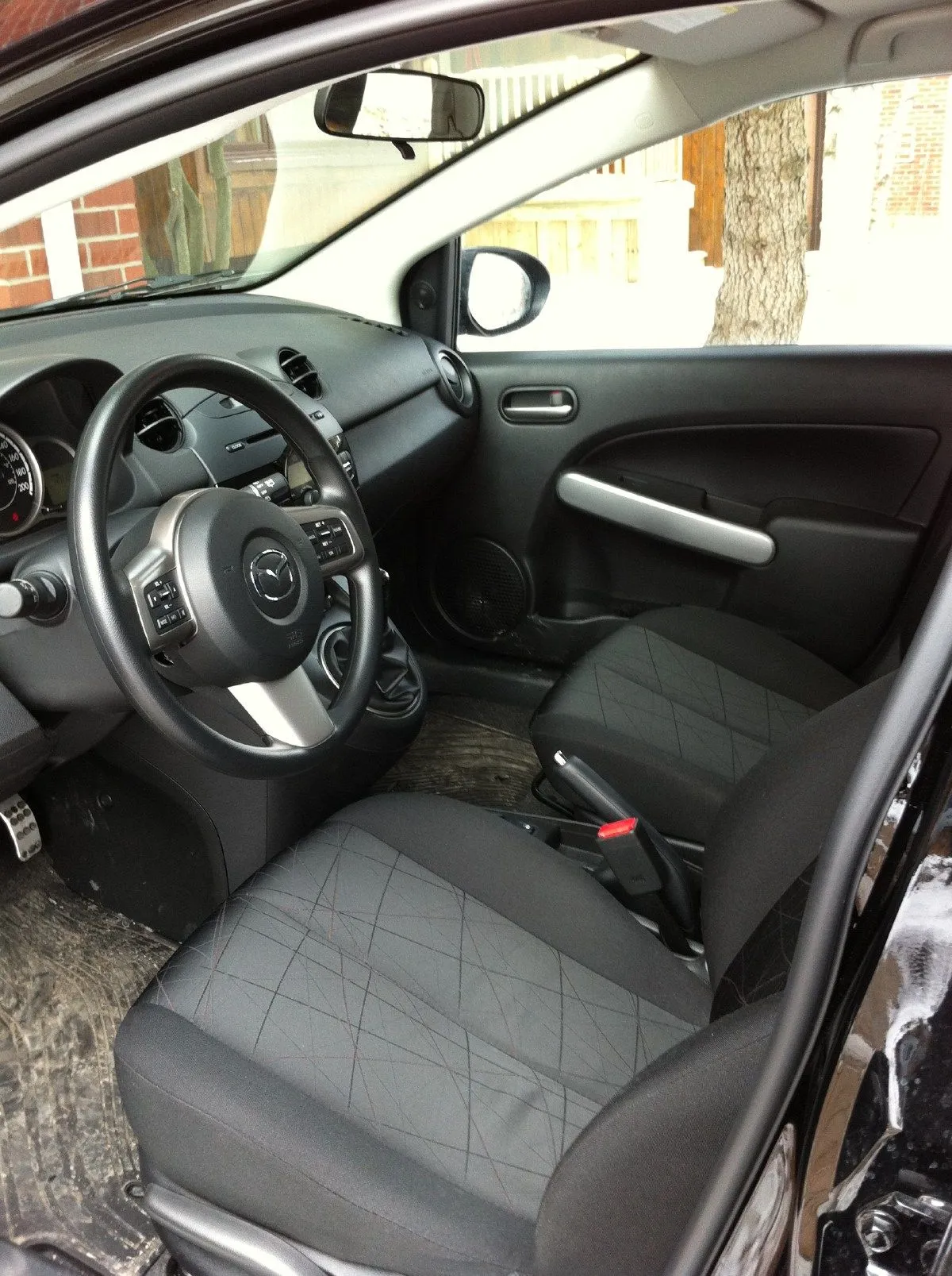

Interior.. Very stealthy
The new amp rack...
