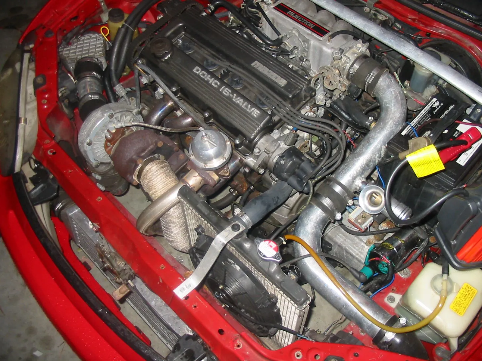

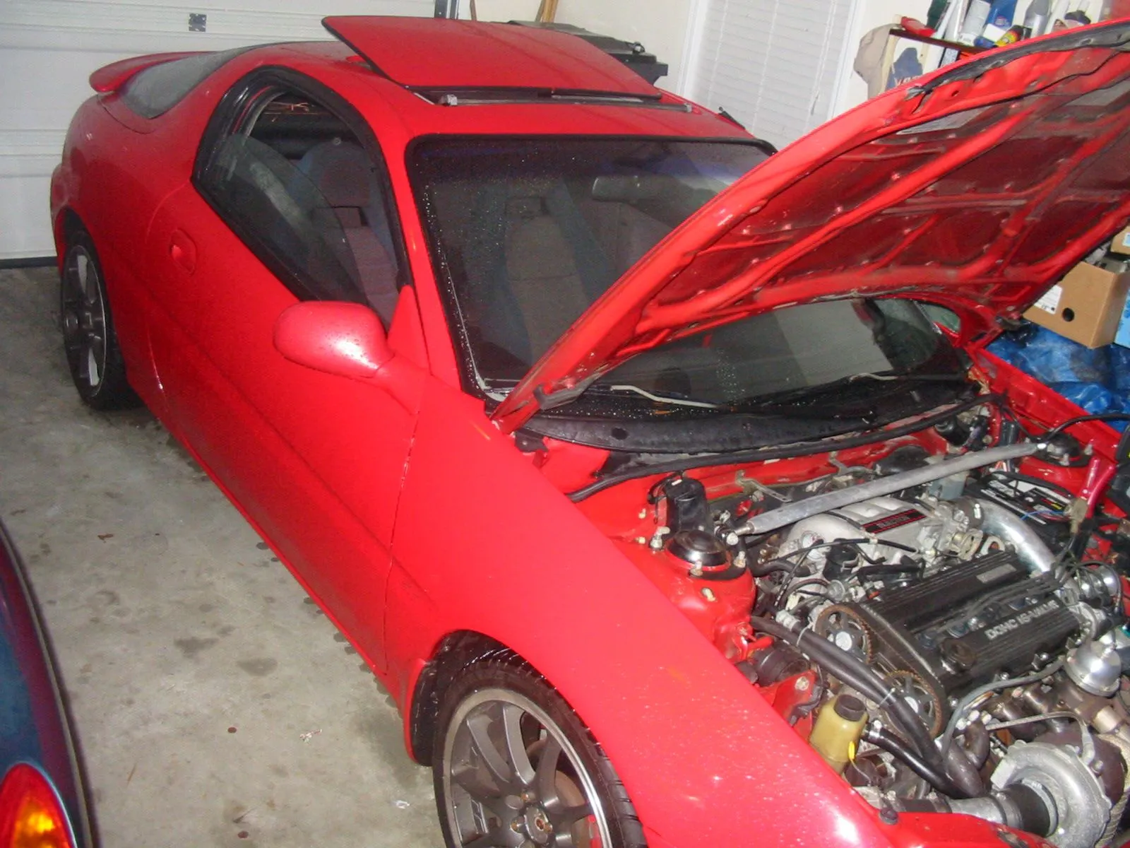

finnally got a new toy. so i can come out and hang wiht the mazda folks again! what u think, it needs some minor work, since its been sitting for about 6 months, but it runs, just needs fuel management... so i got to go easy on it.. until than...(glare) if u cant tell its a 93 mazda mx3, gs was a v6, but he swapped it out for the bp, so it has all the extras of a gs including sunroof :), t3/t4, 3"exh/8:7:1wisecos/miata turbo mani. a bunch of extras.. when i got it it had the 320cc injectors in it, and ran really bad off boost b/c the afc was stolen out of it so it was jsut dumping fuel constantly, so i put the stockers back in it, to make it driveable, until i get a fpr, or another afc.

thanx, the body and motor and everything is perfect, theres no real major problems with it. just needs to be finished up.
Upgrade the radiator,
manifold has a small crack by the wastegate
clutch upgrade
thats really it.. .. i want to change the wheels everything else im happy with.

yea the pics suck, but its raining like crazy down here.. hopefully it stops tommorrow so i can wash it. But yea i drove it home with the 320cc in jectors and was able to boost it alittle (7lbs) and it felt great!!! but like i said before it ran like ass off boost...im in love already tho, i just have to get used to a small car again im 6'4...lol
What are the stock injectors on the BP, less than 320? I just had my injectors flowtested and they were at 324.. in my Protege5
i hear they are 220 or 230..
ive been wanting to wash the car soo bad.. but i havent had anytime. im taking of tommorrow so i can wash it..lol, but i swapped out the injectors, and it runs normal, but the ignition is just old and needs replacing, its corroded really bad from sitting, the coil pack plugs/wires everything. And one of the injectors is leaking thruthe gasket.. But after driving it today, i realized that this car would not make a daily..lol i got home and my back was hurting..the svt feels like a bentley when i drove it..hahaha
looks realllllllllllllllllllllllllllllllly good man, you gonna be able to come out to the bowling alley this thursday and let us take a look?

damn, that looks REALLY good! Just 1 question: is it just me, or do only 3 exhaust runners go into the turbo? What's with rogue number 4?
wow, nice. I agree I would change rims, but otherwise its wicked. I especially like the engine choice, those engines are awesome. Is it a BPT or a BP with aftermarket turbo? and what turbo out of curiosity
thats the wastegate dump, the manifold isnt realyl the best, since the wastegate is only on 1 runner... it would be alot better if it was on the collector. The turbo is a t3/t4..
