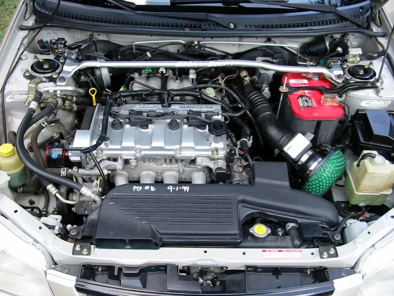

It's odd how the mounts didn't line up for you. Everything on mine was a quick and easy swap. Did your engine come out of a wrecked MSP?
negatize,
your swap was the n/a 2.0. my swap is the mazdaspeed turbo 2.0. The turbo system obviously needs an intercooler. I wrote in my original blurb that I was holding off on the front mounted intercooler for now, but will be getting the hiboost FMIC fairly soon. However, until I can, the turbo system needs an IC nonetheless and the only one I have is the stock SMIC piece of crap. While it's not ideal, it's what I have to use for the time being.
All 3rd gen proteges that are n/a (99-03 and p5) have radiators that span the entire distance between the headlights. The radiator fans that sit behind the radiator span the same distance (obviously). Mazda designed the mazdaspeed radiator much less wide to make room for the SMIC that sits directly next to the radiator. To compensate for the decreased surface area, mazdaspeed designed their radiator thicker (by about a half inch) and about an inch taller. This increase in height by one inch is the reason that the 1999 (n/a) radiator brackets could not be used. The 99 (n/a) brackets are bi-level in that the part that braces the radiator is down below the frame. Due to the mazdaspeed radiator being an inch higher, it sits flush with the frame. So, because of this, you cannot use a bi-level bracket on two mounting locations that are flush with one another.
You didn't run into a lot of the turbo, ECU, cooling system, exhaust? and possibly a lot of other problems because you weren't swapping in a mazdaspeed front end clip. You might have even been fortunate enough to have disk rear brakes and not drum rears like me. Becuase I have drum rears, I have 4 lug hubs/spindles. The mazdaspeed has 5 lug hubs/spindles, so the conversion had to be done, or else I'd have 5 lug hubs up front and 4 in the rear haha.
We did this by pulling off the 1999 spindles (with the hub assemblies) on their lower suspension arm and putting them on the mazdaspeed sub-frame (it's much easier than getting the hub out because they are machine pressed into place, or trying to remove the spindles from the ball joints that hold them to the lower suspension arms). If you've ever tried to remove a ball joint you'll definately know why I side-stepped that at all costs.
The axles had to be fabricated because the mazdapseed axle splines obviously fitted the msp tranny on the tranny side, but the splines didn't match up to the splining within the 1999 ES hubs. My 1999 axles would spline fit (obviously) into the 1999 ES hubs, but the splines would not fit in the msp tranny. So, we fabricated axles-- it's much easier than trying to fabricate new hubs.
Yes, my clip came out of a wrecked MSP, but it was wrecked in the passenger side-rear so the front end was untouched. However, All I had was what I listed in my original writeup. Unfortunately I don't have a donor car which would have made this project quite a bit easier.
