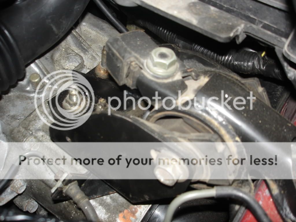

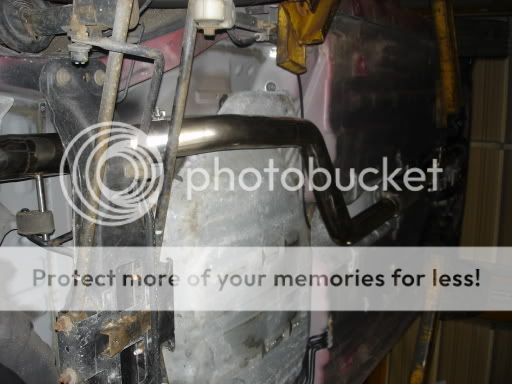

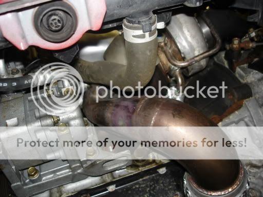

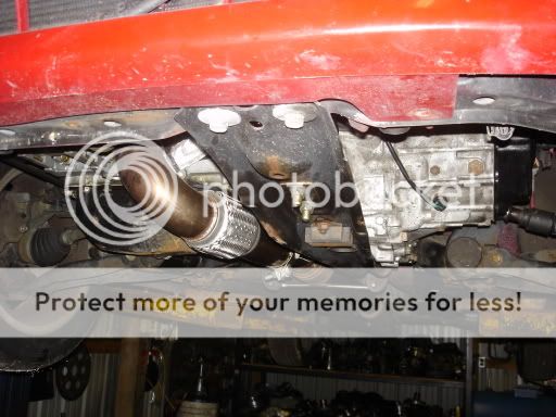

To address the fuel system discrepancies, the mazdaspeed protege fuel tank was ordered (with the msp internal pump) and the fuel lines. The msp fuel tank however, was slightly different in it's design, so the 1.8 fuel tank was used and the msp fuel pumps and lines swapped in to keep it as clean as possible. To address the exhaust system differences, I ordered and dropped in the GHL full 3'' turboback exhaust. After installation, the downpipe was found to be touching the oil pan, so it had to be heated with a blowtorch and coaxed off the oil pan (no kinks or creases were made). The spindle and hub assembly conversion was an absolute nightmare. Unfortunately the 99 ES came from the factory with drum rears and thus 4 bolt hubs. What we finally decided to do was remove the 99 spindles and hub assemblies were from the 99 subframe (still on their lower suspension arms) and re-mount them to the MSP subframe. This allowed me to keep the 4 bolt hubs up front-- otherwise it would have been 5 up front and 4 in the rear. The splining on the driver side axle was giving us considerable difficulty, so we ended up fabricating and splining an entire new axle for it. Side motor mounts also had to be fabricated from scratch because the bolt pattern on the MSP side mounts differ from the bolt pattern on the 99 frame.

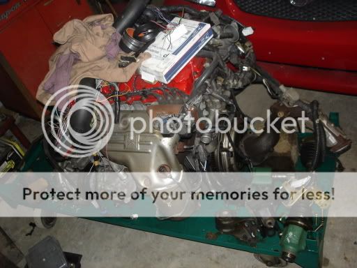

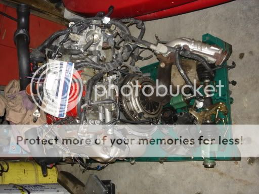

Here are the pictures and vids that were taken tonight. (Note: the whining noise on the first startup is the power steering pump-- that will be fixed tomorrow. The SMIC or the intake have not been installed yet so esentially right now it's n/a until they are. The pictures of the engine and tranny on the come-along are what was taken out.)

The Old Setup
Another Shot of the Old Setup
The GHL Downpipes and Exhaust System

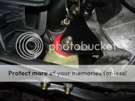

One of the Fabricated Side Motormounts

The side motormounts were not matching up to the frame. It was either drill into the frame or fabricate a new mount. I decided to fabricate a mount to keep it cleaner. The splines on the driver side msp axle were not fitting properly into the hub assembly of the 99 spindle-- perhaps the splines were damaged somehow. So, a new axle was fabricated and splined-- not a huge deal since the machine shop is right next door.
I have no brackets for the radiator or the side mount-- therefore they had to be fabricated as well.
