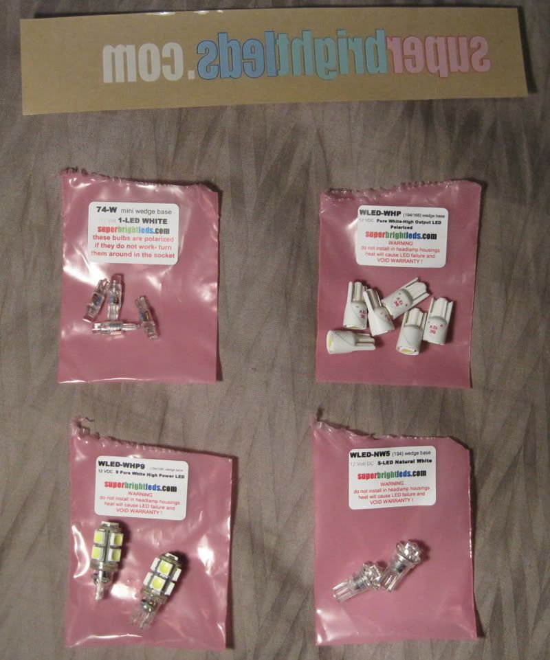

The shipment (sticker added between 10-15 whp):

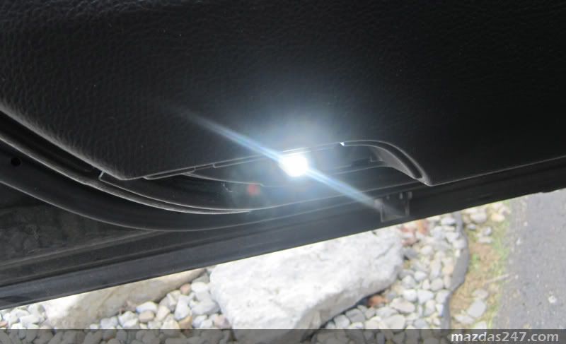

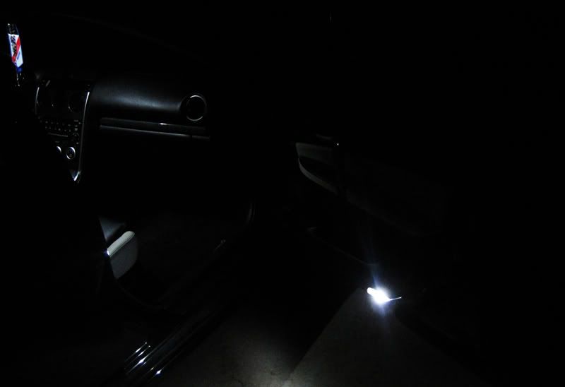

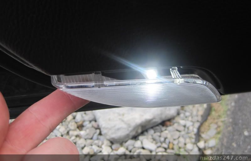

Front door lights (WLED-WHP):

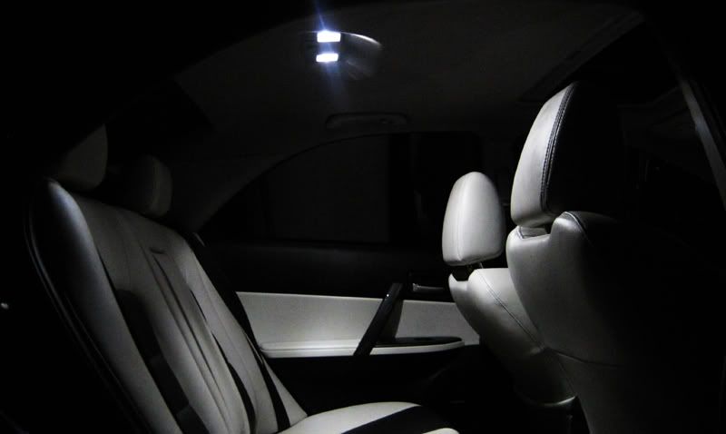

Rear dome lights (WLED-WHP):

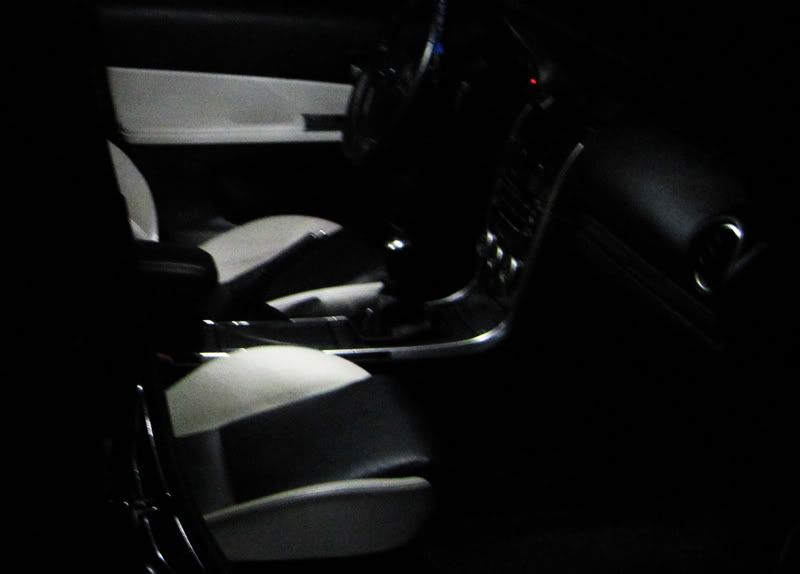

Front dome lights (WLED-WHP):

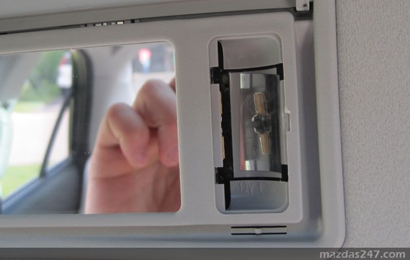

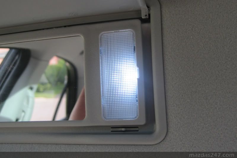

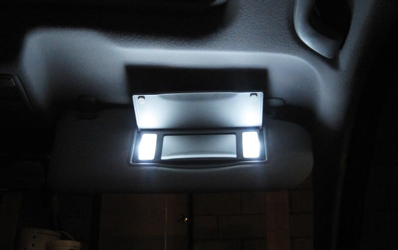

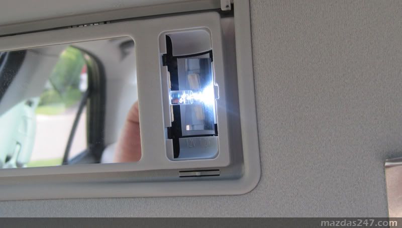

Vanity mirror lights (74-W):
Rear license plate lights (WLED-NW5):

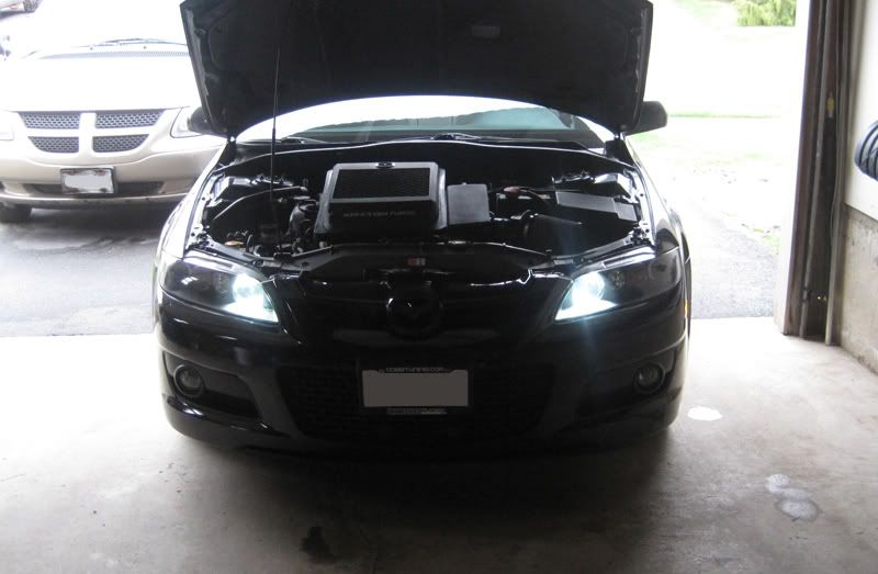

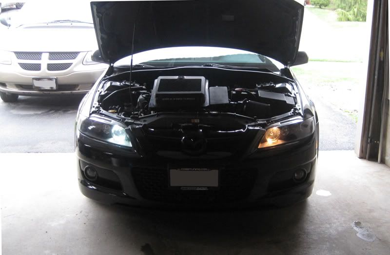

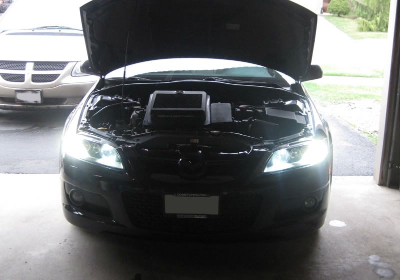

Parking light (comparison with stock lighting on the drivers side):
Both Tower II's (WLED-WHP9):
With stock HID's:

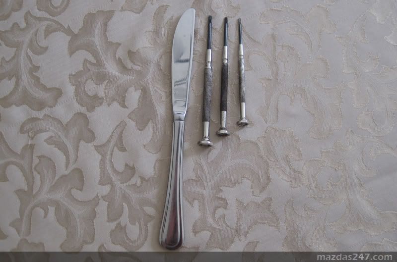

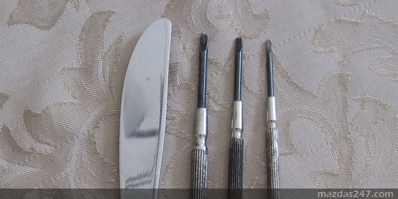

Tools used:

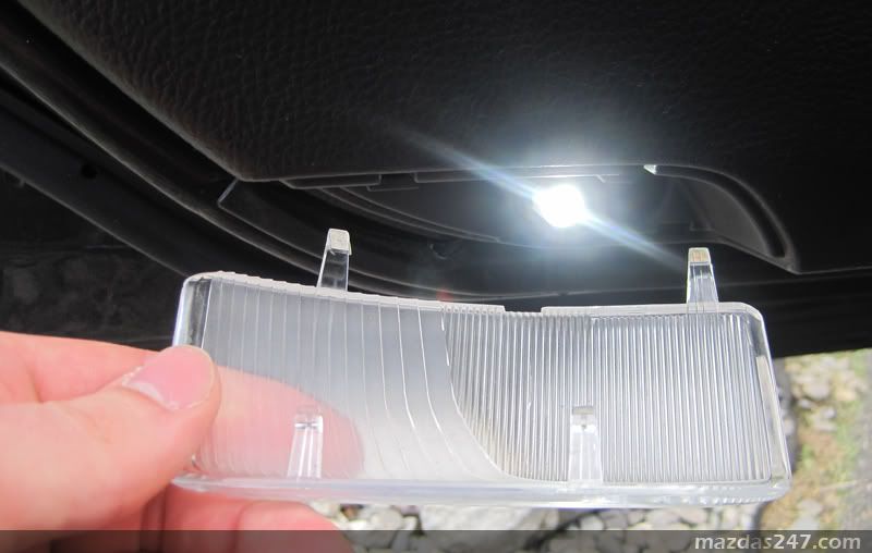

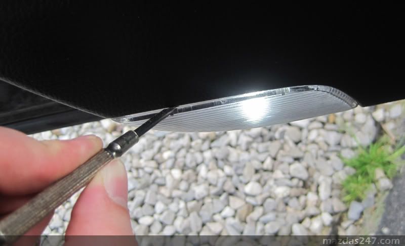

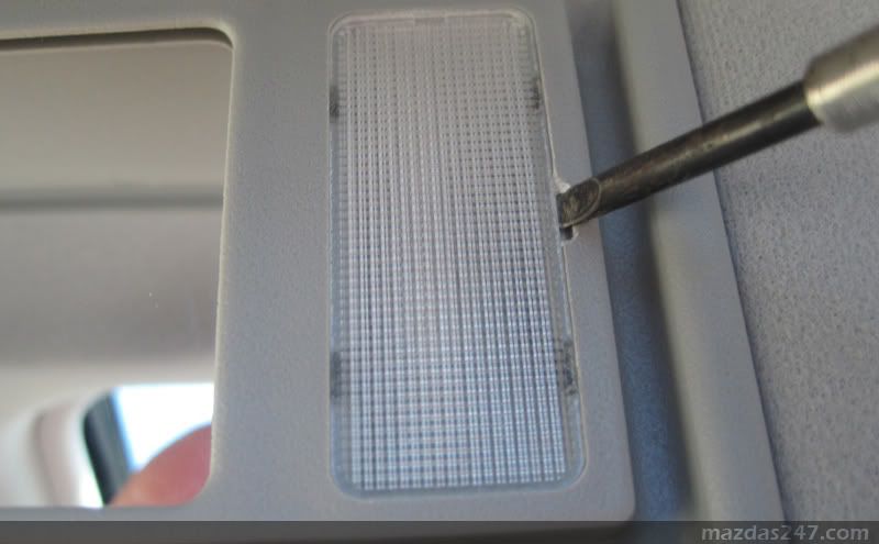

Vanity mirror:

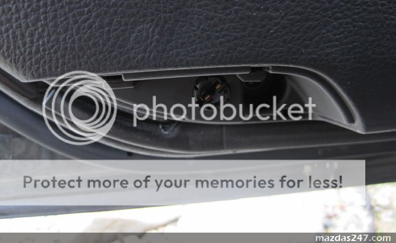

Door lights:
Rear dome lights and license plate lights were all just clips. The front dome light had 2 screws in the sun glasses spot and clips. Again just unscrew the bulb and put in the replacement one. Most of the bulbs just came out by pulling them, dome lights just needed to be twisted. Pics will be coming soon.
For the parking light, the back of the housing had to come off (clips) and then you could just pull out the parking light housing and swap the bulb. This bulb was a VERY tight fit, I advise caution when swapping this bulb.
In my case, all the bulbs were wedge based and if they don't work the first time then just turn them around to get the correct + and - side.

You should really do the vanity mirror lights, those were the easiest ones to swap IMO, makes a good difference when it's dark and you need a mirror.

The vanity mirror lights just popped off. I used this tiny flathead looking screwdriver, probably about 3 or 4mm long and less then 1 mm wide.
Might be a dumb question, but what went where? I assume the towers went in the parking lights and the WLED-NW5's went into the license plate? What about the others?
Thanks
74's are vanity lights and WHP is everywhere else. I also added a 74 to my trunk and ash tray and took the little red plastic piece out of the ash tray as well.

Isn't it so much cleaner and sharper inside now? You did pretty much exactly the way I would do it if I were to start from scratch again. I like the TowerII in the parking lights because it lights up the whole reflector in the housing, and I found the WHP to be more a "point source" there, and not as visible for oncoming traffic. The glovebox is easy, you just need to unhook the door so you can get in underneath, same as changing the cabin air filter.

That looks pretty sick. I might have to look into doing this myself. I always liked the parking lights to be a big yellow though. I want to find some yellow led's or something close to it. Makes it stand out a little more and the yellow with a blueish HID would look SICK. Nice right up, appreciate it :)
Anyone have any trouble getting the tower II into drl lights? mine wouldn't go had to put them in the step lights on the doors
Shurik, I think you can get the TowerII in amber as well. (yep... Autolumination does have it in amber, or it is called the WHP9 at Superbright)
Drover, I didn't have any problems, just be gentle with them and maybe wiggle a little bit? I have heard that the TowerIII is too long to fit though.

SHURIK, like OJ said you can get this bulb in a variety of colours, I think Qwik6 put in amber but took them out? I'm not 100% sure but I know he took pics.
Drover I did have a bit of trouble putting them in. Yes, they are wide but I just had to wiggle and turn them to get them in the housing. VERY tight fit, like said, I advise caution so you don't push the bulb in too far or brake something with too much force.
All in all, such a sharp look. I have the advanced key entry and I set the dome lights to "door" so whenever I walk up to my car and press the small button on the handle the whole interior lights up with this nice white... Looks killer with the white and black leather:D.
