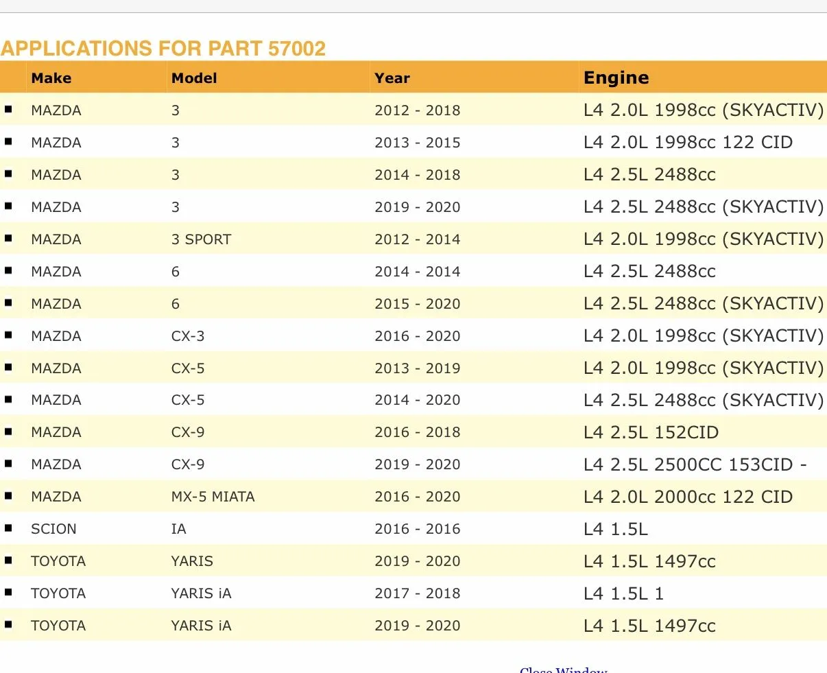

Your 2.5T uses different oil filter, 1WPE-14-302, from 2.5L, PE01-14-302A、PE01-14-302B、1WPE-14-302、or PE01-14-302A-MV.
Wix 57002 is compatible with PE01-14-302A, not 1WPE-14-302.

I honestly really doubt that it matters to be honest. If it does matter, the engine is covered for another 125K miles, and they have a loaner for the downtime...
That said, WIX does indeed list the 57002 as compatible with my vehicle, which uses the same filter as the 2016-2020 CX9.
https://www.wixfilters.com/Lookup/PartApplications.aspx?Part=57002

You know very well that aftermarket parts often are one-size-fit-all. Unlike others, Wix has stepped up and designed 57002 to meet the specification from Mazdas PE01-14-302A for SkyActiv-G 2.0L and 2.5L. They could have specified older 51358 / 51365 filters, which are for older Mazda 4-cylinders, for SkyActiv-Gs like other aftermarket oil filters. Now Mazda has designed another 1WPE-14-302 oil filter for its SkyActiv-G 2.5T when it first came out on gen-2 2016 CX-9. Theres a reason why Mazda wants to use a different oil filter on 2.5T, but we can only know the 1WPE-14-302 filter has to be different spec-wise from PE01-14-302A. But aftermarket oil filters dont really care, as long as it fits, and offers filtering function.
By looking at applications of Wix 57002 from your link, it only says for 2014-2020 L4 2.5L 2488cc (SKYACTIV), which doesnt list a separate line for 2019 CX-5 with 2.5T. Further for the CX-9, it lists 2016-2018 L4 2.5L 152CID and 2019-2020 L4 2.5L 2500CC 153CID - in 2 separate lines. When did Mazda modify the displacement of SA-G 2.5T for 2019 and up? And it doesnt list a separate line for 2019 CX-5 2.5T?
In other words, this application chart is not accurate. It tried to use older 57002 used on 2.5L to cover a different oil filter for 2.5T to save extra development cost. Heres a warning from MNAO that OEM oil filter used on older Mazda 4-cylinders cantt be used on SkyActiv-G 4-cylinders although it fits. Many aftermarket oil filters would claim their one-size oil filter fits ALL Mazda 4-cylinders from older Mazda2、Mazda3、Mazda6, to newer SkyActiv-G 4-cylinders including 2.5T turbo!
