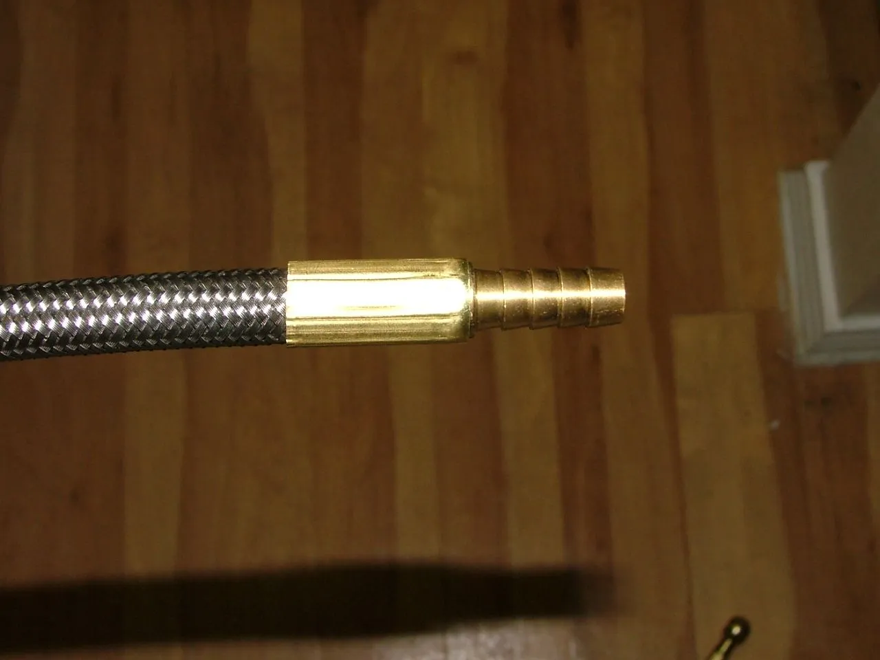

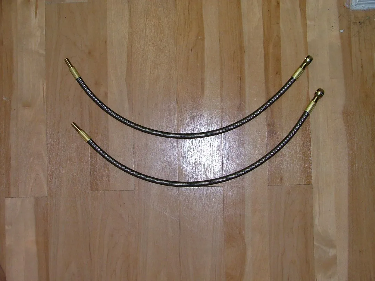

Here are my new Hi-Temp Teflon Steel-Braided Lines. The lines are 3/8 inside diameter (ID). I ordered the Banjo Barbs from ATPTURBO (Banjo Fittings), and then went to Hose-Fast in Garland to have them make the lines by crimping in the barbs. The lines were $8 per foot. They also crimped some 3/8 in hose barbs at the ends so that I could connect rubber hoses to them, far away from the heat of the manifold. Hi-Temp teflon is overkill, but I still remember having to replace rubber lines on my old turbo kit periodically when they couldn't take the heat. Remember, the barbs have to be crimped on, if you don't want any leaks. You should be able to go to any hydraulic hose shop to get this done:
