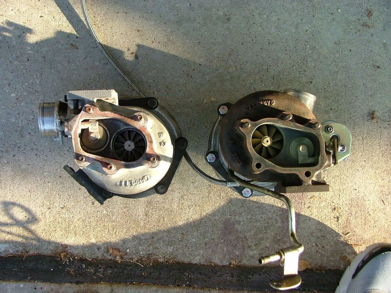

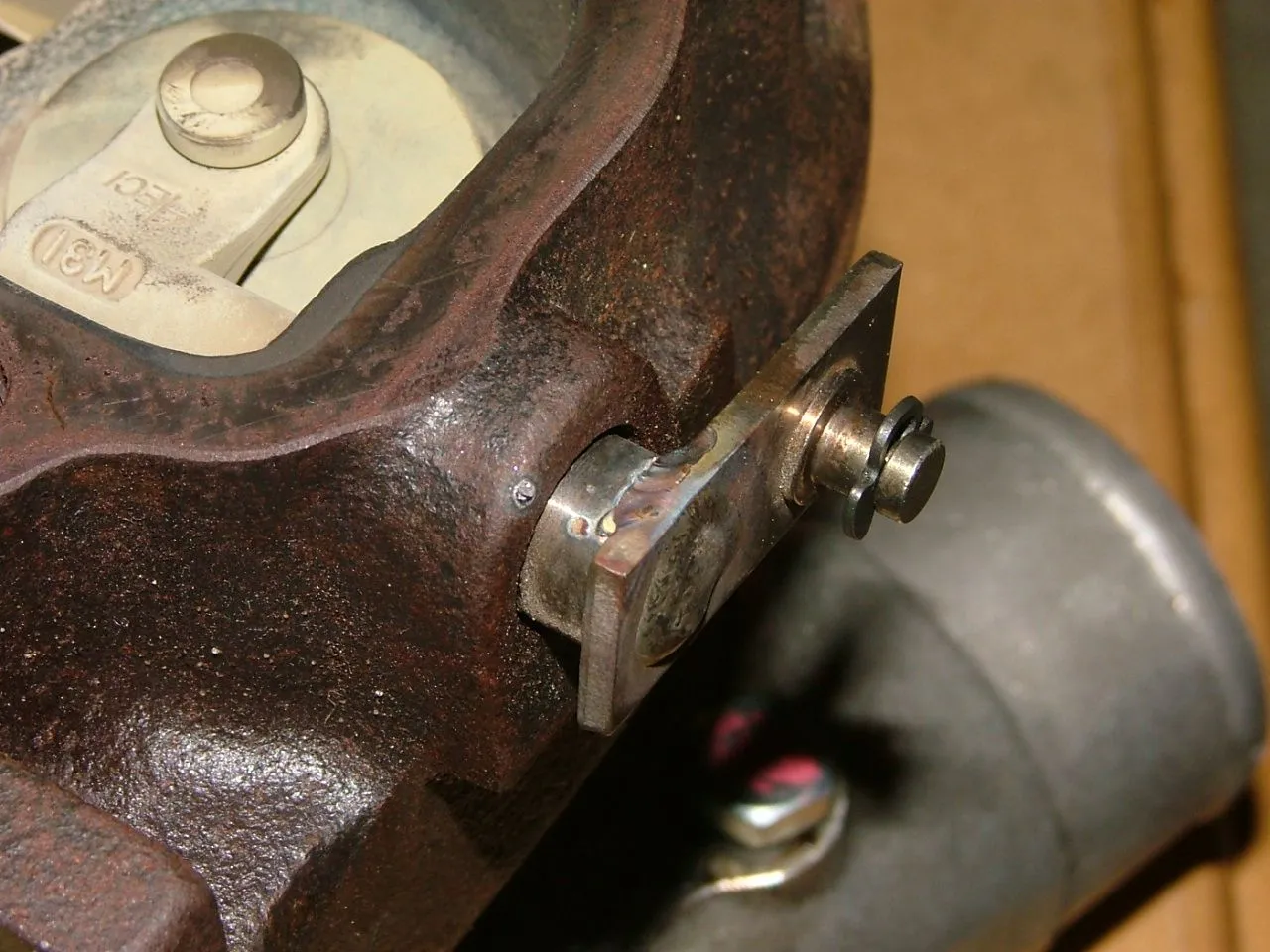

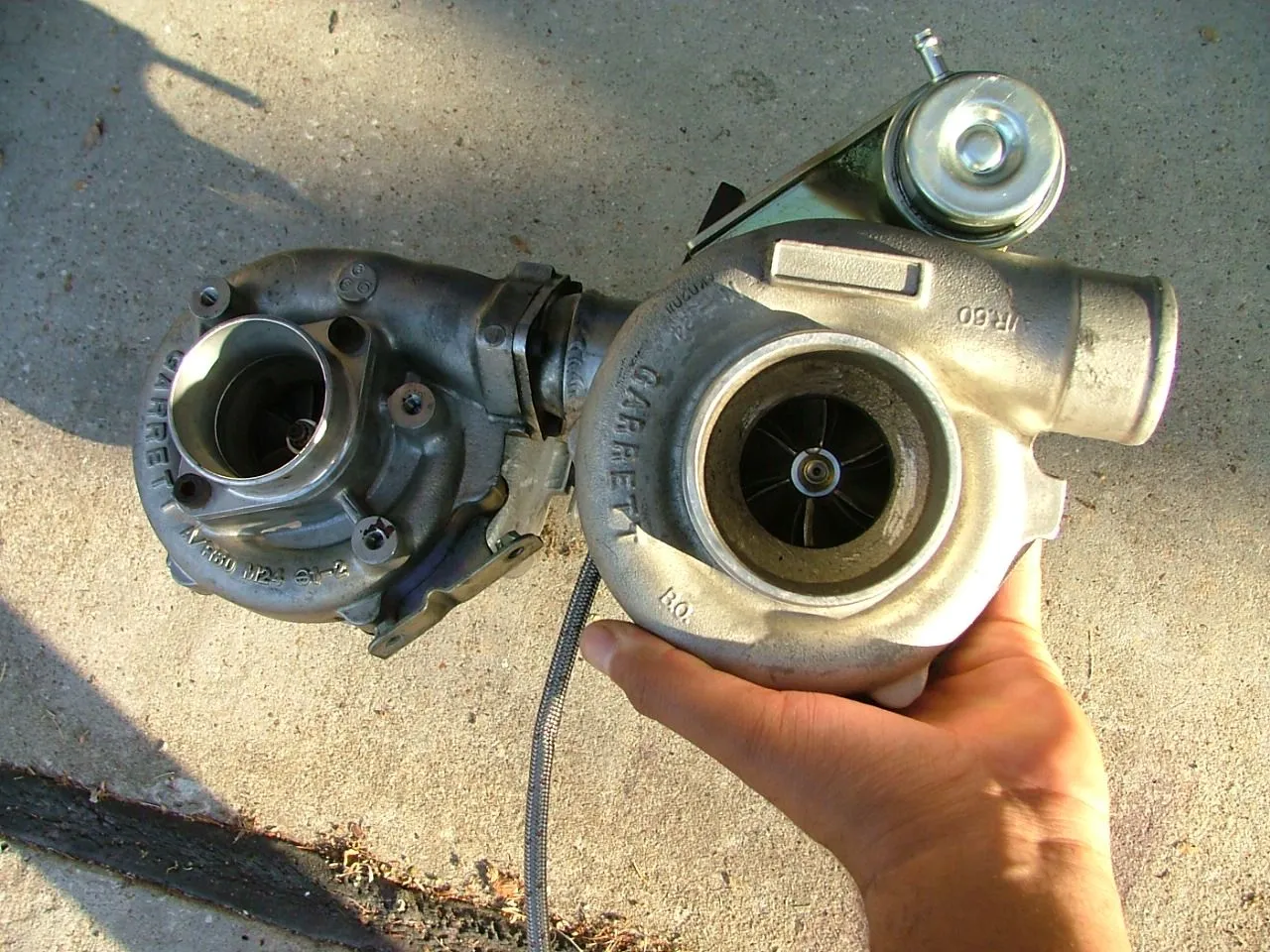

Well, I took the GT28R turbo out today, and dropped the manifold off tonight to have it repaired. While I was there, I took off the internal wastegate (on the new GT28RS), and had the flapper shaft welded so that the the internal wastegate flap doesn't open anymore.
Pictures below of my old GT28R on the left vs. the GT28RS. I also know why my bearings failed. Oil got cooked!! Today's lesson = if you have a turbo with provisions for water lines, hook them up!!:
