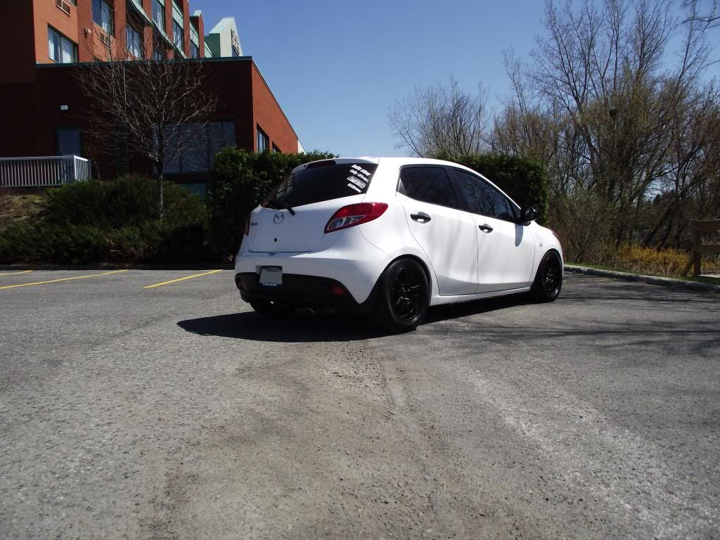

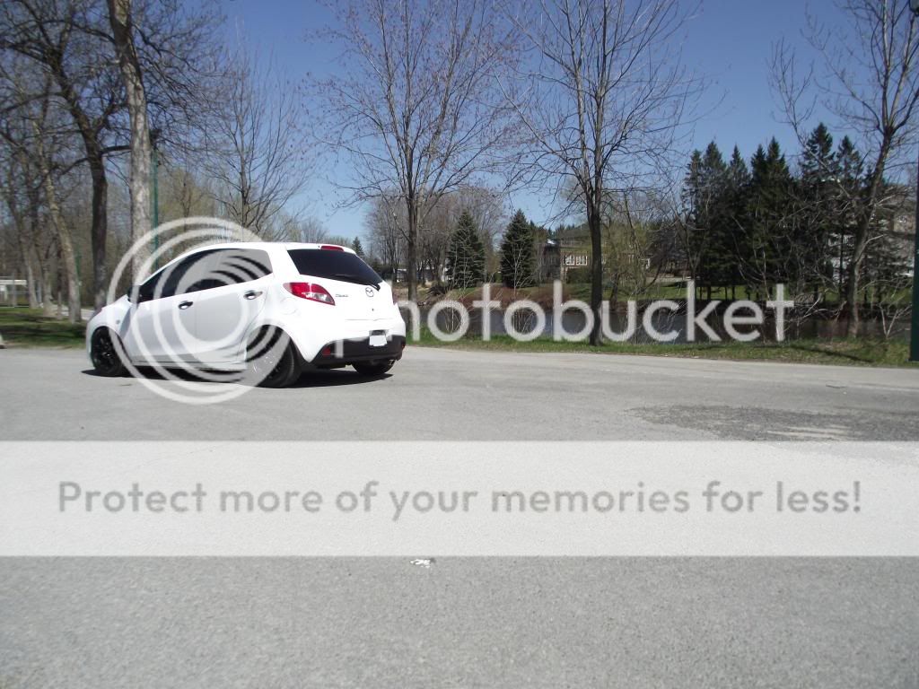

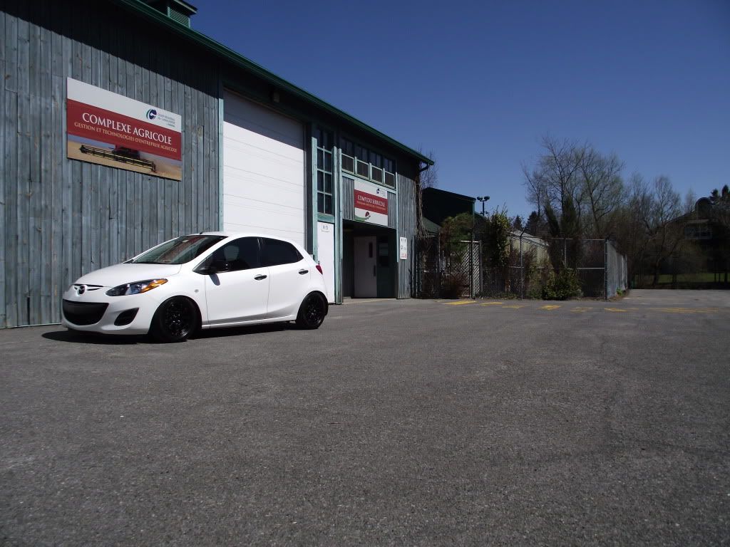

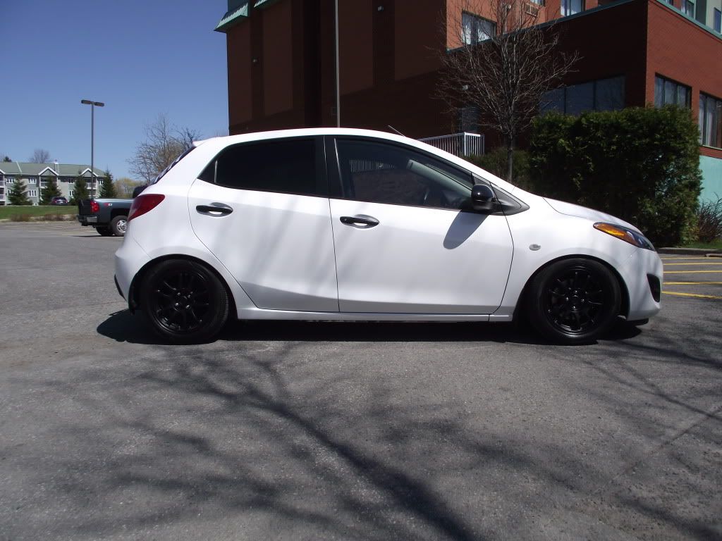

So enough blabla and here's the fast facts: Last year I focused exclusively at protection: A full TechTeinte protection film kit, OEM mudguards set, Weathertech floor mats set, TechTeinte UV-resistant window tint and full quality rustproofing. Finally I added the OEM shorty antenna to eliminate that RC car look and pick the optional stainless exhaust tip for somewhat try to hide the ugly OEM muffler. This year I did a bit more: Corksport short ram intake, Corksport front strut-bar, Corksport 19mm rear torsion bar, Ksport Kontrol Pro coilovers and TRMotorsports C1M 15X7 +30 black Spec-Miata wheels. Not shown on those pics are the Volk Duralumin lug nuts in black.

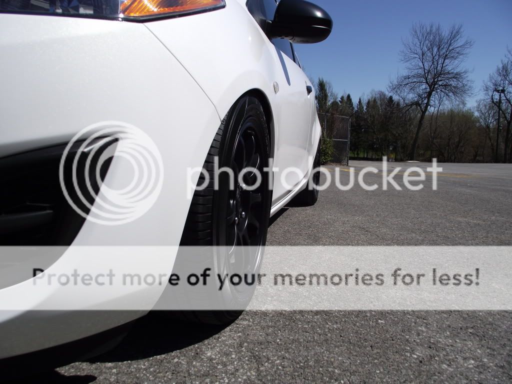

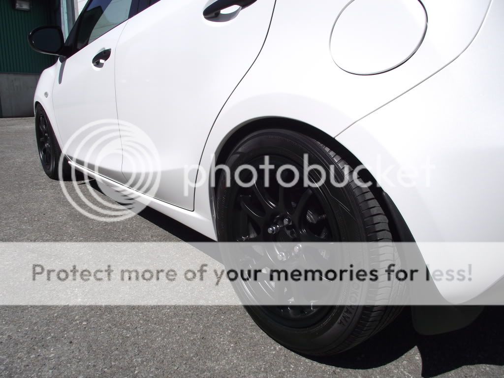

So far the Ksport coilovers are more than a surprise. I know those have a bad rep from their early year, but I heard that they have improved since the last year, now sporting better components and most of all better shock valving, along with ISO and TUV approbations. So far I can tell that the exterior quality is on-par with the most expensive coilovers here and the damping is well matched, although not as refined as my previous KW V3's on my NC1, but those cost me twice as much and did'nt came with pillow-balls... Note that the front can go a good inch lower without affecting travel but comprising lower arm geometry. I'm almost parallel with the ground at that height. Rear I removed the locking collar to gain a little of drop. This is as low as they go at the rear. No bumpstop riding so far and I tested them on our harsh Qubec road hard enough. This is a perfect blen of track-capable spring rates with enough softness for daily commuting. 5/3 seems to be the perfect ratio for a dual setup like mine. The only complaint I have is no front camber adjustability from the pillow-ball top-plates. I'm currently talking with AAC for custom camber-plates Please contact nk2a to share your interest! Font Motorsport gave me an outstanding service on those, along with an excellent price and great transaction!
The Corksport stuff all work as advertised, as always. The short ram sharpen the throttle response and emit quite a bark, the front strut-bar is effective although hard to install (for a strut-bar) and the rear torsion bar is dead simple to install and most of all liven up off-throttle rotation. A JDM Demio badge finish off the Corksport orders.
The TRMotorsports C1M wheels are the Spec-Miata wheels for all 90-05 NA/NB's. They are relatively light, solid, available and must of all dirt cheap through Tire Rack. The 15X7 +30 WILL RUB IN FRONT AT MY SLAMMED HEIGHT ON OEM SIZE-TIRES. It strongly recommend the aformentioned custom AAC camber-plates or at least SPC cam-bolts. I will buy camber-plates to run 205/50 DOT R-Comp next year. Fitment is flush in front and a about 5-8mm is available at the rear through my untouched fenders.
All my protection stuff is working great: After one winter, no rust, virtually no paint chips and no salty floor mat.
Thanks to the love of my life Nath, my long-time friend Louis, my too intense little 'brother' Chris for all the help, understanding and support since last year. Special props to this forum for supporting Mazdas! Please cry here.
Enough blabla and those are the pics (sorry for the lack of definition of my wheels, i'm no pro photograph):
All comments are welcomed!
