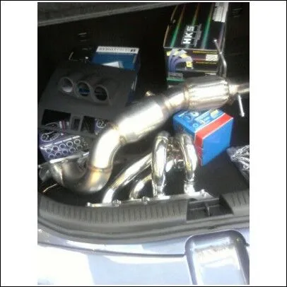

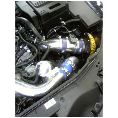

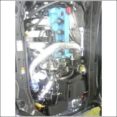

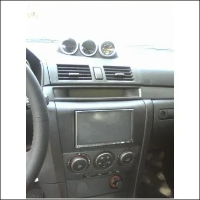

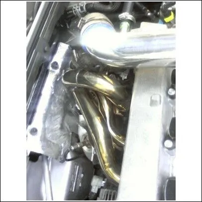

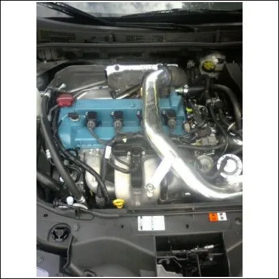

well i dont think there could be anything more to put in the car and if i could do it all over agin i am not sure i would. some of these things were a pain in the butt. but here once more is the compelet list of everything i got in there
turbo xs fmic ( horrable company )
twm ss
street unit mm
hks intake
pg manifold
pro sport boost / oil press
aem a/f
hks bov
custom dash pod
indash 6.5 dvd /cd player
sub box in the jack slot 8" kicker sub
dash hawk
ngk plug
cpe down-mid pipes with high flow cat
i have dyno time next week were i will have it tunned so i think everything is in good order. the car spools up slower now but when it dose..... yup
i only have one qustion for the a/f i have seen as high as 15.7 - 16 and low as 11.1 what is the safe zone?

safe zone is still being decided for the car. Because of the DI and lack on tuning equipment no one has been able to really get some good tunes for these cars. Lead everyone out of the dark and post up all the info you can

Well, ideal A/F ratio is going to depend on alot of things, but if the motor was under load and receiving boost, 15's is way too lean.* If you were part throttle or cruising, 15's is about right.* Then again, if you were cruising, the car should be running in closed loop mode and the ECU constantly adjusts A/F ratio for best economy.* Under load, I would say something between 11-12.5, 12.5 bordering on the slightly lean side for WOT.
that sounds about right 15 is usally cruising and 10-12 on wot i just wonted to know after modding that much i never knew what it was before hand
