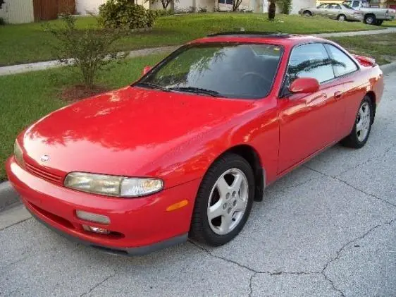

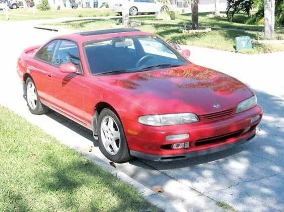

This is my new project car its still stock for the moment
