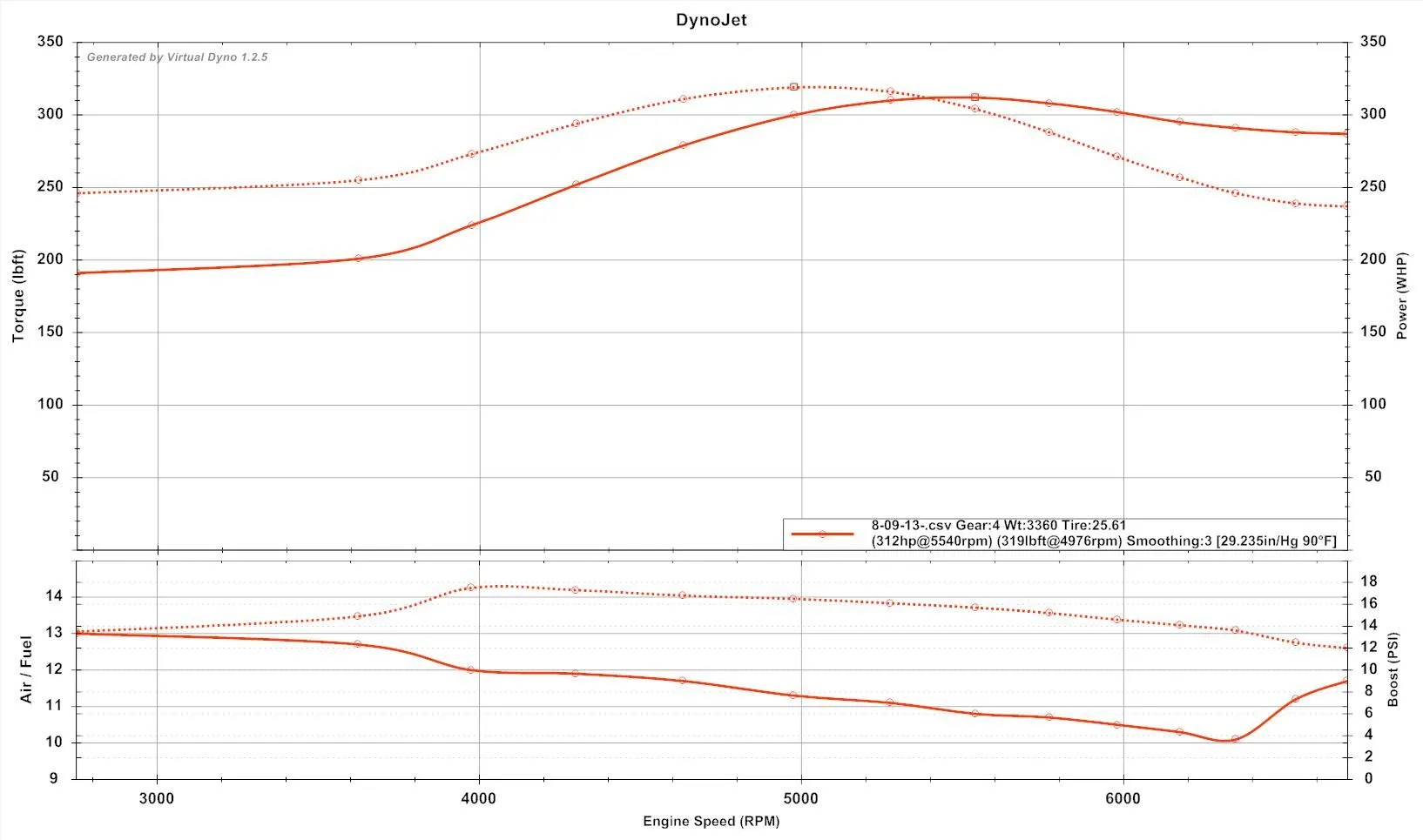

I'm attaching a couple Virtual Dyno charts to illustrate my point. Virtual Dyno is widely employed by custom tuners over on the MSF board and has been found to very closely correlate to DynoJet when using a 1.01 or 1.02 correction factor and accurate SAE data. I'm getting between 295 and 310 whp with Hypertech tuning and my mods.

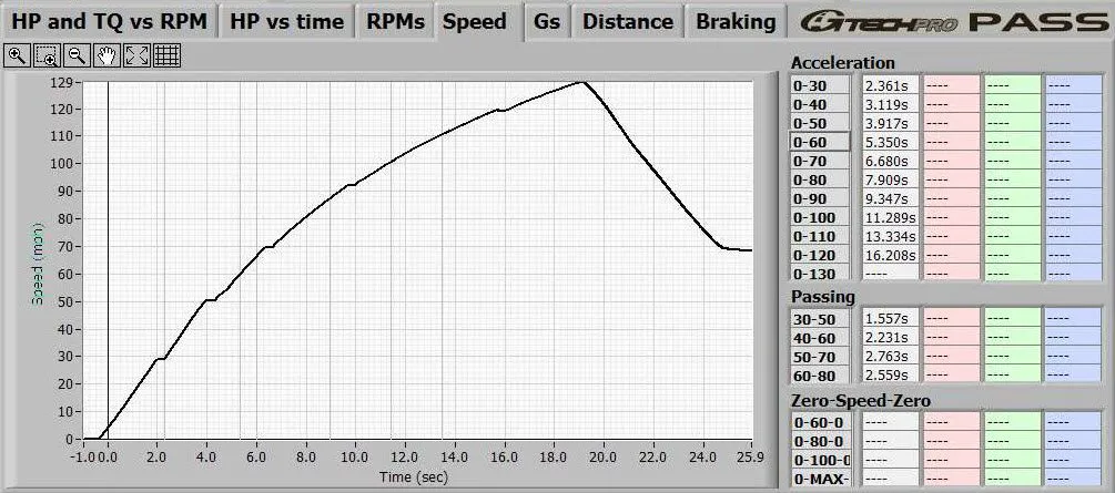

Another way to accurately make performance comparisons with your tune is to compare the time column on your datalog or use a stopwatch doing a WOT pull in 4th gear from 60-100 mph. Stock is typically about 8.4 seconds or so. My times are 5.8 to 6.1 seconds, depending on ambient conditions. That's serious power gain. I've attached a G-Tech Pro accelerometer chart showing a run to almost 130 (let up a fraction of a second too soon), to show what this tune and mods can do. Draw your own conclusions.
I'm sorry your experience has not been like mine. I wonder if you might download Virtual Dyno (its freeware), and run your datalogs through it and let's compare. Here are some data logging charts to ponder:

Do you have any way to datalog? A csv log on a 4th gear WOT from 3k rpm to redline could be run through Virtual Dyno. Or you could do a timed run in 4th WOT 60-100 mph could also be used to make a reasonable estimate. Without more to go on I'm only guessing: 275 whp, 290 torque.

Another way to assess performance is stopwatch timing in third gear. That is safer from a ticket perspective. Make timed runs from 50 to 75 mph. See if you can break 3.0 seconds. Go WOT at 40 mph so that you have full boost at 50 when you start the timer. I'm doing it in about 2.7-2.8.
