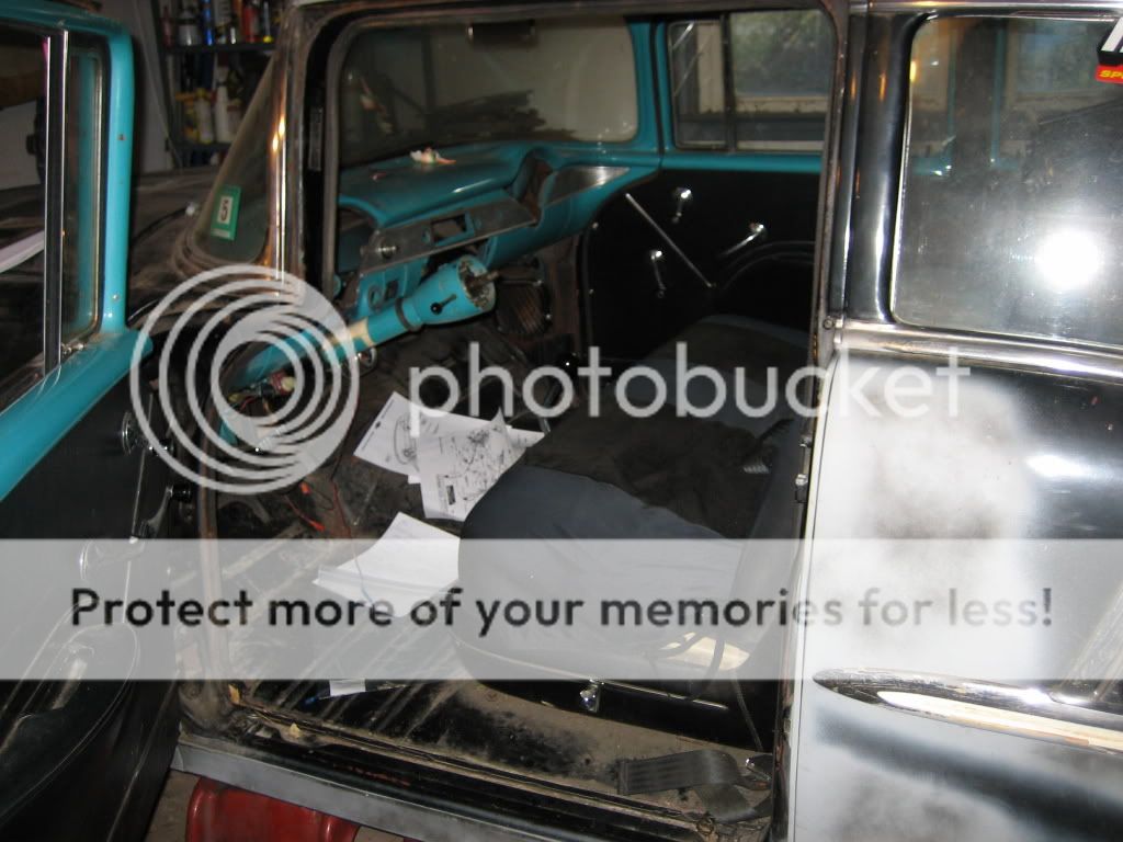

To get at the clock, though, I had to remove that gigantic vacuum tube speaker and AM radio, both of which aren't going back in any time soon because they're heavy and impractical. Light weight=better mileage and acceleration.
All the dash wiring was disconnected at the end of the day, with the firewall forward being taken out next and the wiring kit being put in at the same time.

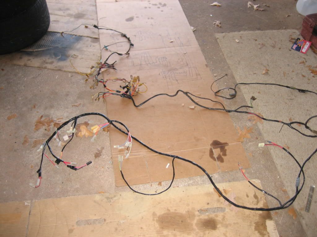

So I've decided that since I have another harness already, instead of spending 500 for a modern harness with a fuse box/circuit breaker/fancy electrical doodads, how hard could it be to build my own?
Here are the two harnesses side by side. New one is closer, old one is further. You can see the age of the old one's connectors. They smell even worse than they look.

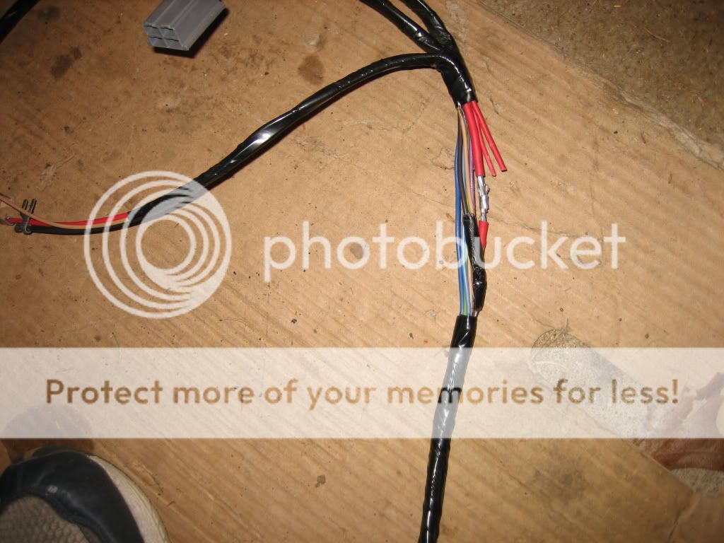

Unlike the old harness where everything was fused at one location, near the generator connections if I remember correctly, this one had two seperate soldering points across the length of the harness. Cut here, it said to me.
And here it is, all cut. The large red wire will be broken off at a later point, at the other fusion point in the harness.
