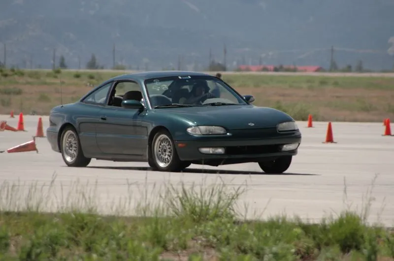

If you search around on here, I have posted some about my son and I running one. Mine is a 93 MX-6 LX. It has been run in GS mostly but he dabled in STX but never put a lot in to it other than springs. I have always enjoyed driving it since it is easy and comfortable.
