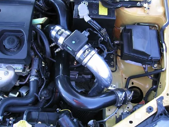

I use to have the whole Injen system and when it gets pretty cold out fuel cut hits at 9 psi. After the FMIC we used the extension part and remounted the bracket. The filter now sits close to the transmission box and I don't even hit fuel cut at 10 - 11 psi. Personally I think it's better to have a SRI if your worried about hitting fuel cut or spark cut... whatever it is during the colder days/nights.
