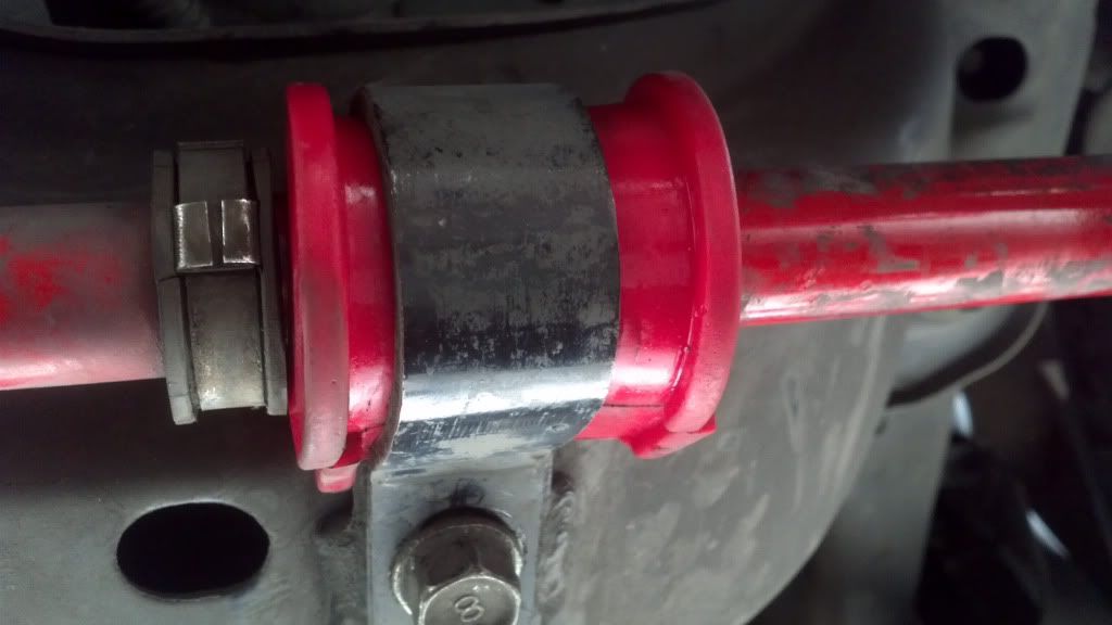

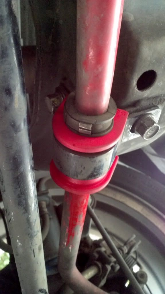

Well i orderd the 7/8 inserts heres some pics i tried useing there clamp but i had to bendit to work but eventualy took it off due to frustration the stock takes some elbow grease to put on but works if you use silicone and some tapping of a mallet..
First drive yea theres a big differnce still supper light clunk but thats prob becuase i only sprayed sili and not grease on the inserts.

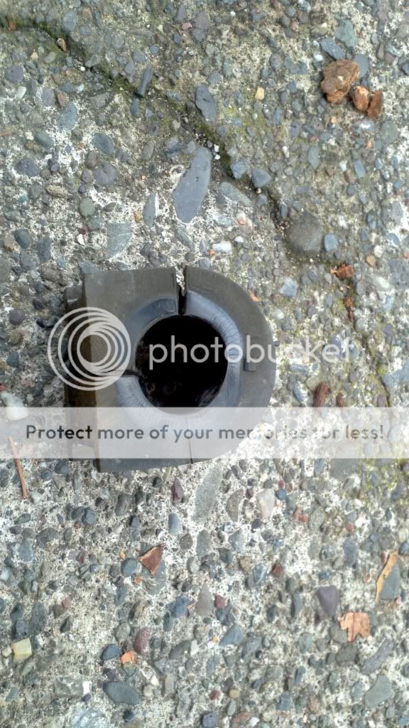

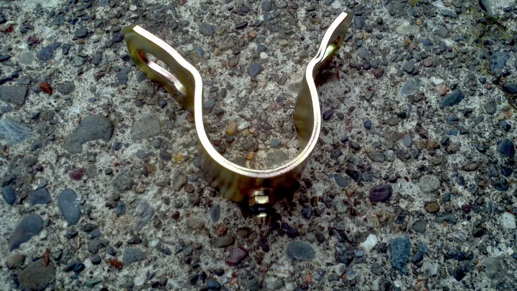

I really should post my solution, but I would have to do a memory swip after I showed you. I heavily modded my sway bar brackets and bushings. I'll post a pic for s**** and giggles after I clean the car out and off today or tomorrow. You"ll never have this problem again and the brackets are greasable. Yes I said it "greasable" while being on the car. I did it after I kept braking the clamps while autoX'ing due to a really tight setted AWR rear bar. Not only did it fix the clunk, it also fixed the snapping issue. I went through 5 brackets in less than 1 year. Now I'm not so worried :)
I totally missed this somehow. It is like this, but the bushings and the clamps are modded. They will not go back to clunking. I've been running this setup for almost 9 months and only greased it twice and no signs of wear, cracking, or flaw "so far". I'll se after another year of autoX.
