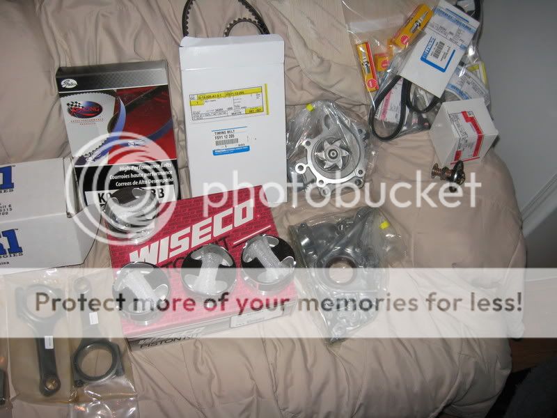

Well my car is almost all put back together so it seems like the time to document the journey she has been on. It started many moons ago in the later half of 2007 when I had my intake mani Jet-Hot coated. Some of the coating clogged the vacuum nipple that I was running my wastegate off of which caused my car to over boost like crazy (almost hit 20 psi the first time I drove it after the mani install which felt amazing till I hit fuel cut..) and I ended up bending a rod before I figured out the problem. I started it up one morning and heard a knocking coming from the engine and had it towed straight to the shop. That was the last time she was running. I never planned on forging my motor but figured I could either, replace the bent rod with another stock one and hope I didn’t bend another one or worse in the future or I could go forged and not worry about bending any more rods. So for most of 2008 I accumulated parts and sometime around the end of the year sent the motor off to the machine shop. I got it back a couple months later and have been putting the girl back together slowly but surely ever since. BIG THANKS to JDM Sam for the rods, pistons, all the other goodies and awesome support! Now for my favorite part of any thread, the pictures!!

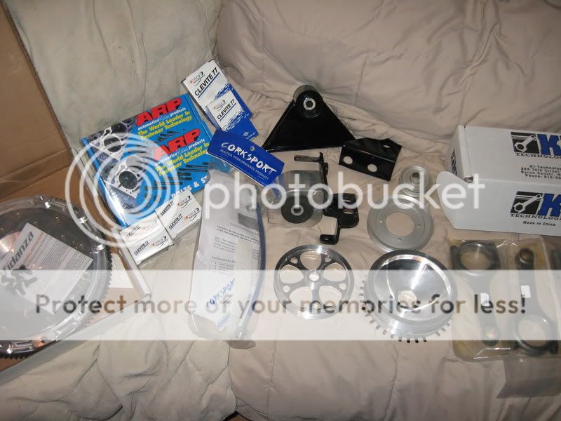

Parts

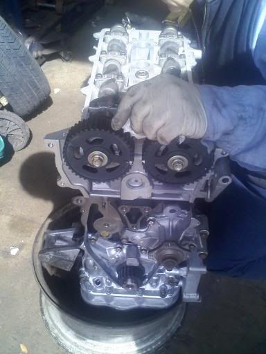

Motor comes back from the machine shop

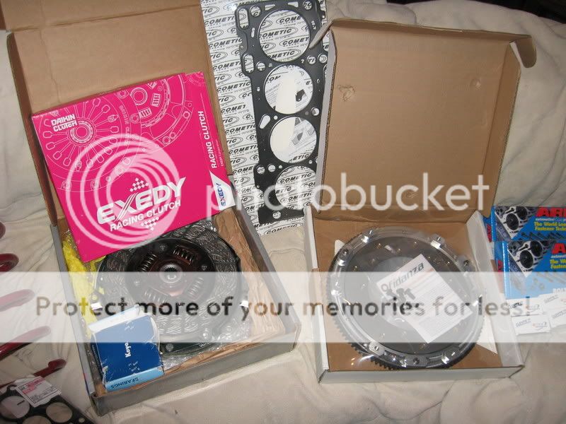

Exedy stage 1 clutch & Fidanza lightweight flywheel

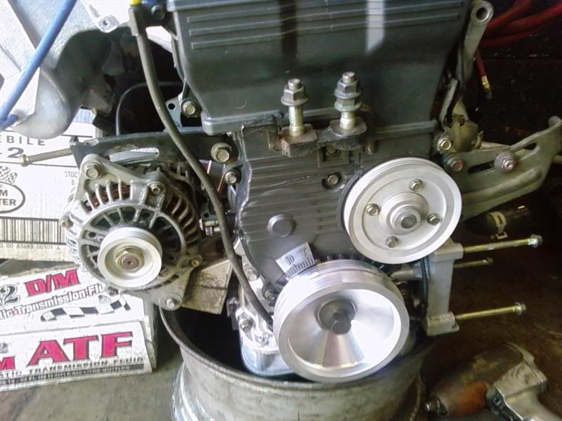

Medieval lightweight pulleys
Putting her back together begins…

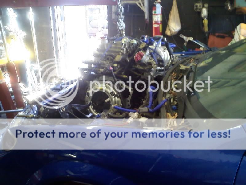

Motor goes up…
…then comes down

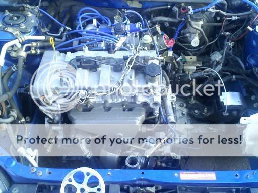

Motor back in with Steedspeed turbo manifold, Street Unit transmission mount & Medieval side engine mount

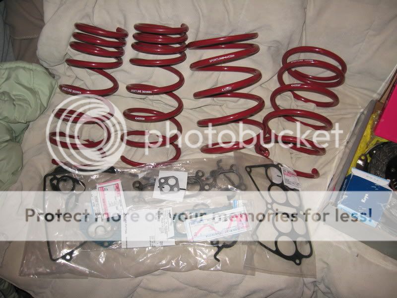

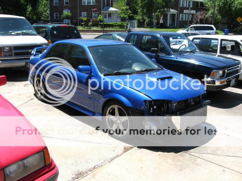

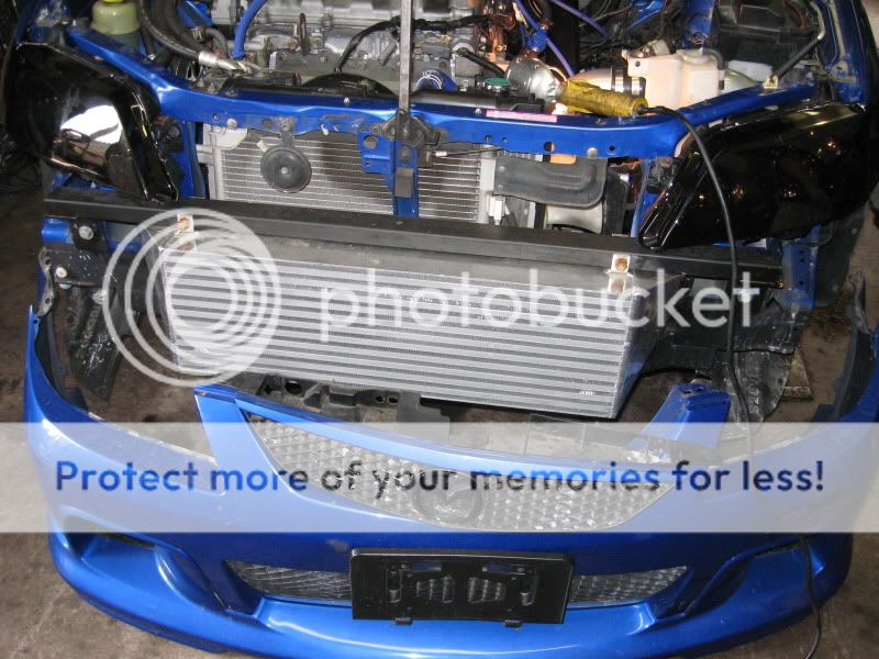

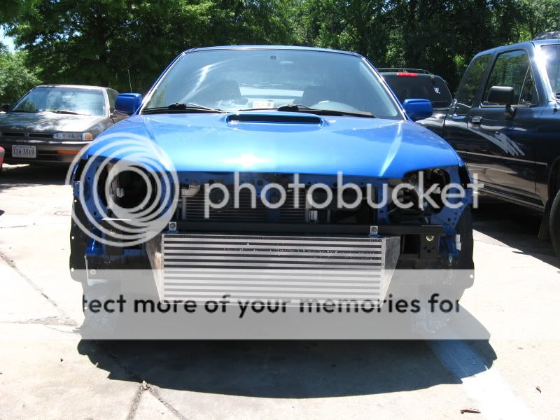

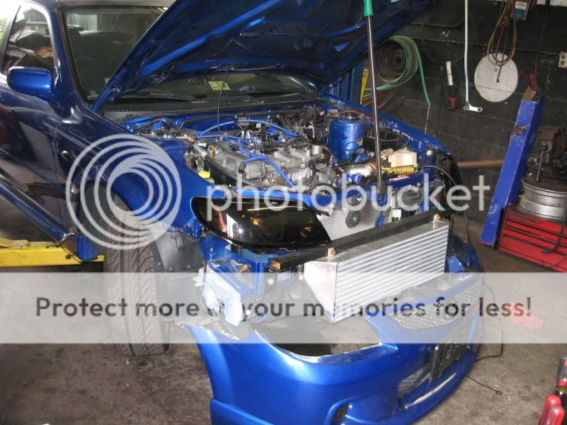

Turbolife FMIC, dropped on Eibach Sportlines, hood comes back from the paint shop & lights sent off to get tinted
Lights come back from getting tinted, vacuum lines hooked back up, Xcelerated Concepts trunk painted
