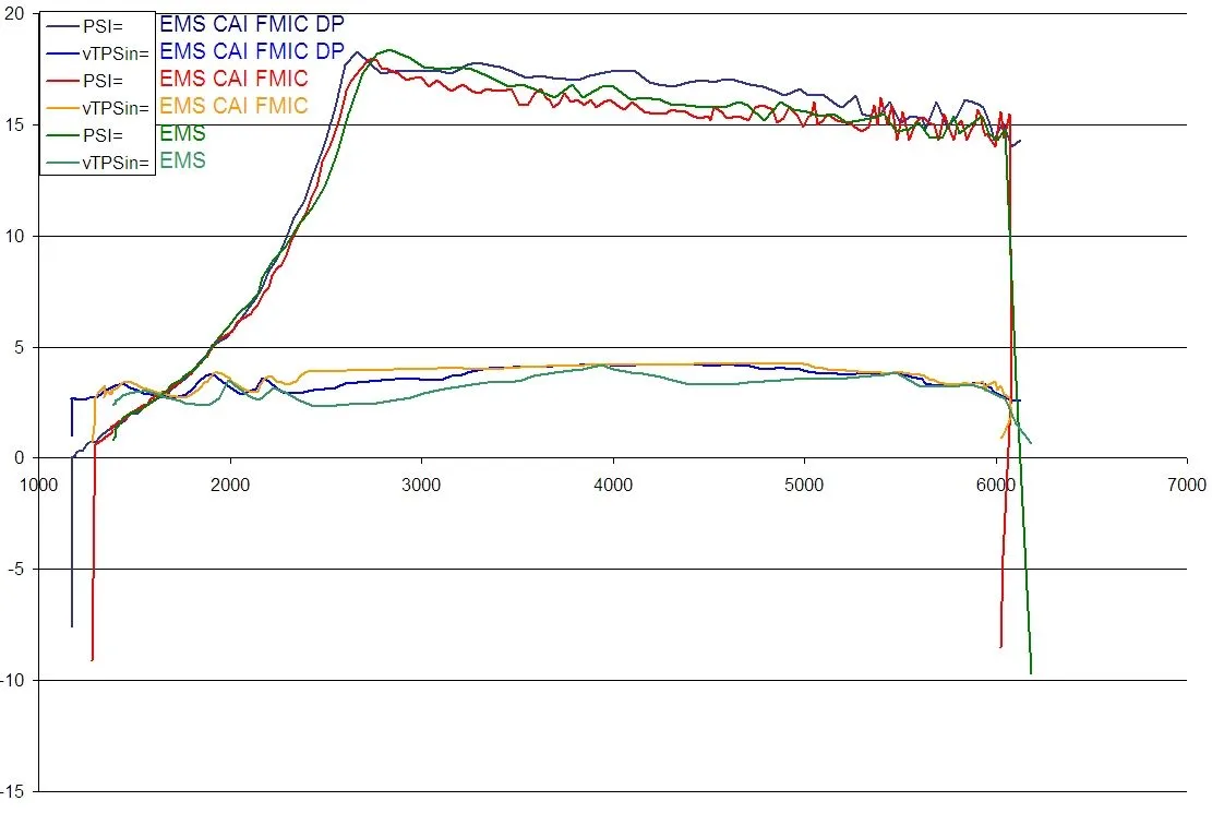

Why not a front mount?
The stock air vents direct air to the IC. Or were you talking about cooling the turbo? Just curious.

I dont like how the front mounts look on this car. If they took up the entire grill area it would look nice, but it doesnt look intimidating enough for me. The top mount will give better spool time (especially on the 3076r) and its easier to deal with then all the piping of the front mount. The TMIC will be fine especially with meth inj.
An opening in the hood would allow hot air rising to vent out of the hood instead of being trapped and heat soaking the intercooler. It would be a direct opening for more cool air to hit intercooler while driving.
I'm not so sure on the spool time...
