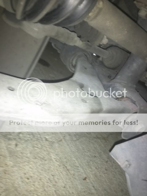

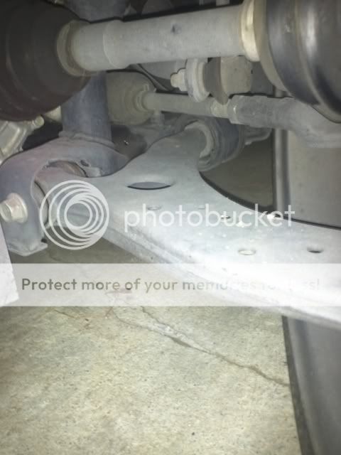

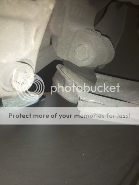

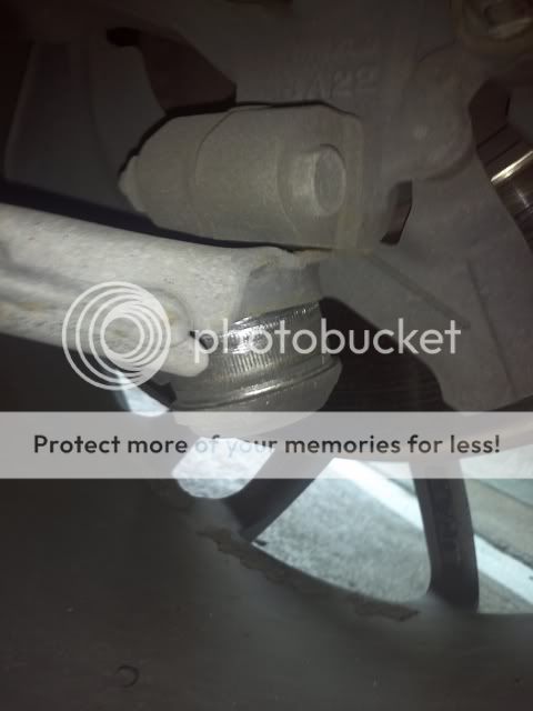

it looked like the ball closer to the wheel was coming off as i compared to the passenger side

from your pictures, it almost looks to me like both sides are shot? drivers side looks like the ball joint has slipped from the control arm, and passenger side looks like the control arm is bent?
