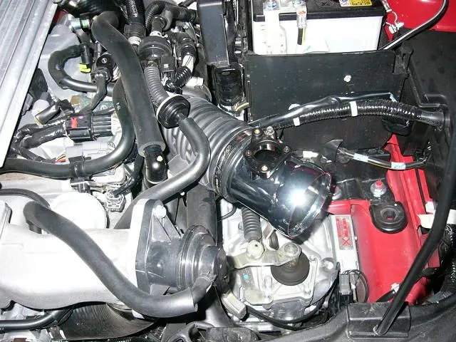

I got the spectre pipes because it was cheap and it is made specifically for custom intakes. The pipes are made of plastic (again, cheap) and have a chrome looking finish (see pic #1). The pipes and elbows are 3 in. diameter and have a plastic clamp in one of the side with hex screw, so you don't have to buy clamps, but be careful and don't over tight. I went out and bought the following:
2 4in. long straight pies
1 6in. long straight pipe
1 45 deg. elbow
1 90 deg. elbow
1 60 deg. elbow
1 maf sensor adapter
1 mounting kit
1 3in. cone filter
1 T clamp
Total price $90
Pic#1

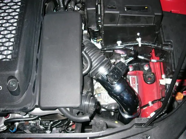

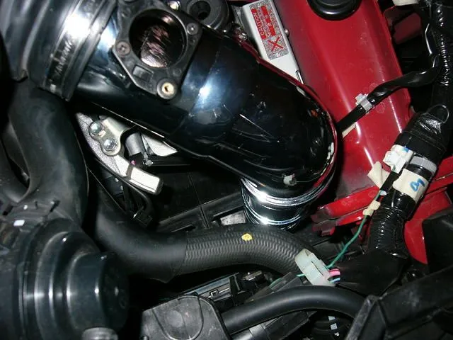

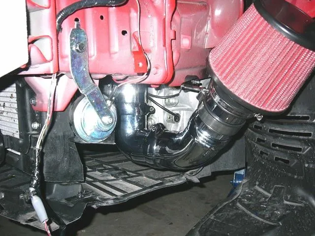

I figured what I needed by looking at pics of the ms and injen cai. I ended up using EVERYTHING. You can just get 3 4in. long pipes to make it shorter, but they only have two at my local store so I got the 6in. long pipe instead. I tried different layouts but pic #2 shows the final version that fitted right. Also, before you attach the pipes together, remember to put the O ring that come with each part to avoid air leaks.
Pic#2

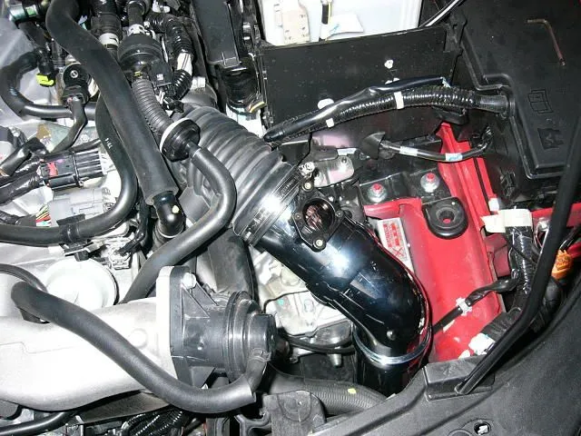

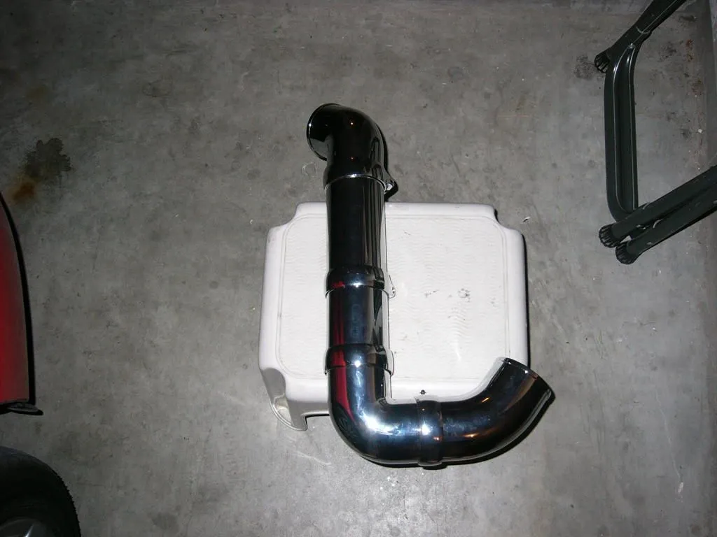

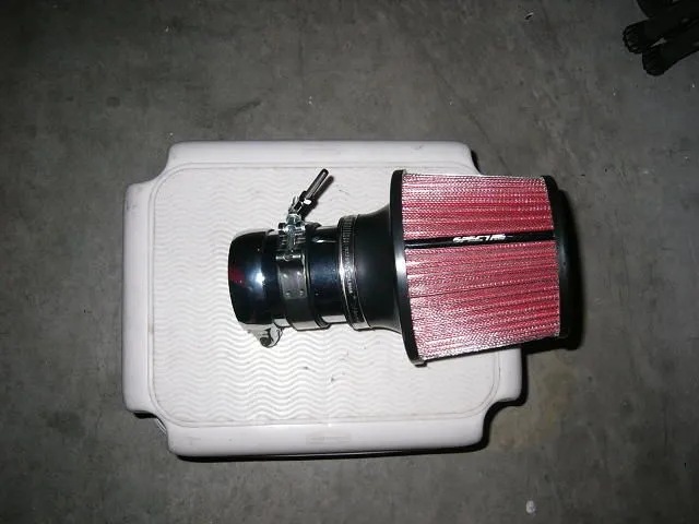

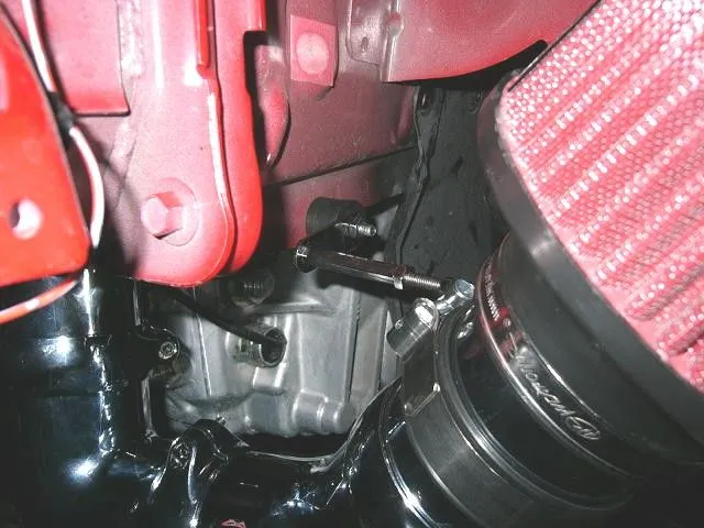

Attach the cone filter to one of the 4in. pipes and attach the T clamp in the middle of the 4in. pipe. You will use this T clamp to secure the intake after installation (pic #3). Now, you are keeping the corrugated looking hose. It is a lot easier, but if you want to remove it, you need to buy additional parts, and the point is to keep it cheap. The maf pipe comes with 3 adapters for different cars, just follow the instructions and use the one for mazda, and take notice of the direction of the air flow. Attach the maf pipe to the stock black hose (pic #4). I tried to use the stock clamp but didn't work, so I used a extra one that I had.
Pic #4

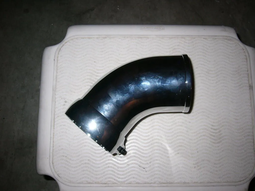

Start assembling the intake. Attach 4in. pipe to the 6in., then put 60 deg. elbow on top, 90 deg. elbow at the bottom and 45 deg. elbow to the 90 deg. (pic #2). Tighten enough to keep together but allow movement, and lower into position. Attach top part (60 deg. elbow) to the maf adapter and adjust as necessary (pic #5). It looks like there's no space but there is enough (pic #6).Attach cone filter to lower intake and adjust (pic #7). I also used a m6 vibra bolt (bolt with rubber) from my old maxima intake, but I don't know if one can buy it locally, so you have to find something for if you want to isolate vibrations on the intake.
Pic #5
Finally use the parts in the mounting kit to secure the intake (pic #8). There are 3 different size metal rods, I used the medium size and attached the other nuts and little plate to make some kind of bracket, very easy stuff (see pic #8 again). If you adjusted everything right, the intake will not rub against or hit anything. Tighten everything and double check, replace bumper, install maf sensor and connect battery. Start engine and listen for air leaks. Finished installation (pic #9)
