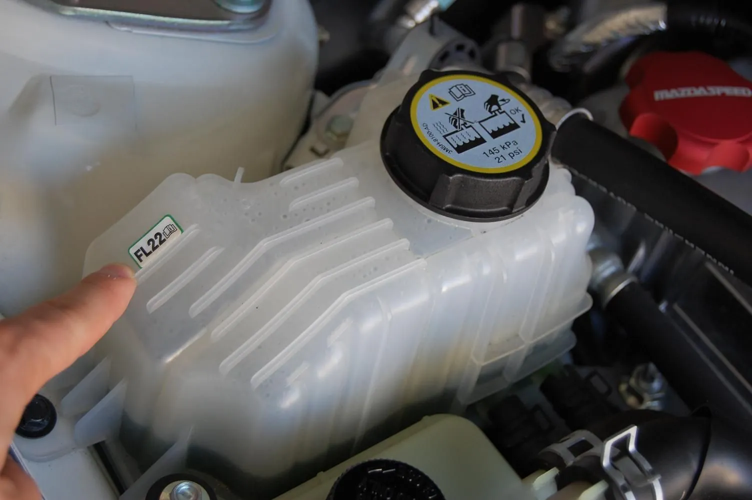

It is a small sticker if I remember correctly. I was wondering what was in the car myself a few weeks back and I just happened to see the little "FL22" sticker on the resevoir. I'll take a pic later.
Took a pic showing the FL22 sticker on my resevoir. I can see this sticker having the potential of falling off. I can't find a radiator cap in this car. Anyone know where the darn thing is? Guess I should read the manual, but since I won't really be touching the radiator for another 114,000 miles, I'm too lazy. (crazy)
Thanks for the pic, FF. I definitely don't have that sticker on my overflow reservoir - nor is it anywhere to be found in the engine bay. Hmmm...I'm hoping I have the FL22 stuff. I sent an email to Mazda USA telling them I have an '08 MS3 and asking if these were equipped with FL22.
Found the Service Bulletin for it here. My VIN is doesn't fall under the bulletin so that's why I don't have it. Mystery solved. Bummer. I wonder how much extra it is to have my local dealer put this stuff in. I'm assuming your VIN is greater than what the bulletin states then Frequent Flyer.
