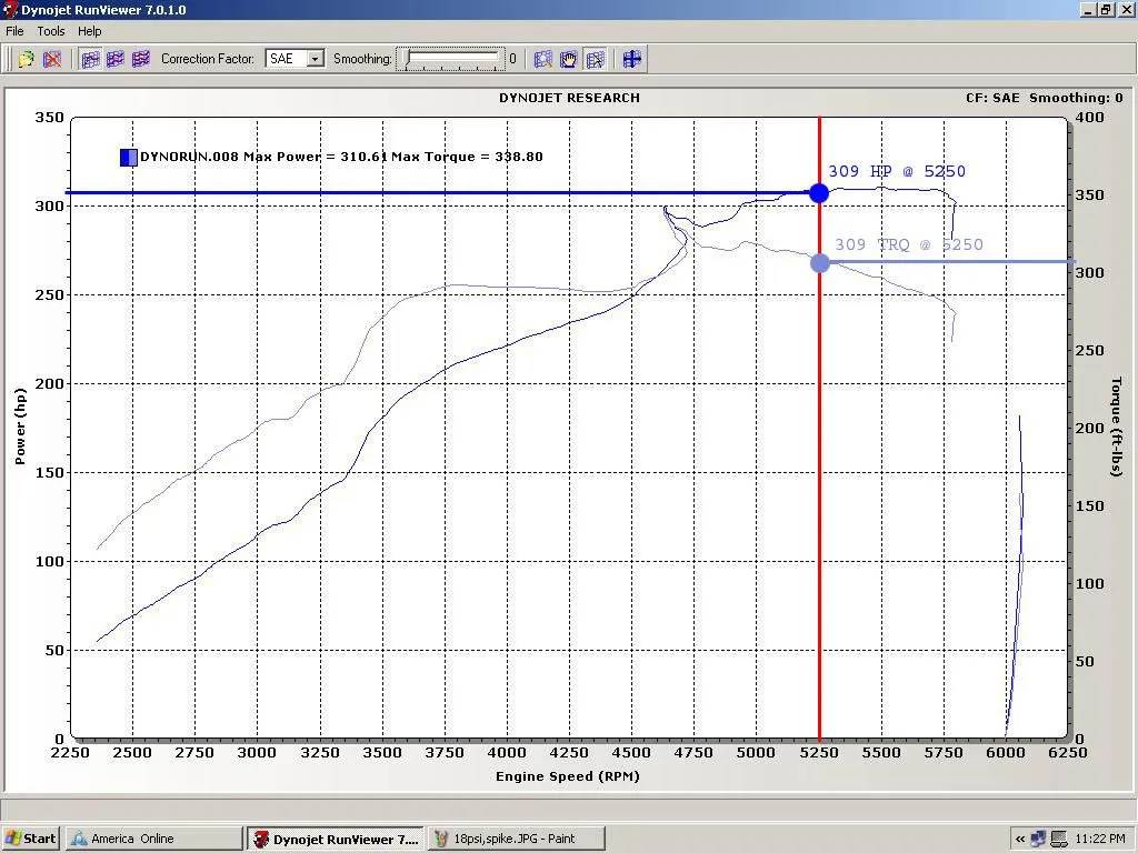

Those graphs are OFF Scale because our torque GOES SO HIGH that the scale needs to be adjusted to keep it IN THE GRAPH near the HP. Thats it...like this:
HP ------------- TQ
300 ------------ 325
250 ------------ 275
200 ------------ 225
You people need to learn how to read graphs... here's one to help you guys out. And the HP and torque does cross at 5250 rpms.

igdrasil said:
Damn, those are really impressive numbers. Congrats.
And for the people thats still concerned about the "crossing lines" of Torque and HP.
THEY WILL ONLY CROSS IFFFFFFFFFFFFFF BOTH are measured in the same scale!!!!!!!!!!!
Sorry dude, that is wrong.
Like people mentioned, horsepower and torque are related by an equation, where the conversion factor is 5250. It has nothing to do with scales.
