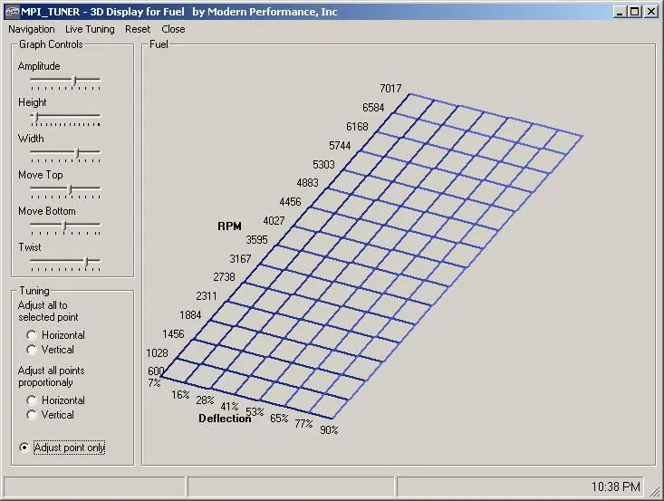

well do u have pricing on ur unit for msp owners?? also does ur programin software offer 3d maping? or only that 2d style table maping?
The cost is $675.00, the end of the year sale is going until this Sunday. The sale price is $575.00
Yes we have 3D mapping. Here is the screen shot.
Please let me know if you have any questions at all.
Thanks again
Later.....Nick
