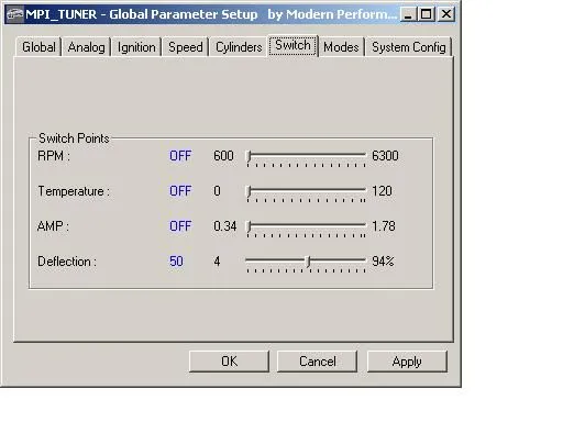

Is it an electronic solenoid(sp), that works the bleeder valve... How does it get triggered to allow for more boost? Also would this map switch you are talking about, is it an actual switch or just a button on the laptop?
For your set up it would be a bleeder. Here is a screen sot of the switch setup table. Please keep the questions coming.
