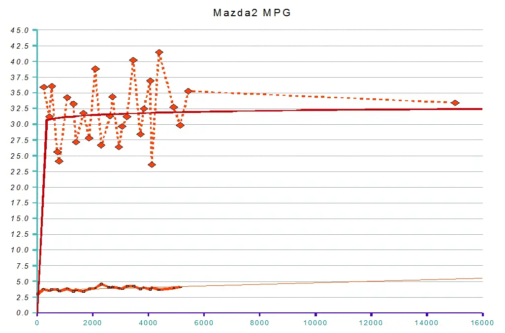

My MPG and PPG
Here is my life-to-date mpg and ppg:
39.5 first tank, 35.5 2nd tank (was letting people test drive it)
