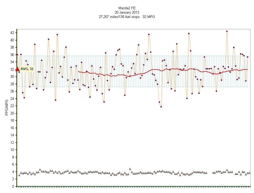

Update: >25,000 miles average 32 mpg including some autocross/track days. My car gets flogged regularly. Highest is 42 mpg. I shift high up on the RPM and enjoy the VVT kicking in. Fun car.

Update: 32 MPG
What do you think?
This includes a few Autocross events. I do not hypermile (spelling?). I shift at redline quite often. The low numbers are due to heavy city driving and short trips (<5 miles). This is much better than my DGF's 1989 Civic Si. I bet that if we got rid of Ethanol we could be in the 45mpg zone much easier.

What do you think?
