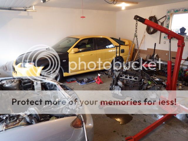

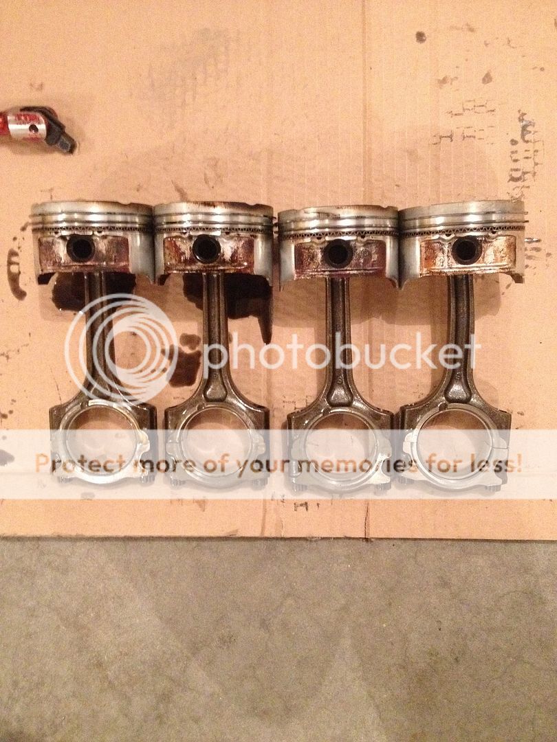

I really have no idea how this rod bent. I drove the car home approx 15 miles, with no issues, no smoke, only thing was the boost cut at 3500rpms. but no knocks, ticks anything. we have the day off tomorrow, so i will get a case of beer and hammer down. I will take photos and let you all know how she go.

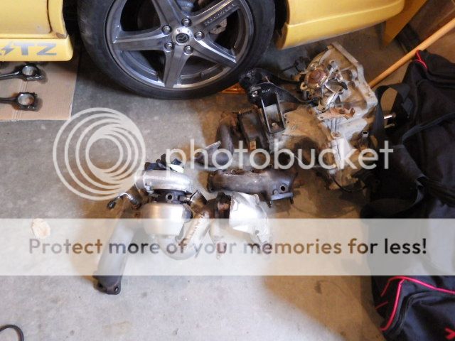

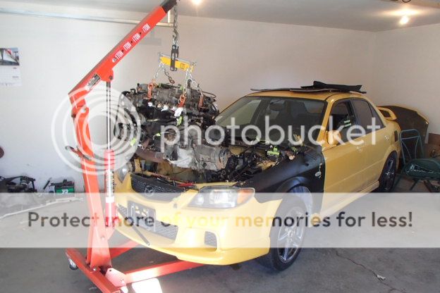

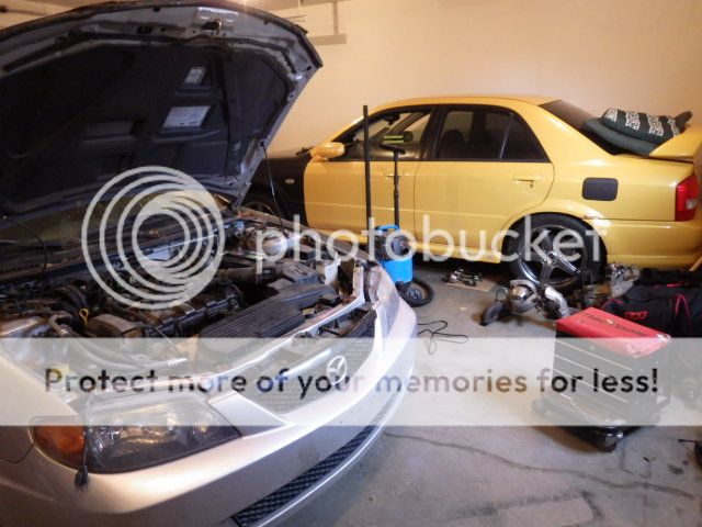

im getting better the second time around. had this motor/trans pulled out in 2 1/2 hours. didnt even slam a beer either. the third pic you see is an extra turbo assy i picked up locally. tonight i will transfer over all parts required and drop this bad boy in, and make sure everything will be hunky dory.
